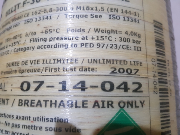

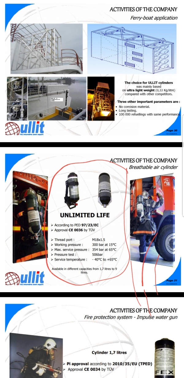

Unlimited life Carbon fibre cylinder

I have read thru the links you posted and I was aware of a few of those failures. I was wondering if anyone knows of the modern carbon fiber tanks failing, The links you posted are in reference to Aluminum scuba tanks that are known to be faulty do to the AL composition on some tanks manufactured in the late 80's early 90's, I happen to own one of these and no longer use it. The scba tanks mentioned were 3126psi cylinders that were made with some sort of plastic and fiberglass reinforcement and should be well out of date and retired by now. Thank you for your research and making me aware of this thread.
