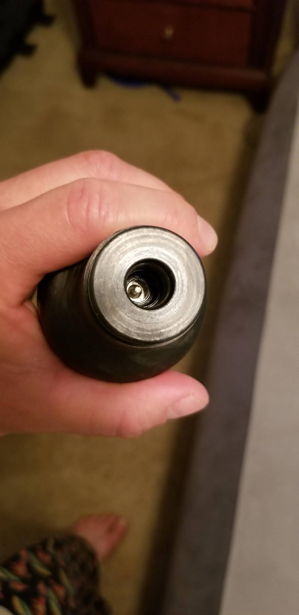

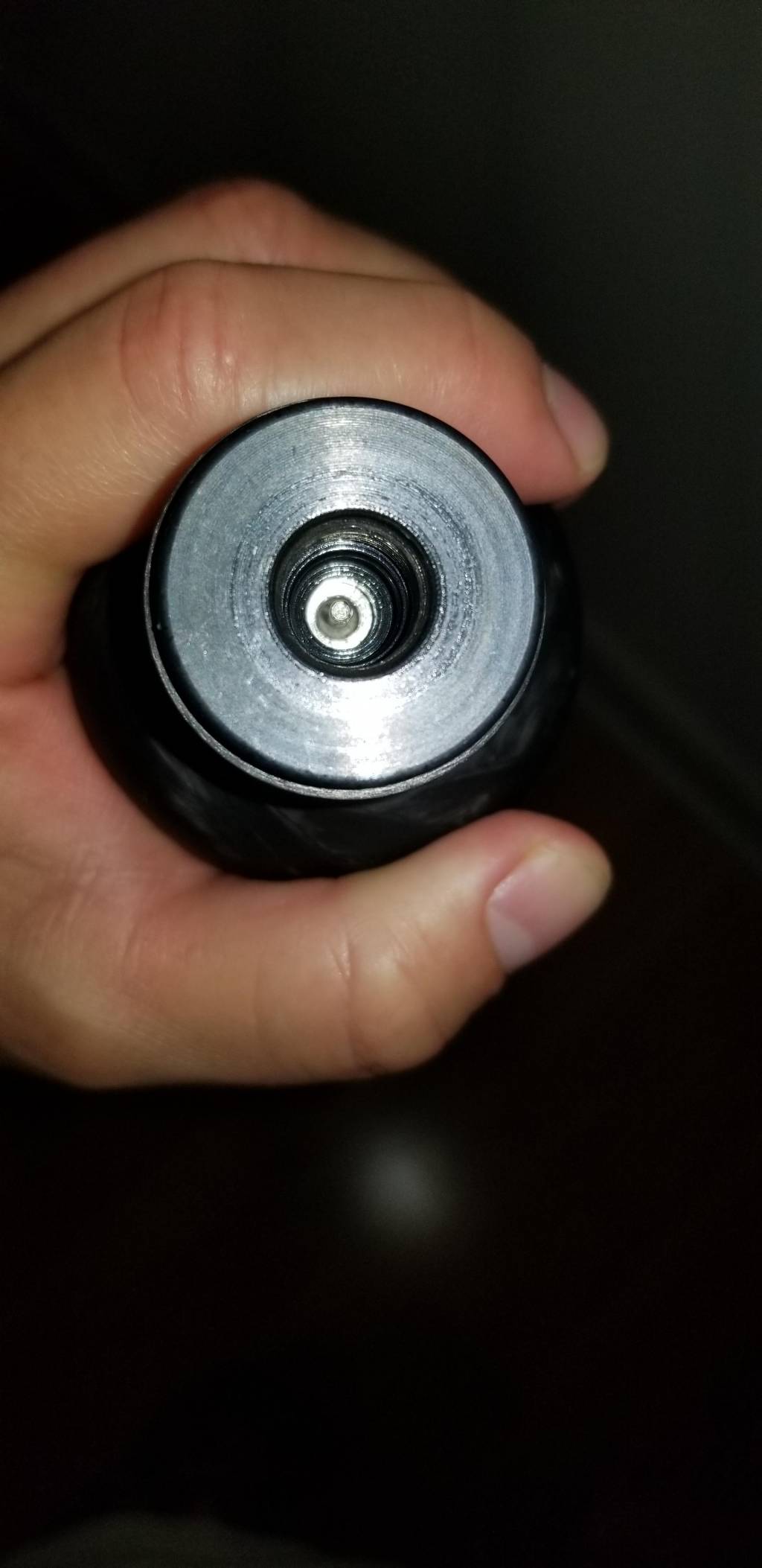

I'm a first time PCP owner, and recently acquired an FX Impact MKII. Today I tried to fill my tank up for the first time, and was not successful. The issue seems to be that my tank (480 cc, carbon fiber construction) does not hold air by itself. The first indication that something was amiss was when I was unscrewing my tank from the gun, and l the pressure in the tank bled off. When I connected the 480 cc tank to my compressor via the Huma-Air adapter the manometer read 0 Bar. There was 100 Bar in the tank when it was connected to the gun.
I refilled the tank to 230 Bar, and when I went to bleed the line the entire contents of the tank bled out. I could tell because the body of the tank became cold to the touch. Not only that but when I disconnected the bottle it was still bleeding residual air pressure. My understanding is that the bottles are supposed to have valves that prevent air escaping. Am I missing something here?

Can you show us a couple of up close pictures of the bottle/valve area while disconnected from the air gun please? Yes, it does sound like the tank’s check valve. The reason I was asking for a picture is because sometimes if the bottle is attached to the gun very tightly, when you unscrew it, you can loosen the valve from the bottle just a little bit but enough to cause your type of problem. Although very rare, I have seen it happen more than once. Other than that or a bad tank valve, I don’t know.
Good luck and Happy New Year. Stoti

stoti: Here the pictures you requested.
