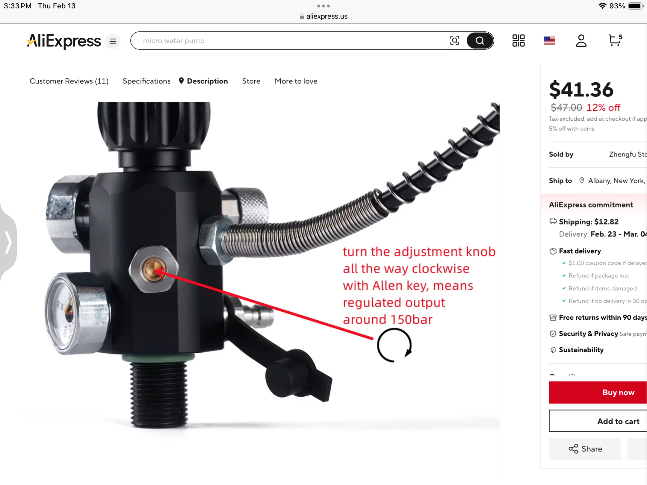

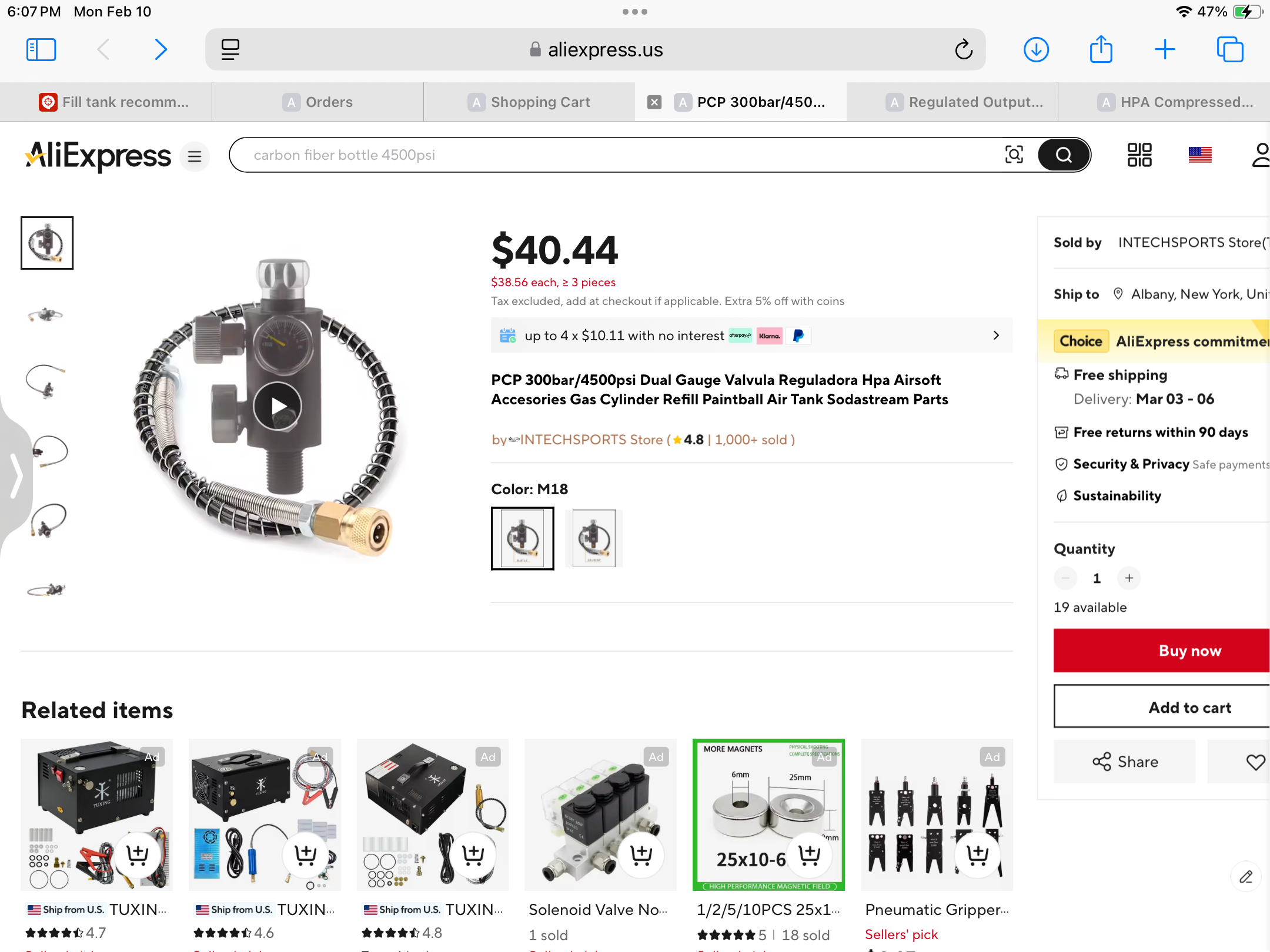

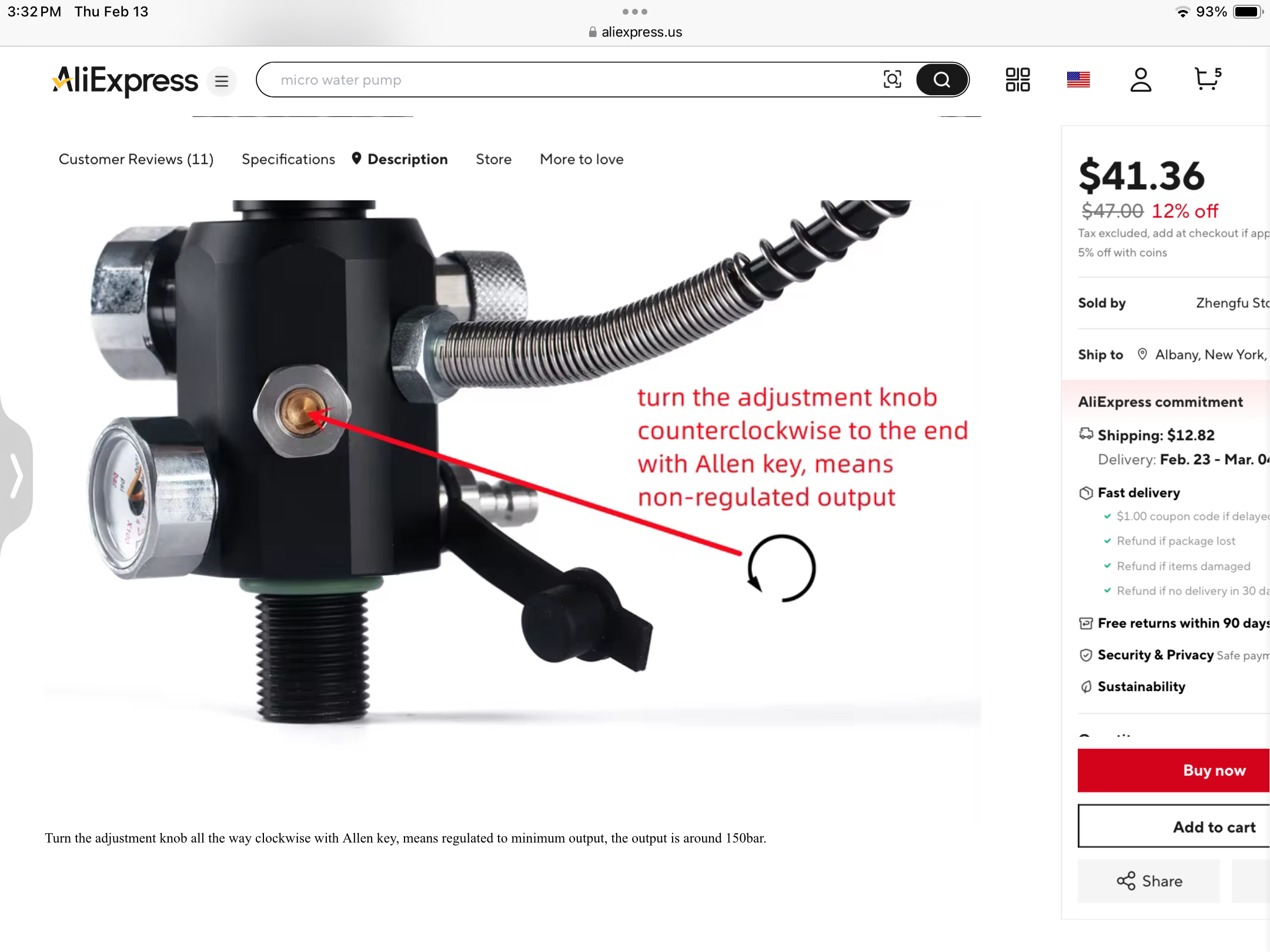

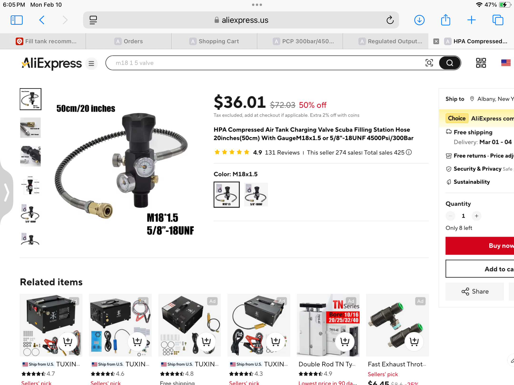

You can get far cheaper options.
for example I have these
Those are NOT regulators they are on off valve with no real control of the air, they will just feed tank pressure to the output
Elwood is correct those are just valves to open and close they are not regulators
50% right . The top one was ordered in error. The bottom picture at a price of $36.01 is a regulator. I was wondering why I had 2
