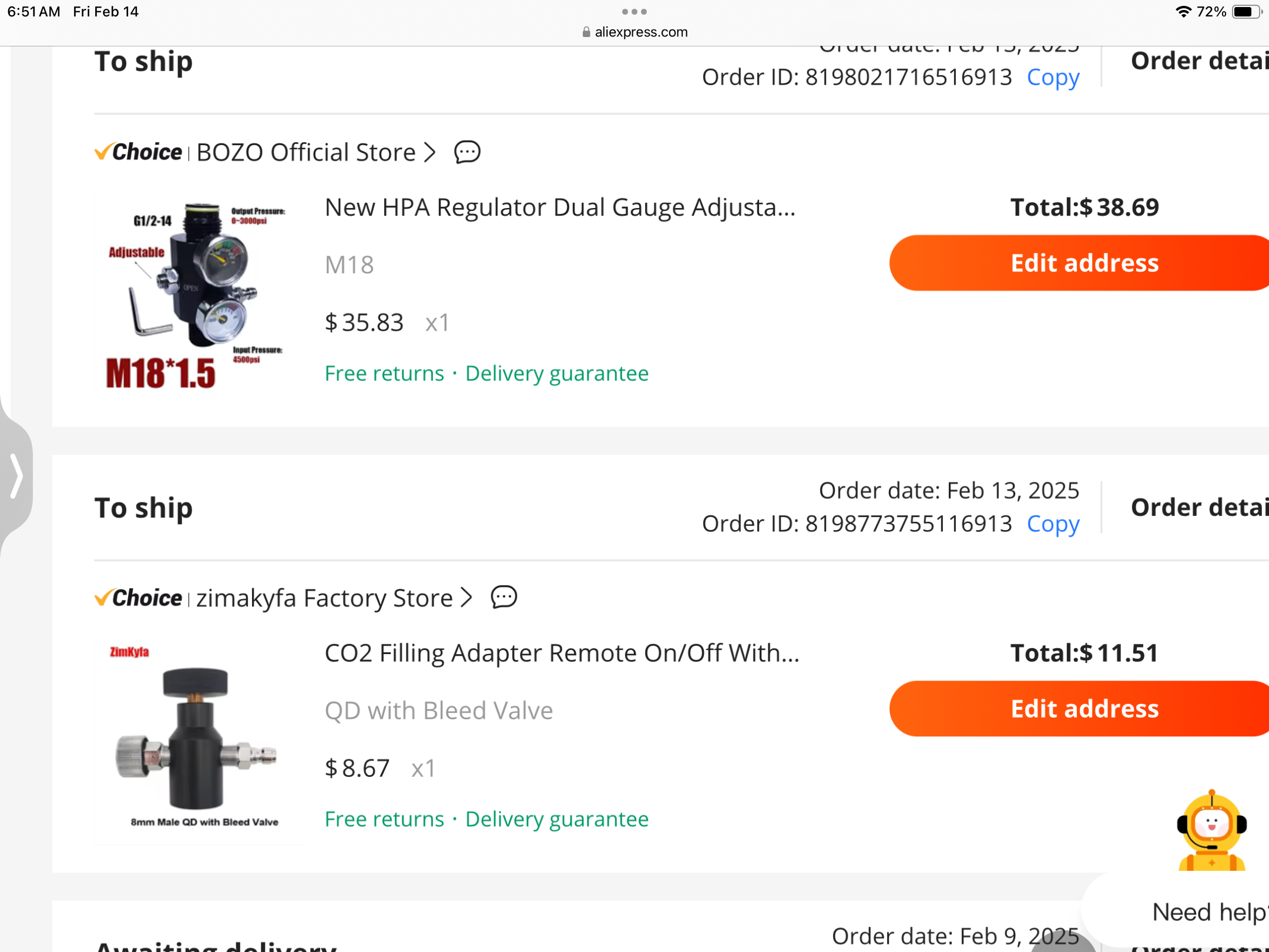

Matt, Thats one I hooked up yesterday and ordered this setup to try

I've done that too. I've stacked a fill valve on top of a gun reg. Those work but the AliExpress regulated valve is better.
Easy to adjust, 4mm hex
Stable, does not appear to drift.
No stack of 2 or more parts.
Since I have them on 3L tanks they are not the most stable platform. Easy to knock over. Stacked made me nervous, that it would break off if the tank fell over.

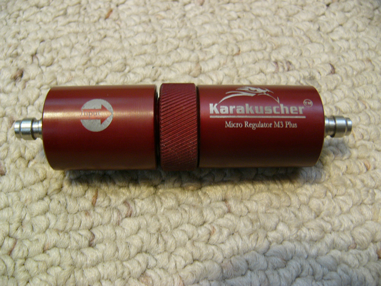

I bought this inline regulator, as featured in HardAir Magazine: https://hardairmagazine.com/news/interesting-external-pcp-regulator/
I can't find a US based vendor, but there were none when I bought it directly from Ercan - his contact info is at the end of the linked article. I have had great results with the regulator he sold me - it is not externally adjustable, but it is very easy to adjust when not under pressure. It was a very affordable option that allowed me to stick with the tanks and valves I already had but to tether regulated when I want to do so.
If interested, you could reach out to him - he is located in Turkey, and while his English is not perfect, it is far better than my Turkish ;). We were able to communicate with minimal issues and complete the transaction. I paid him through Western Union and he shipped it promptly - and I am very happy with the results. I have no affiliation with him other than being a satisfied customer. This was in 2022.
Do know that the regulator - at least at the design level from when I purchased it about a year ago - did not have vent capability, so that needs to be provided. The video shows it with DIN fittings, but I ordered mine with foster fittings on both ends, as seen in the picture below. To adjust it, I simply unscrew the "cap" with the foster fitting on the left and then I have access to the adjustment screw just like in the video (the cap is basically an adapter to the DIN threads on the body of the regulator. I think it is a great bit of kit - just be sure you have a way to vent it (maybe he has one with a vent now).

OK. After posting, I had a bit of an "ah-ha" moment and realized I could simply screw mine into my JoeB guppy as it has a DIN G5/8 output on it once I take that "cap" off of of the regulator . . . . so I think that could be awesome!
Anyways, I sent Ercan an e-mail asking if it would be safe to use it that way without a vent after the regulator (I doubt it), and also to ask if he has anyway to sell them here in the USA now. I do think it is a great unit, so hopefully he will have a good answer on that. His website looks like they are still in operation, so we will see. I'll update with any feedback I get . . .

I was reluctant to post it without being asked because I got it back in 2022 before inflation went nuts . . . I paid $140 for mine, but I expect they will be a good bit more now. That price was direct from him, but who knows what it would have been if I had to go through a normal retailer - given that the "competition" is so much higher, I think the price would have been higher. I recall once seeing one place online that IIRC was selling them (after I got mine) for over $300 a few years back, but that company is now out of business as the link I kept for it was dead (and thus was deleted a while ago).
@blackdog899 , @SpindleB and others . . .
I heard back from Ercan, and he would love to have a US distributor but does not currently have one. In the mean time, he is happy to sell directly to anyone here that wants one of his regulators, and he told me to post that he will sell them for $150 shipped. His email is [email protected]. He said they will take about 8-10 days to arrive, but I'll add that the actual arrival will depend on how fast customs processes them - mine had a delay there a few years back.
I did not ask about payments, but I had to use Western Union back when I bought mine.
This is for the regulator in the Hard Air Magazine article: https://hardairmagazine.com/news/interesting-external-pcp-regulator/
If you want one it would be good to get one before any tariffs get put in place, as that will not only make things more expensive - it will slow things down a lot (as the direct importer, customs will need to collect the funds from the buyer).
Again, I have no relationship with Ercan other than being a happy customer . . . .
By the way, he also told me that the regulator does not have to be exclusively vented from the output side. It can be vented from the input side without damage, however the venting will be really slow - like about 15 seconds just to vent the line. So while it is good to know that we can't damage the regulator if we accidentally do that, it is not very practical as many guns won't have their foster fittings seal up with that slow a vent rate (and thus it could end up draining the gun reservoir).
