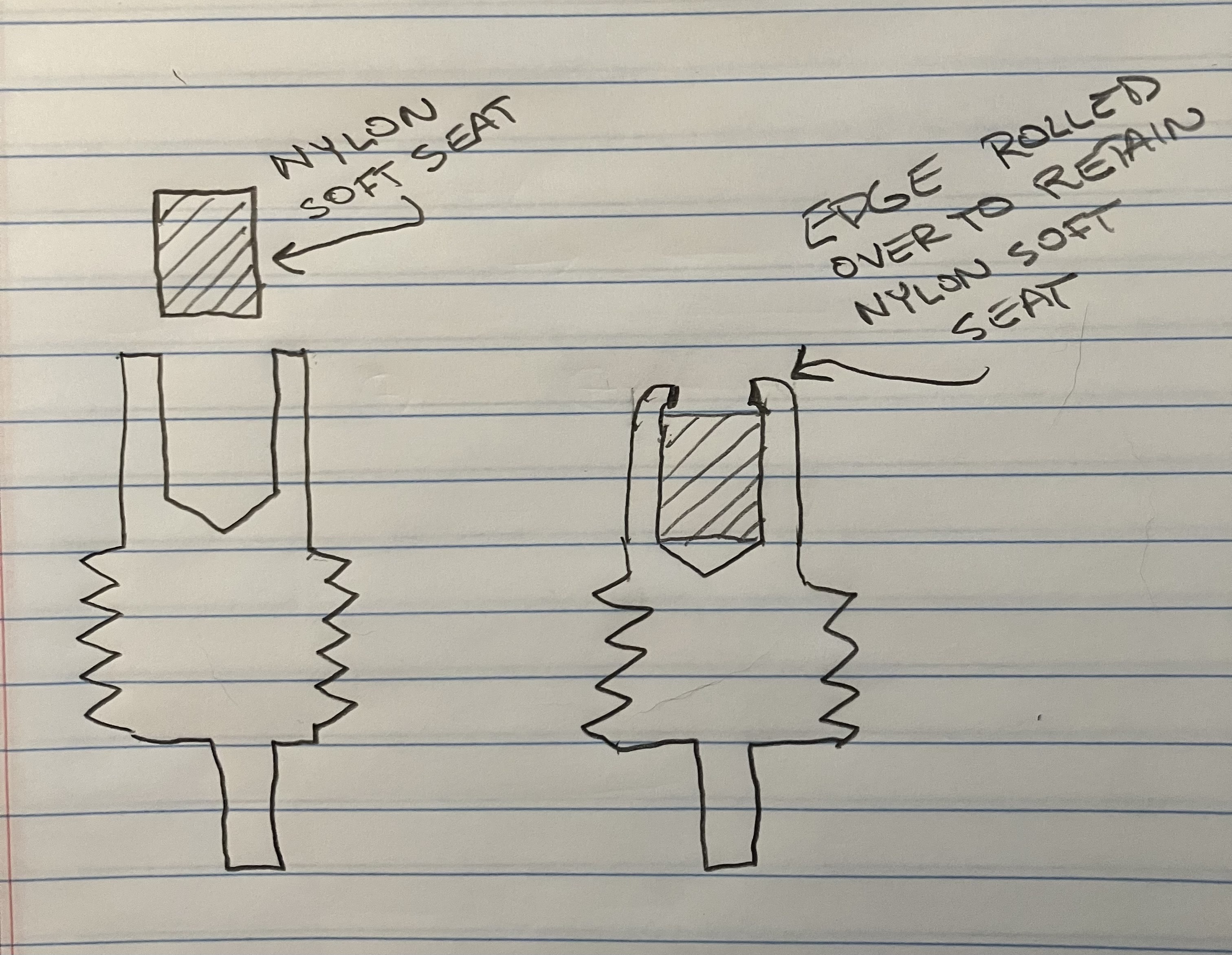

OK. Now with @rcs9250 's comment about the hard brass collar possibly bottoming out, I have another new hair brained idea - sand down the full base of the part to get more engagement wht a little more turn of the knob . . .
If the brass does extend past the plastic (like in rcs9250's illustration, it would be pretty easy to do a flat sanding approach, but if the plastic is flush it would be hard to do that without embedding swarf in the plastic - that would probably call for sanding the brass on an angle to keep the plastic from contacting the paper (or file, if you go that route) too.
Of course once done, you could then apply a little heat to the plastic to smooth it out too . . . ;)
But I do hope you find a new part at a reasonable price!

Yep, that’s something that might work. File the brass carefully so that the roll crimp is removed. I don’t think it’s possible for air to get under the nylon insert (area A in photo) and pneumatically eject the insert but you could always cross drill at the point shown at the lower short arrow and install a roll pin and file ends of roll pin flush with brass OD.
Another thing to do before filing off roll crimp that could verify if the brass roll crimp is contacting the valve body is to get a Sharpie®️ and make a black ring as shown in red on second photo, then assemble valve, crank the valve closed like you normally would and then disassemble and see if the Sharpie®️ transferred onto valve body and has rubbed off of roll crimp.

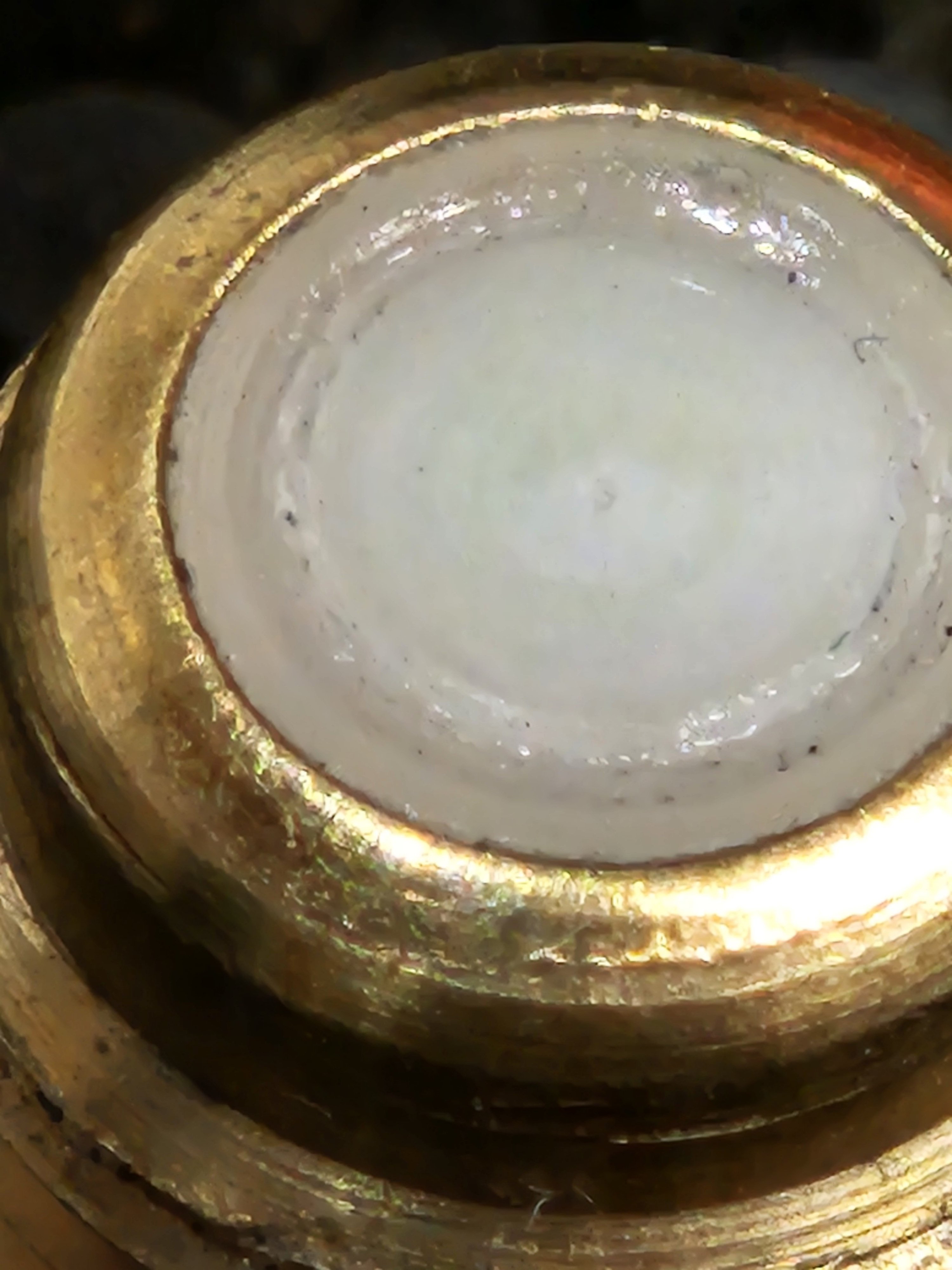

A few pics of my valve repair from 2020 on my Drager scba valve that had ~10 years of service with the Phoenix Fire Department before I got it. In the one pic that shows both the new and old nylon seat you can really see what ten years of firefighters cranking the valve shut does to the nylon. Fortunately the hard seat was fine and the new parts fixed the leak.

Yeah, that's quite an owie on the nylon seat! Mine isn't that bad yet as I CAN tighten it up enough to stop the leak, but that is NOT the fix and it'll get nothing but worse,,,,and SOON!

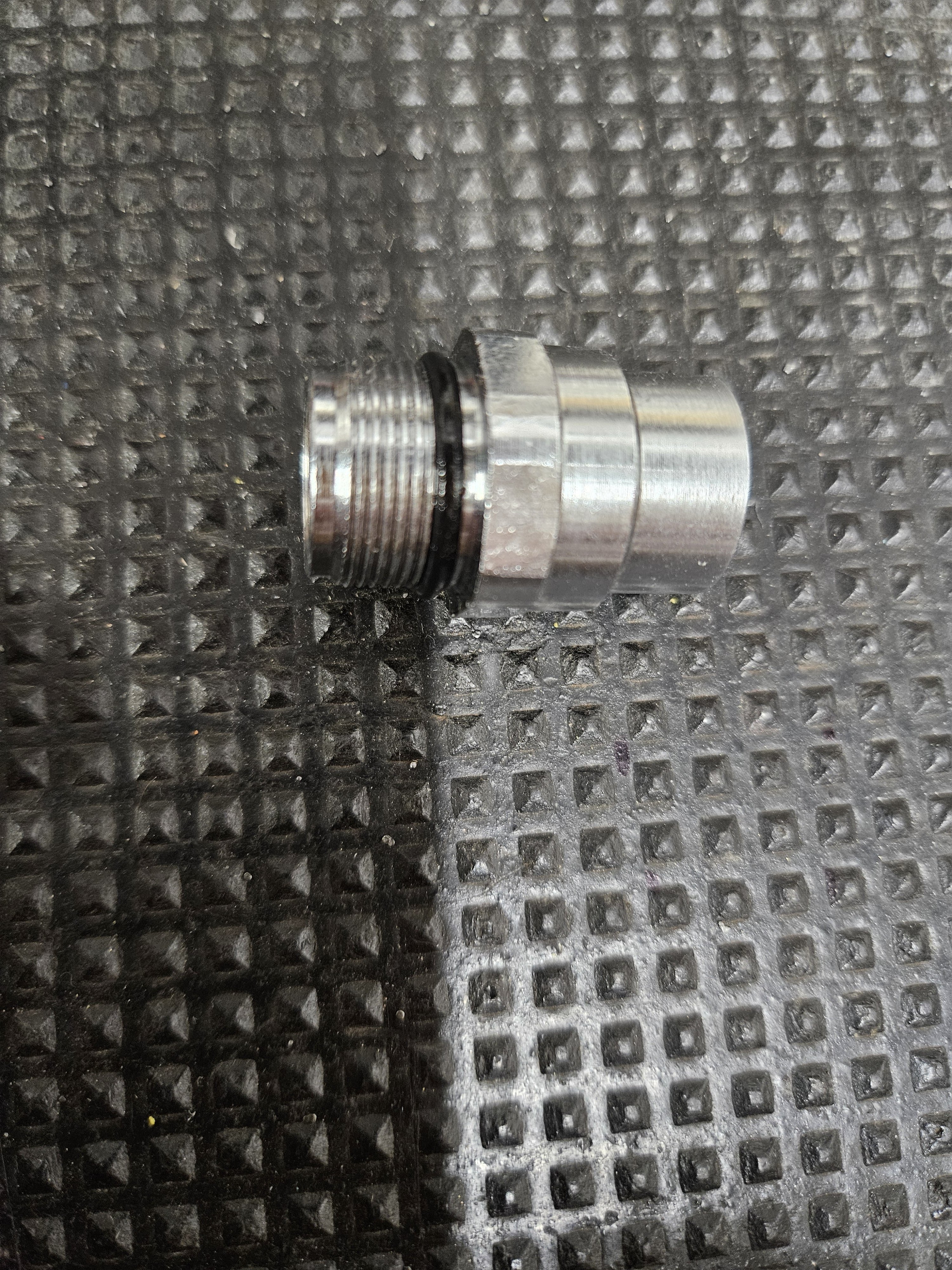

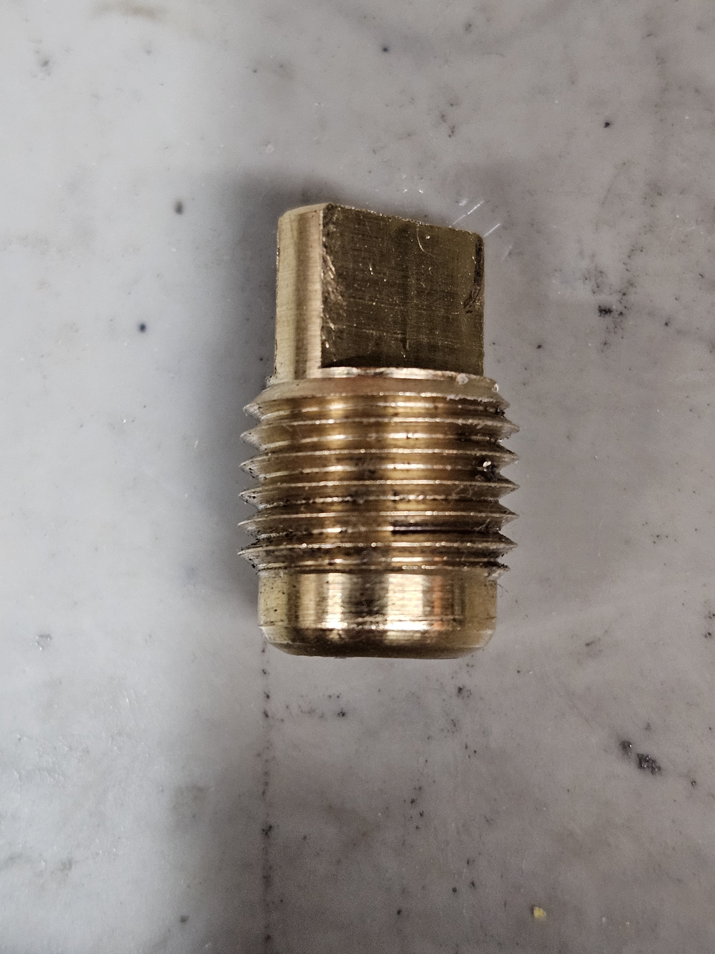

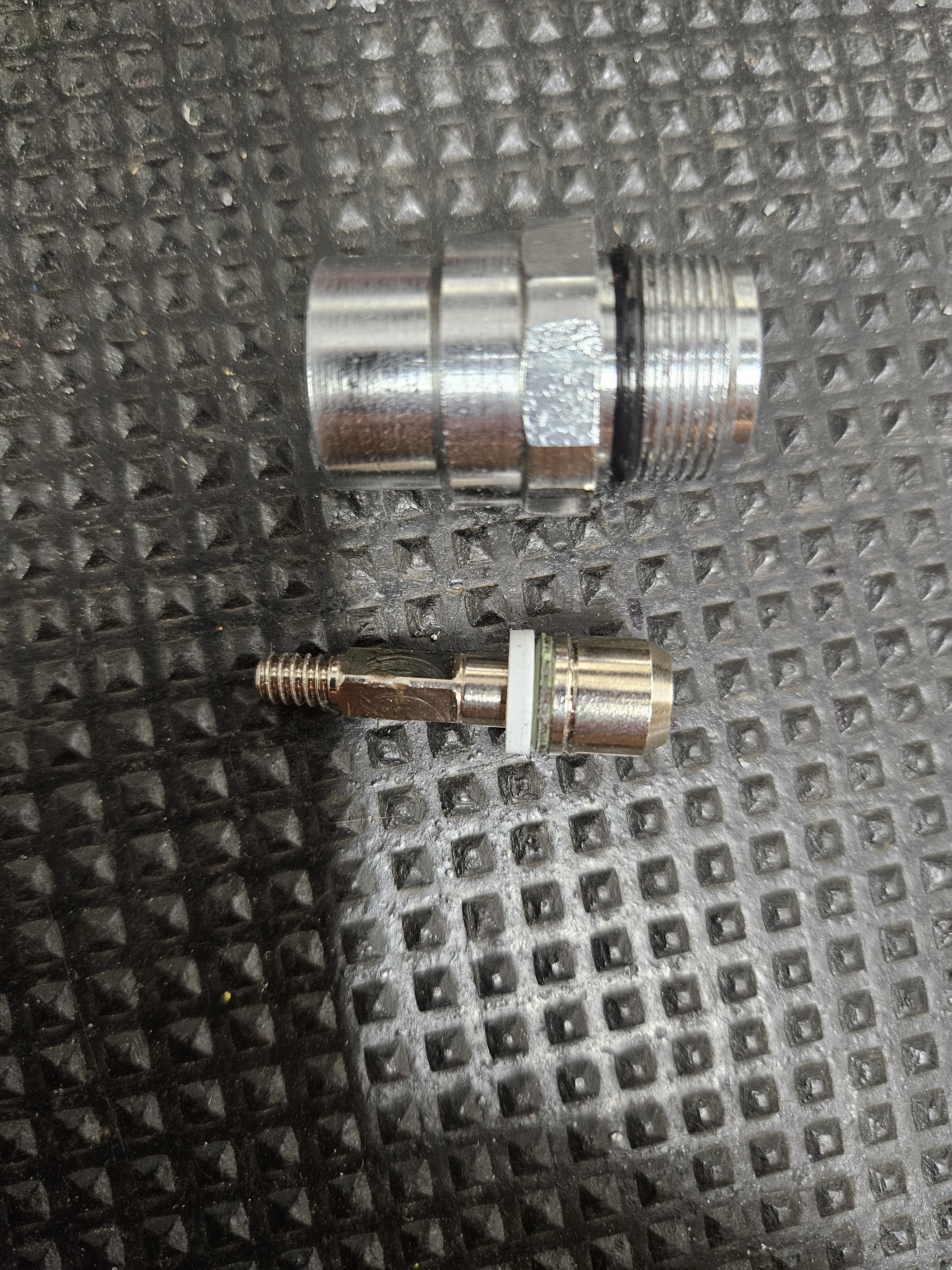

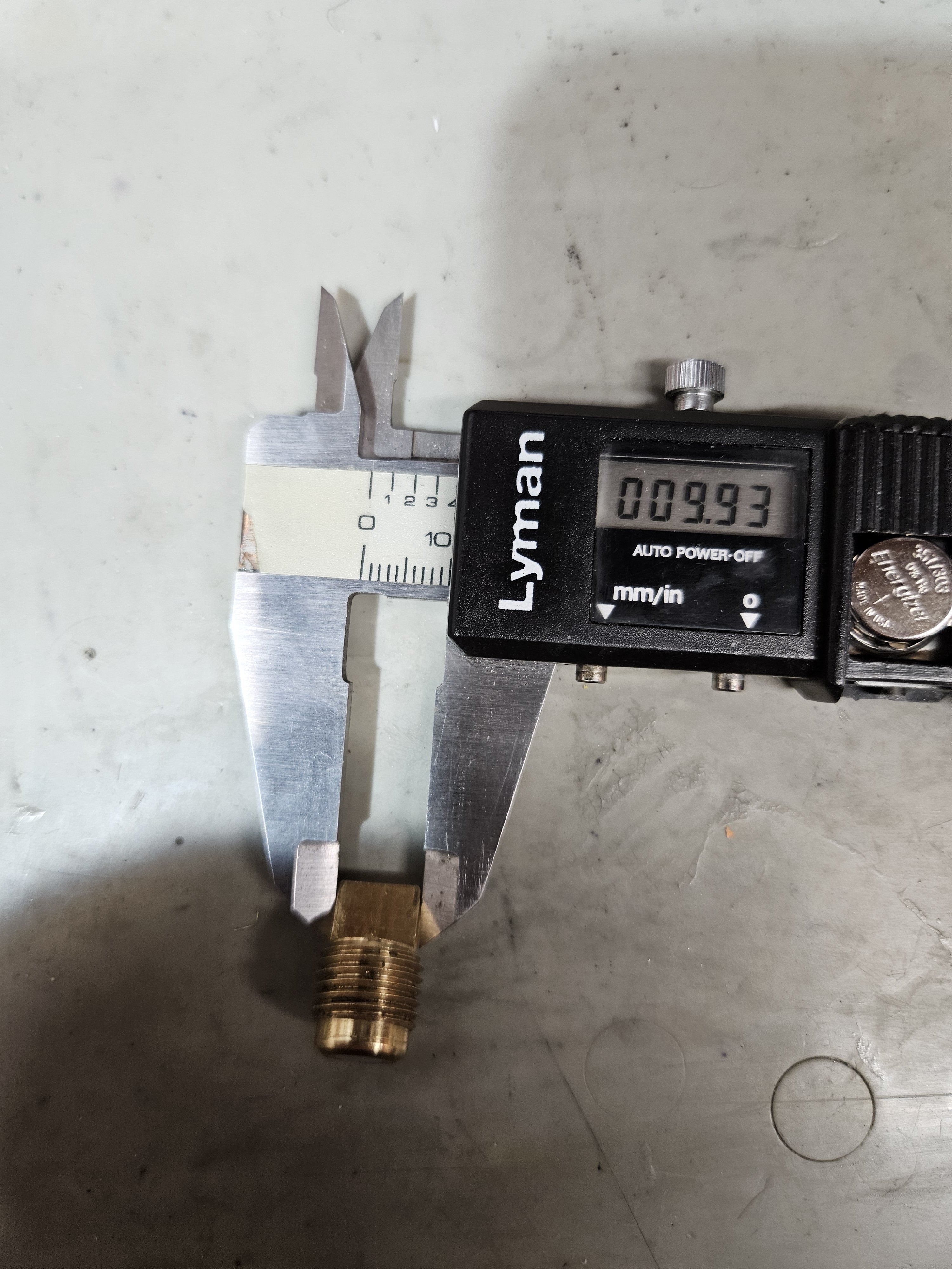

So you guys know how this thing is put together and how it was repaired.
Made up a split sleeve so I wouldn't crush the threads on the valve.
Chuck it up and indicate in.
Cautiously bore out the nylon seal. And yes those are threads in there. Get the bore close to the thread diameter amd you can unwind the threads.
Yup that's the boring bar
That's the first plug, ended up making a second one because of the thread.
Seal installed and bonded. Back into the lathe.
Brought the oal in. Return to Revoman 🙃
I cannot thank Mike enough for his kindness and efforts to get that valve stop repaired, and in record time!
