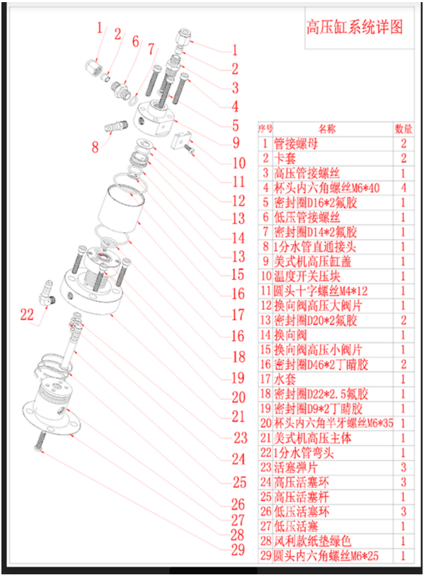

Well, not really that easy, I believe the screw that holds the small high pressure piston in place has to be removed from the inside of the larger piston, part number 29 which you can only access by removing the front cover off the crank housing yadayada....
BTW Doc, I have a lot of photos on how to replace the seals and other schematics as well.
