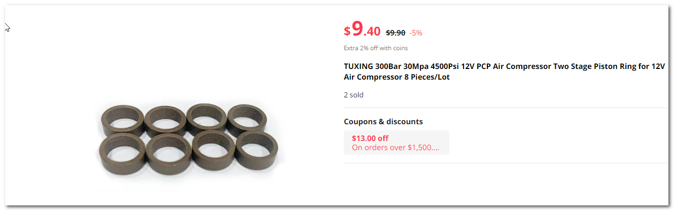

Tired of paying the outrageous price to PA for the high-pressure seals, I tried these and sure enough they do work. A little tighter fit when sliding the cylinder over the piston. Initially it did get a little warmer, quicker. I haven't used it since, but I feel like they just need to size themselves for a while to the cylinder bore. As far as the tool that PA sells it is nice since it has the cone shaped seal spreader and then it comes with a sizer to squeeze the new seals back into the grooves of the piston.
Have you tested these yet?
Just that one time, haven't needed to make any air in a while. I'd go ahead and get some and see what ya think. Nothing to lose really. Just make sure they are not the ones that have the split. I've tried them before with no luck.

I will have to order some and see how they standup. Need to find a place to get some more O-rings and air filter too
