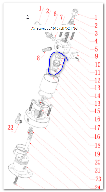

Just ordered the tuxing high pressure seals after mangling 3 from pyramid. Air Venturi seals are now on back order.
Any helpful installation tips? Ran into trouble trying to get the seals seated using the tool. Seems they weren’t completely in the slot before I ran the tool over them and stretched them badly.
Stretch them as little as possible to get them over the piston. Then I reshape them into the grooves as far as I can with my fingers. I start down over the piston with the tool and then lifting it back off to check and make sure there is no issues. You might do this two or three times while you're installing the seals.
