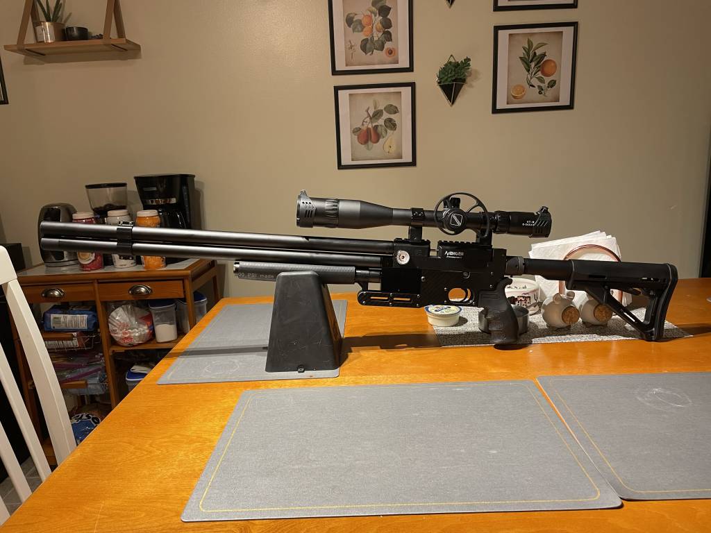

But I think the triple clamp might not be so good in general. I noticed that this gun is very sensitive to anything touching the barrel. The way I have my gun now with no triple clamp and a barrel band on the shroud and main air tube seems to be pretty good. Much better than just that triple clamp.
I did have a rear mount bi-pod on it that was mounted to the m-lok rails on the chassis, but i took it off since having a bipod that far back, although makes the gun very easy to point, makes it less stable overall and harder to shoot longer ranges.
So, with my regulator turned down to 1400 psi and my hammer spring all the way out, i can get about 900 fps with a 10.5gr pellet. but i noticed that if i let the gun sit for a little, it will bleed past the regulator and then stabilize at 1600. 1400 is below the min setting, im guessing thats the issue - its simply out of range. I think i would need a lighter hammer spring or something to be consistent with these lighter pellets. Anyone else experience this?
