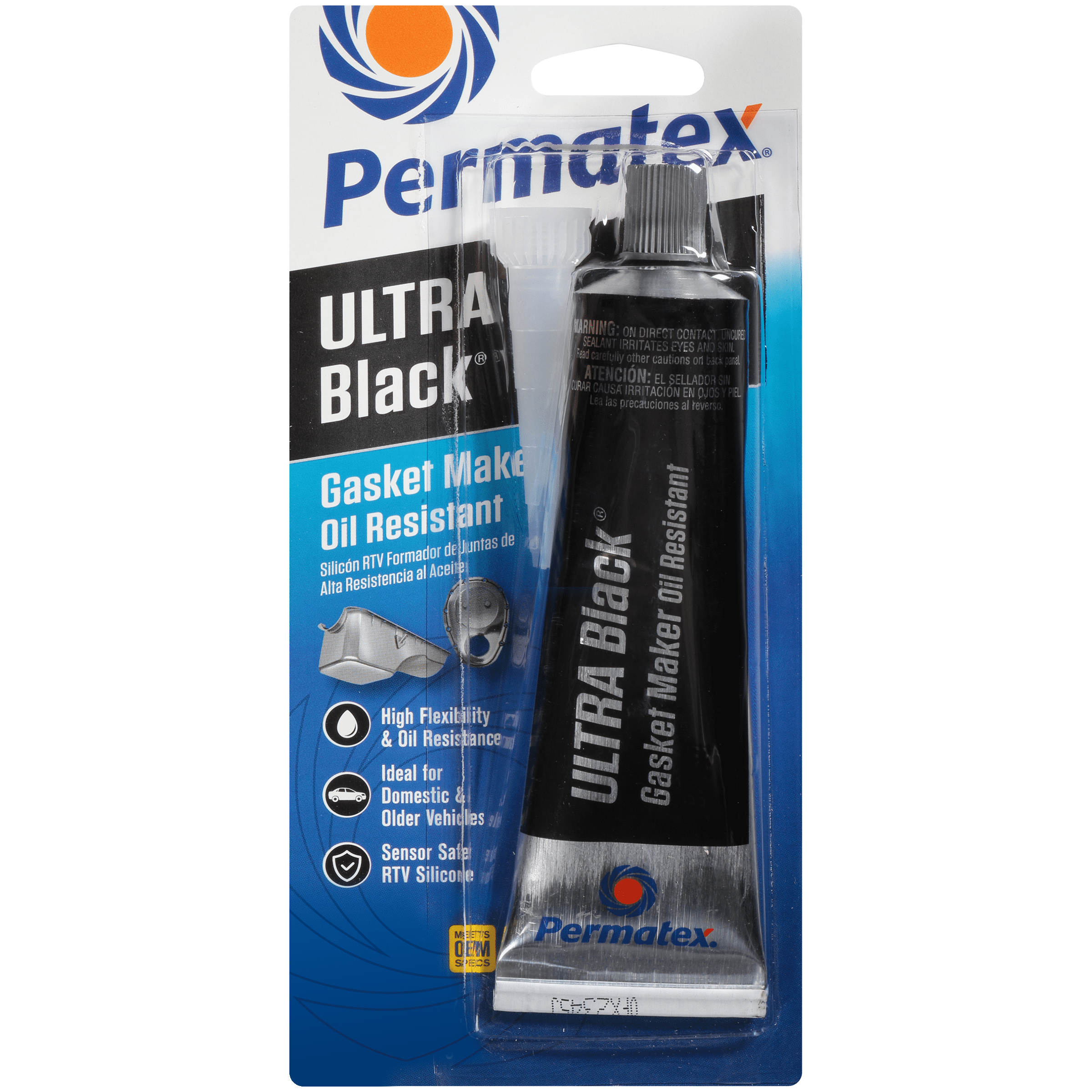

There are different types of thread locker for every screw size and situation. If you only have red and use that on everything that's a problem. In my opinion airguns don't need loctite at all. Any fastener you think may back off put a dot of Permatex Ultra Black RTV sealer on the treads and then store the tube in your freezer until next time you need it. This particular RTV leaves a coat of rubber in the threads that prevents the fastener rotating from vibration but still allows you to turn the fastener with ease. Guys tend to over tighten fasteners thinking it's better to be too tight than come loose but they do far more harm than good. Even if they don't strip threads or bend something they still stretch the threads or twist the fastener. Some have to learn the hard way. Don't be that guy.

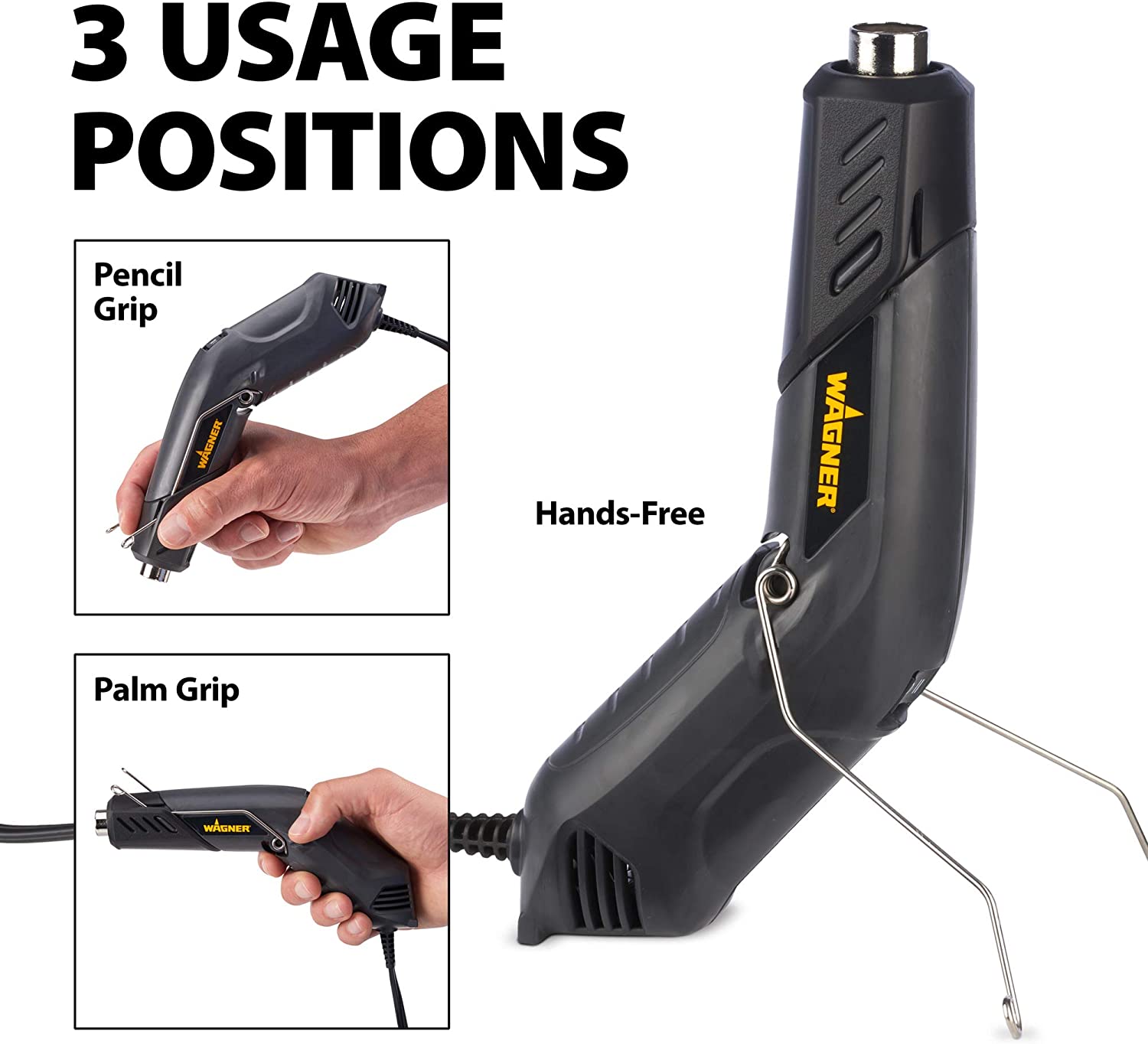

If you ever have a fastener frozen in place with thread locker, put the wrench on it and apply normal pressure while you heat the part preferably with a heat gun but a high powered soldering iron would work or a torch. Here's a chart with the holding temperature for common loctite types. I added the temp in F.
Once again I don't recommend loctite on airgun fasteners. This info if for removal should you encounter thread locker.
