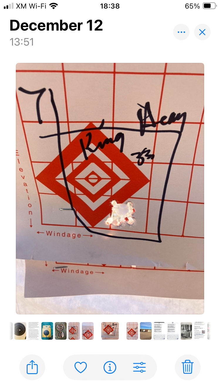

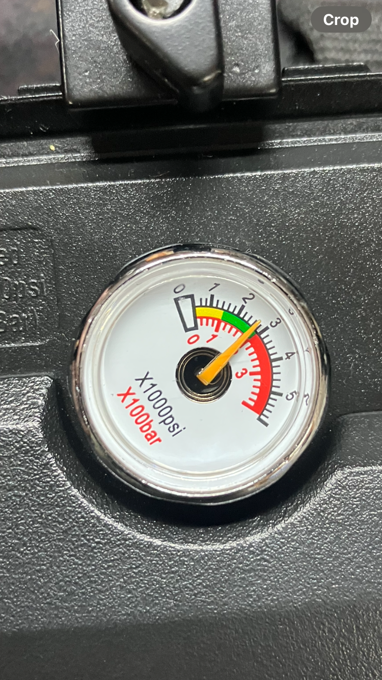

Hi. My Avenger 25 cal shoots very well. My best groups at 50 yards are with king heavies 33.9. Here is my recent 50 yard target and regulator setting. Hammer is factory setting. I was doing a lot of pellet testing and forget the FPS. I will test in the next day or so and update that for you. Dan
