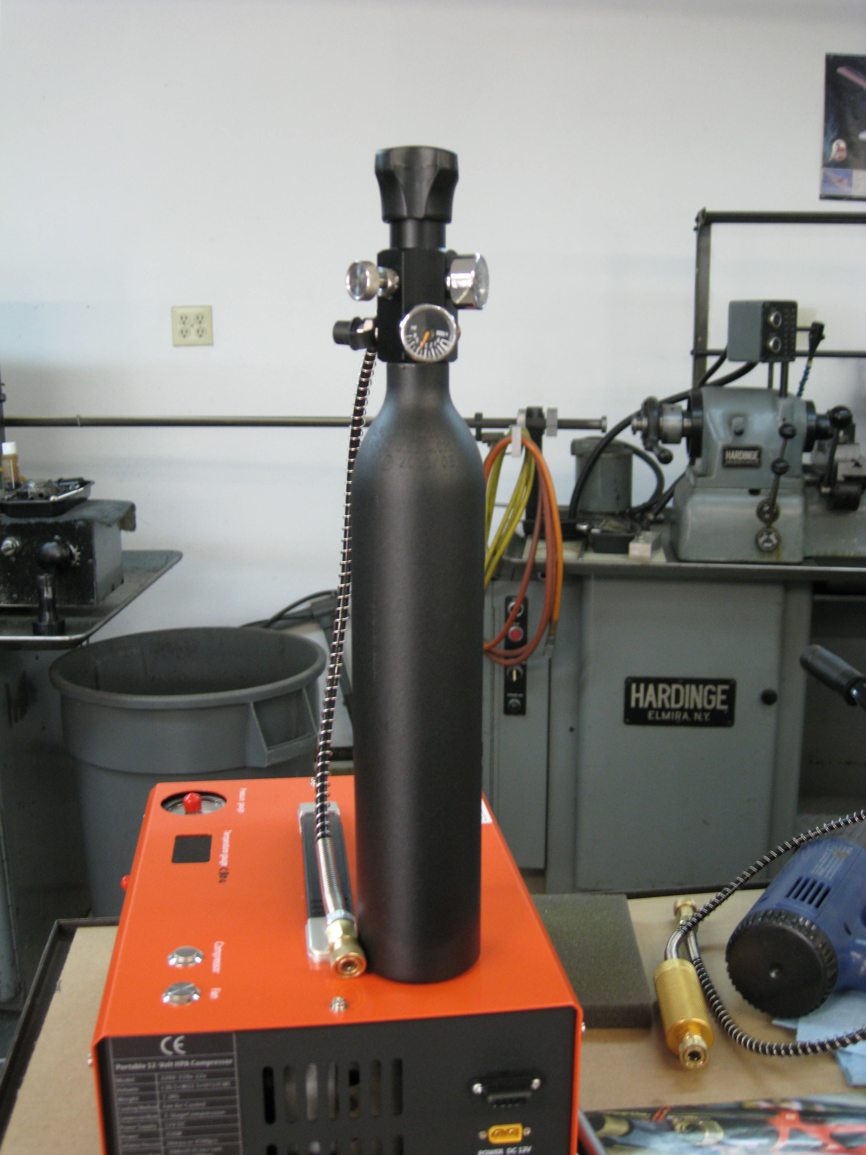

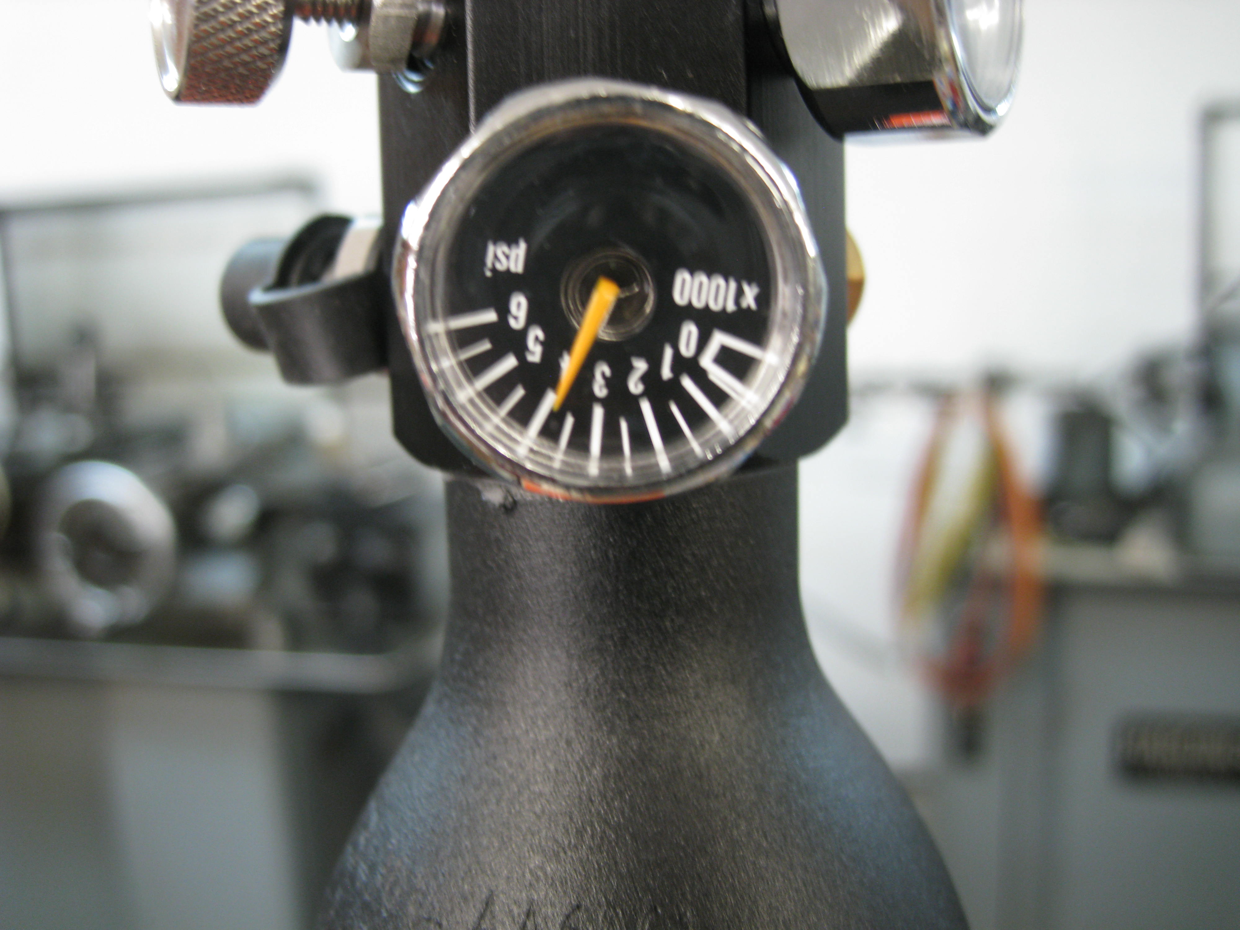

Looks like you've got the same air pump as I do. Vevor?I got a 500 CC bottle that will take 4500psi. I use it to recharge my Avenger. I have been totally surprised that it has held 4000psi on the gage for the last 3 weeks! Got it off Amazon for $108 complete. Saw a pic of the bottle cut in half lengthwise. The wall thickness is between 3/8-1/2" It is supposed to be good to 6500 PSI and I believe it. My compressor will get it to just above 4300psi (300 bar) before it shuts off. I can get about 3 fills above 3000 psi with it fully charged. Regular on the gun currently set at 2800psi.

Spirit-Tech. Probably the same with a different name.,Looks like you've got the same air pump as I do. Vevor?
Yep, you see a lot like that, some just a different color.Spirit-Tech. Probably the same with a different name.,
