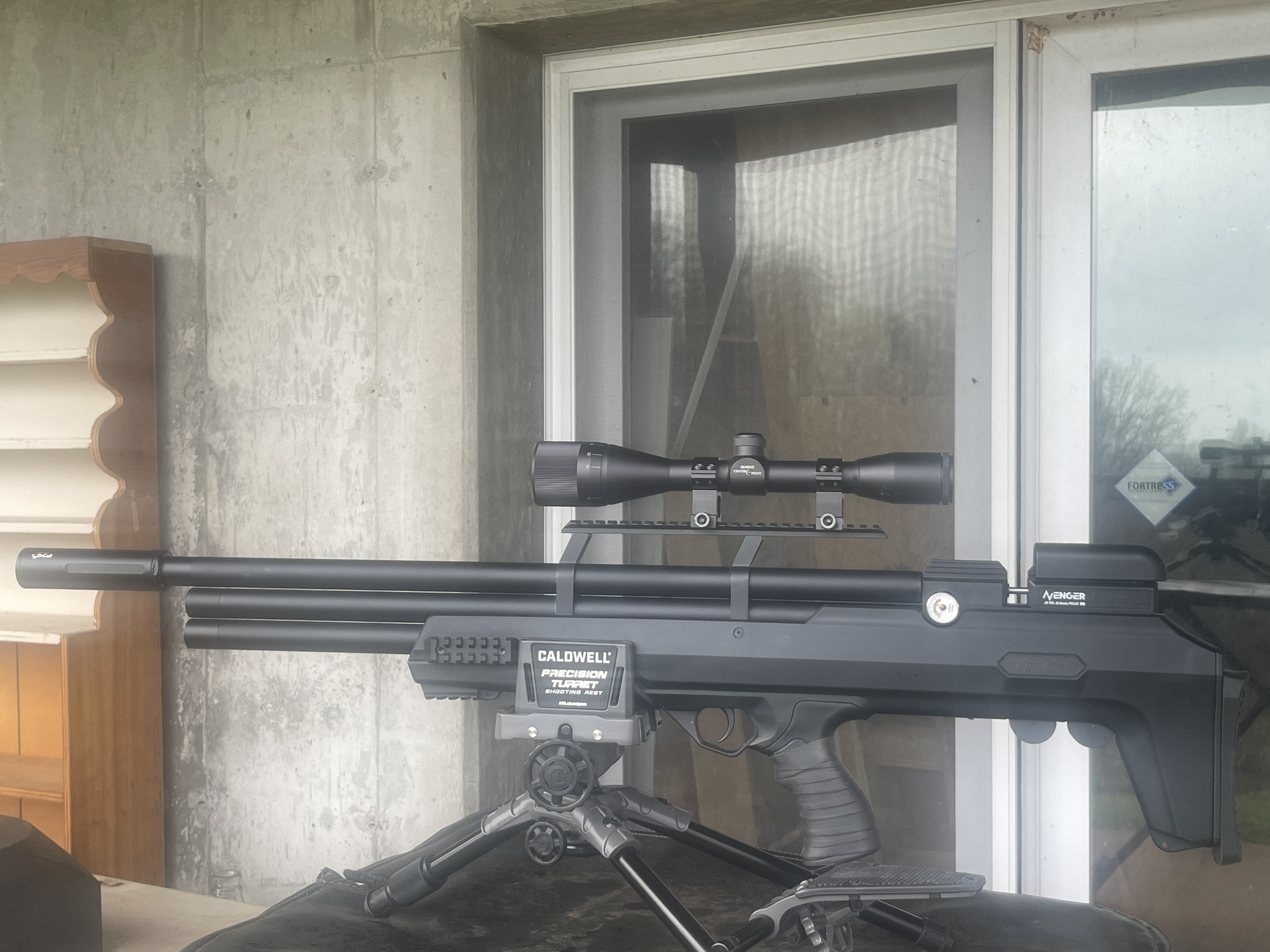

I just added the long tube from my rifle that I put bottle on and replaced the short tube on my bullpup .22. I got 50 rounds vs 30 before hitting regulated threshold of 2800psi. I’m going to reduce down to 2400 psi and check shot count with FPS n FPE using JSP 14.3g pellets.

OK, I saw Rollo's bullpup, that's the photo you're talking about, right?
Which tube do you use to fill the rifle, or do you fill both tubes?
Both tubes feed the breech block, and they each have threaded ends on both ends. You can swap all the small tube parts to the big tube and have one foster fitting, or have 2 fosters. Doesnt matter which tube you fill with. But esthetically have both fosters and both caps looks the best imo.
