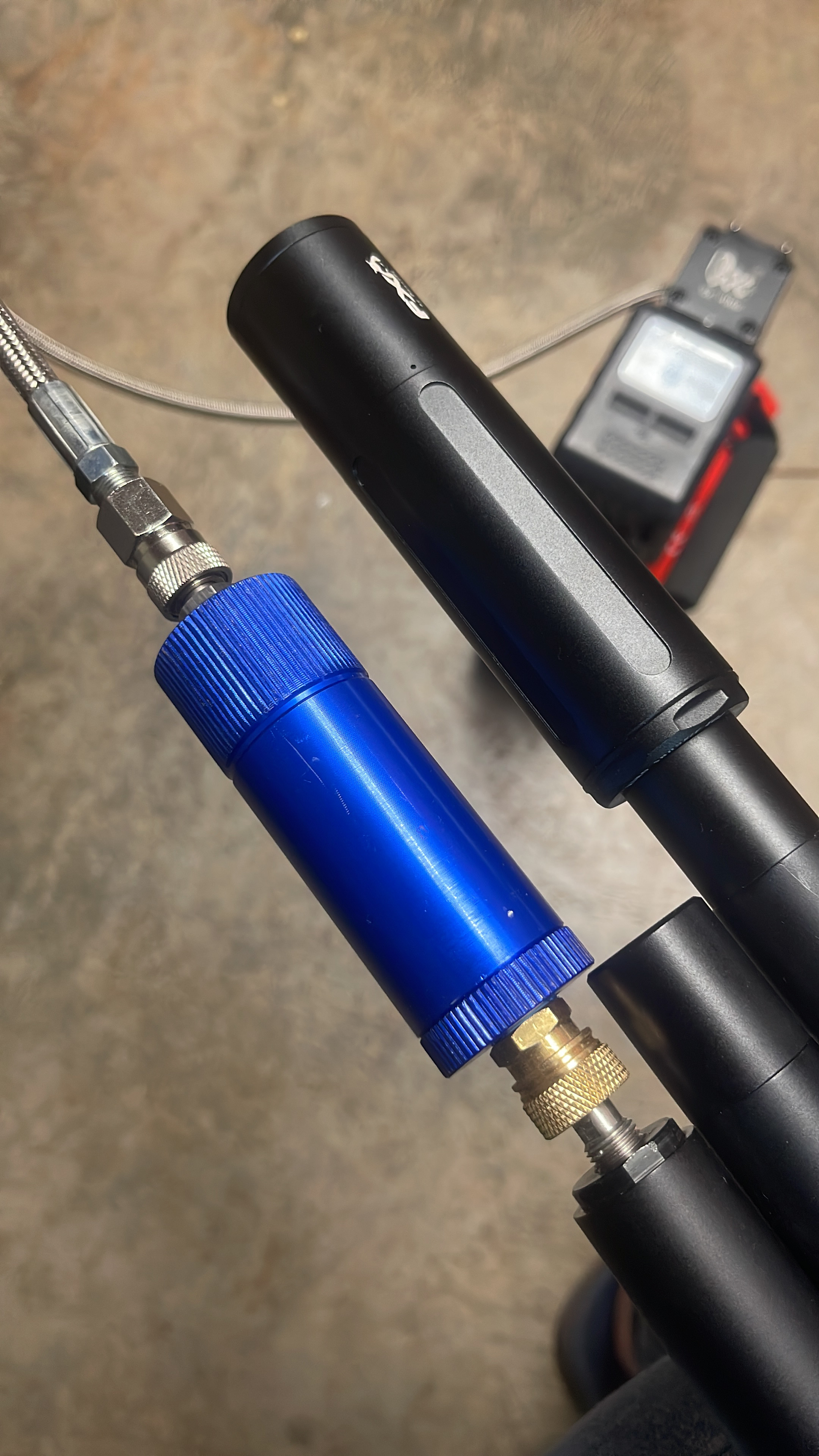

Which tube do you use to fill the rifle, or do you fill both tubes?
I've got both the original air tube if anyone is looking for them

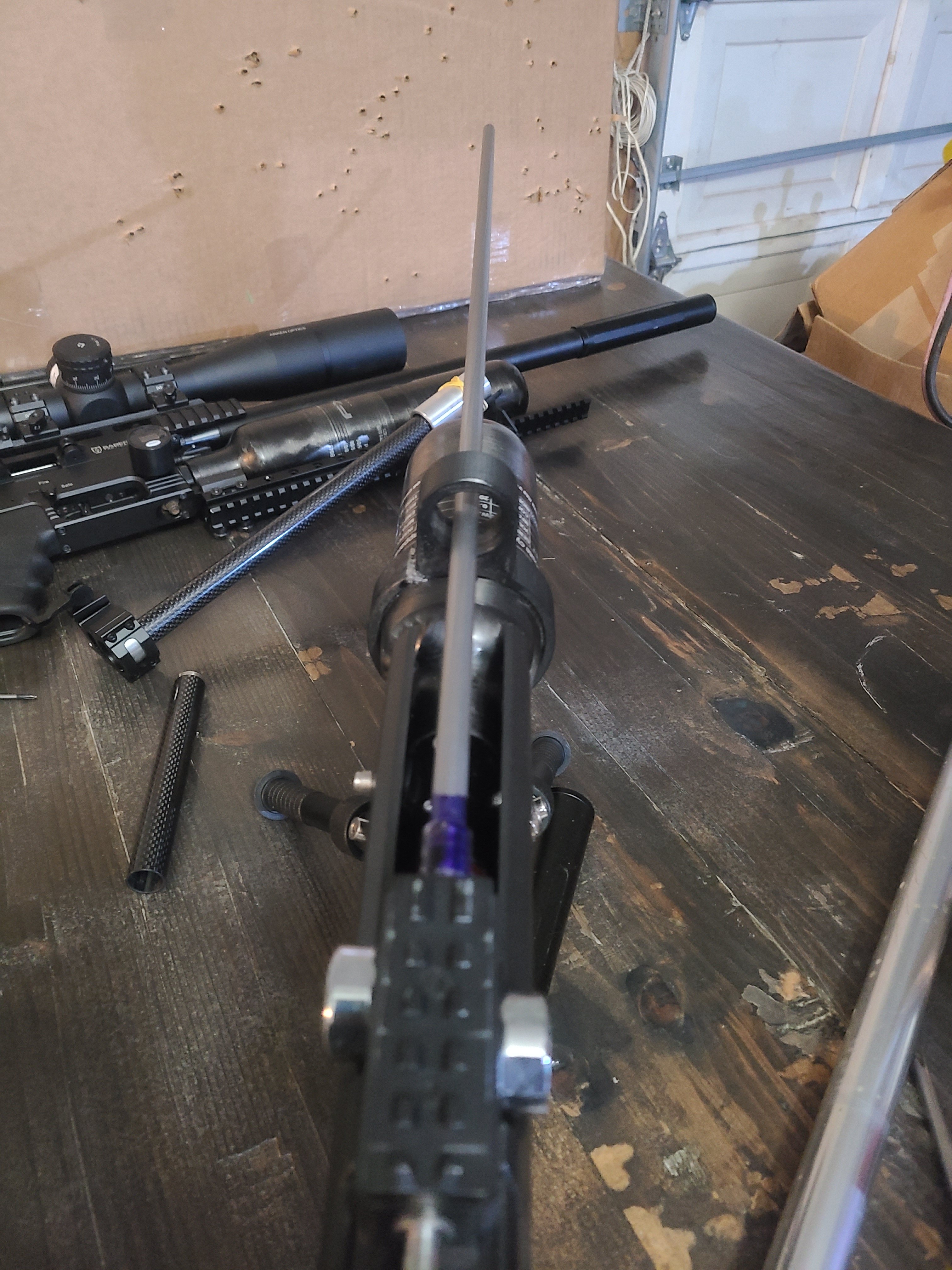

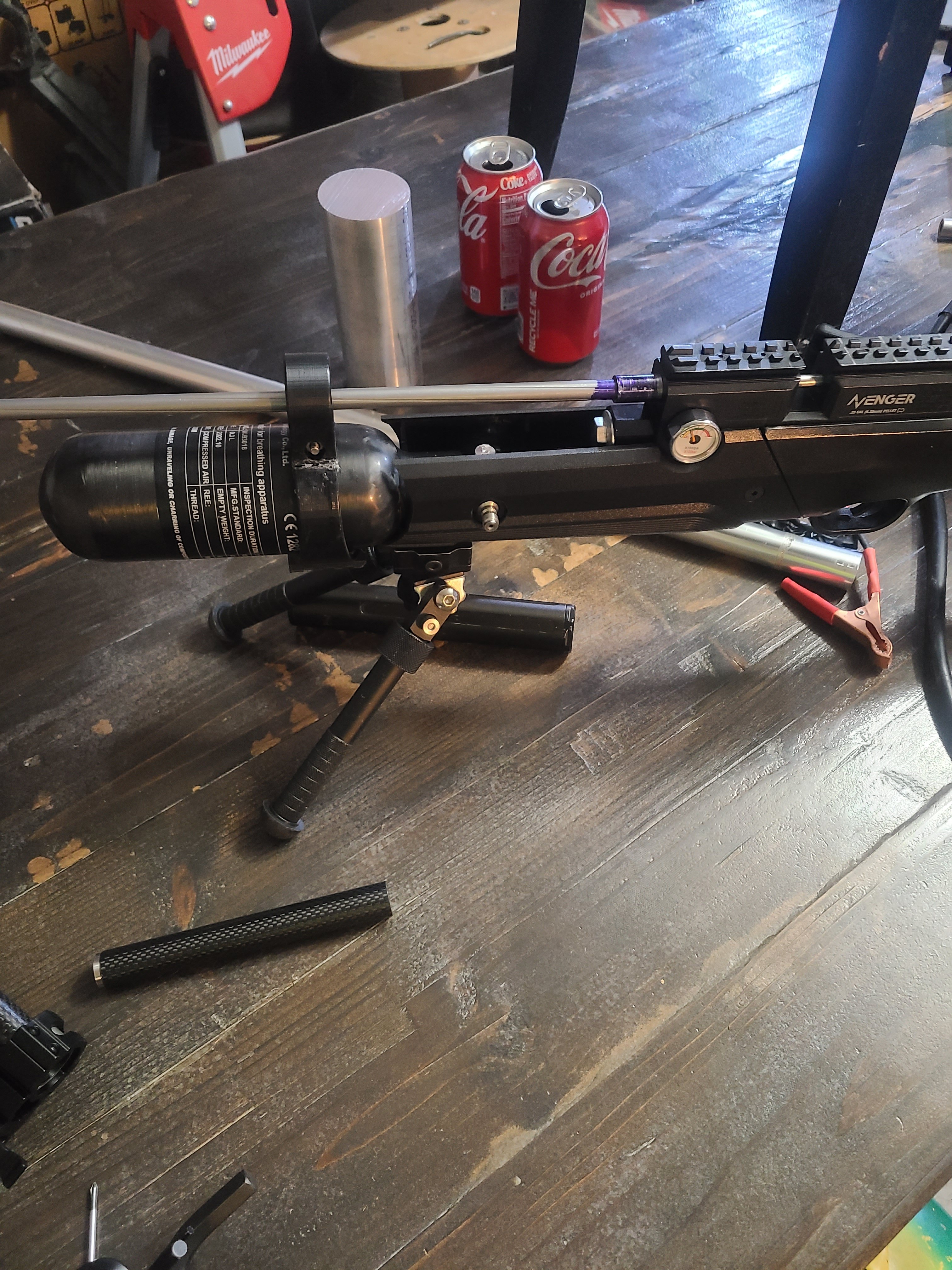

I've converted my to a homemade 300cc bottle conversion kit, with 2 regs on it now.
I don't think it will go back since cutting the stock down.
Also, fitting the barrel to one of my impact barrels liners to see how it shoots. I will be adding a barrel tensioning system to add to the 700 mm FX barrel.
I'm not sure if I want the 500 mm or the 700 mm, but for now I'll see how the 700 mm shoots.

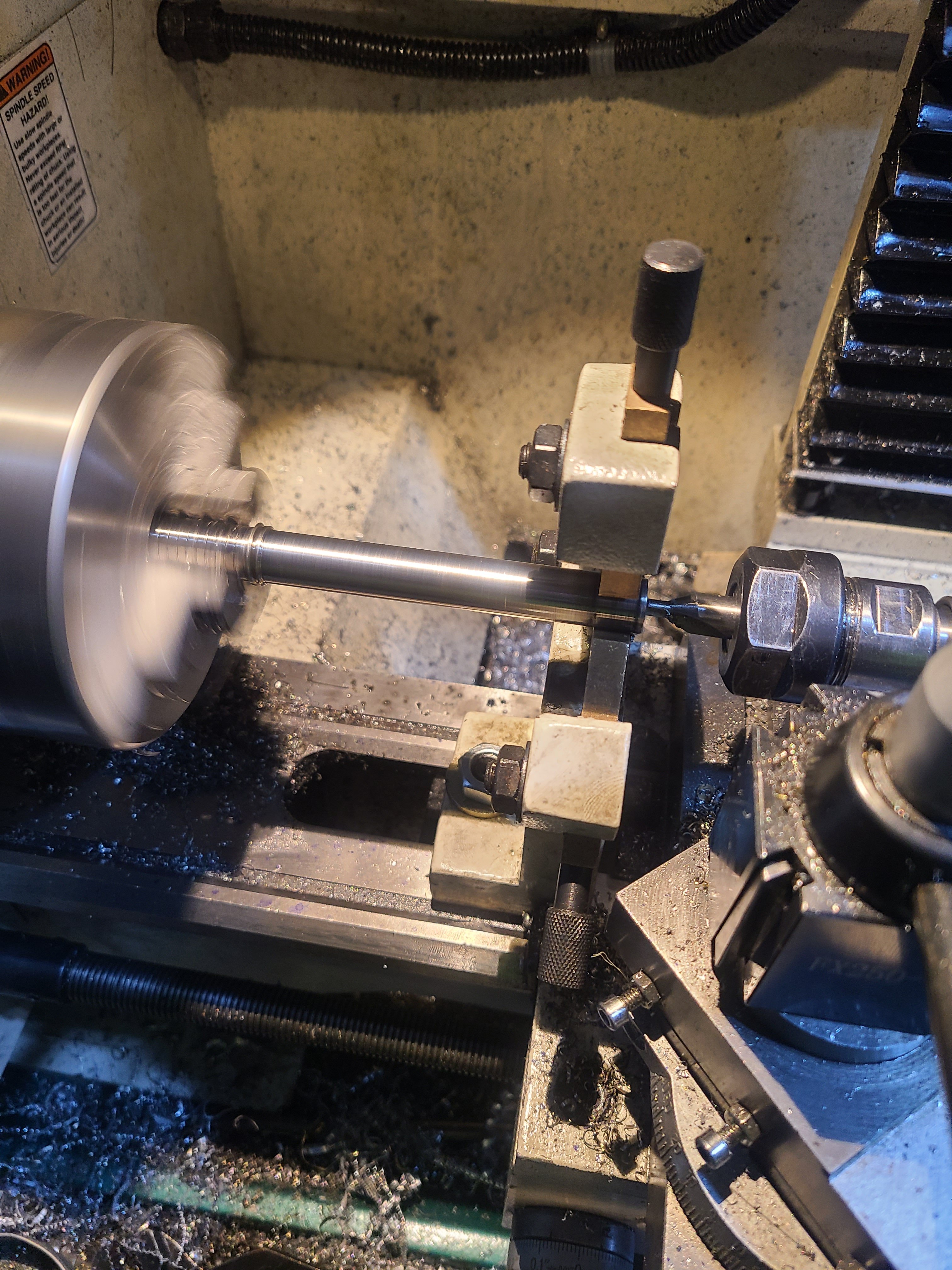

The bottle kit was milled from a paint ball gauge threaded to a coupler 14x1.25 mm like the barrel tube to the 18x1.5 mm bottle.
Just got bored with the FX Impacts, So I took spare parts to see what I can do to some of these budget PCP to get it like the FX ones.

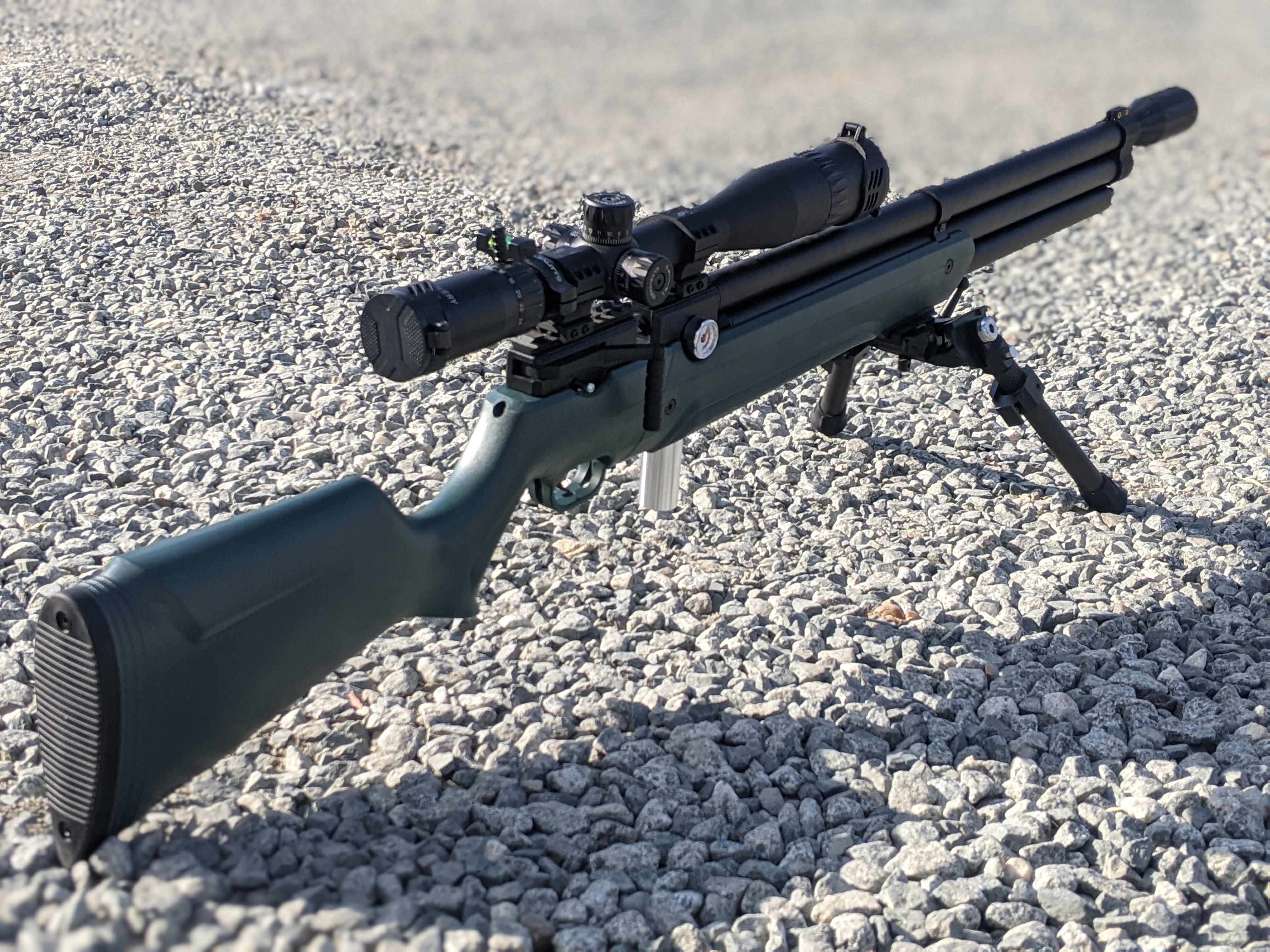

No, there's the long reservoir you can see, and a short one under it inside the forend. Some people have replaced the short one with another long one to increase air capacity.

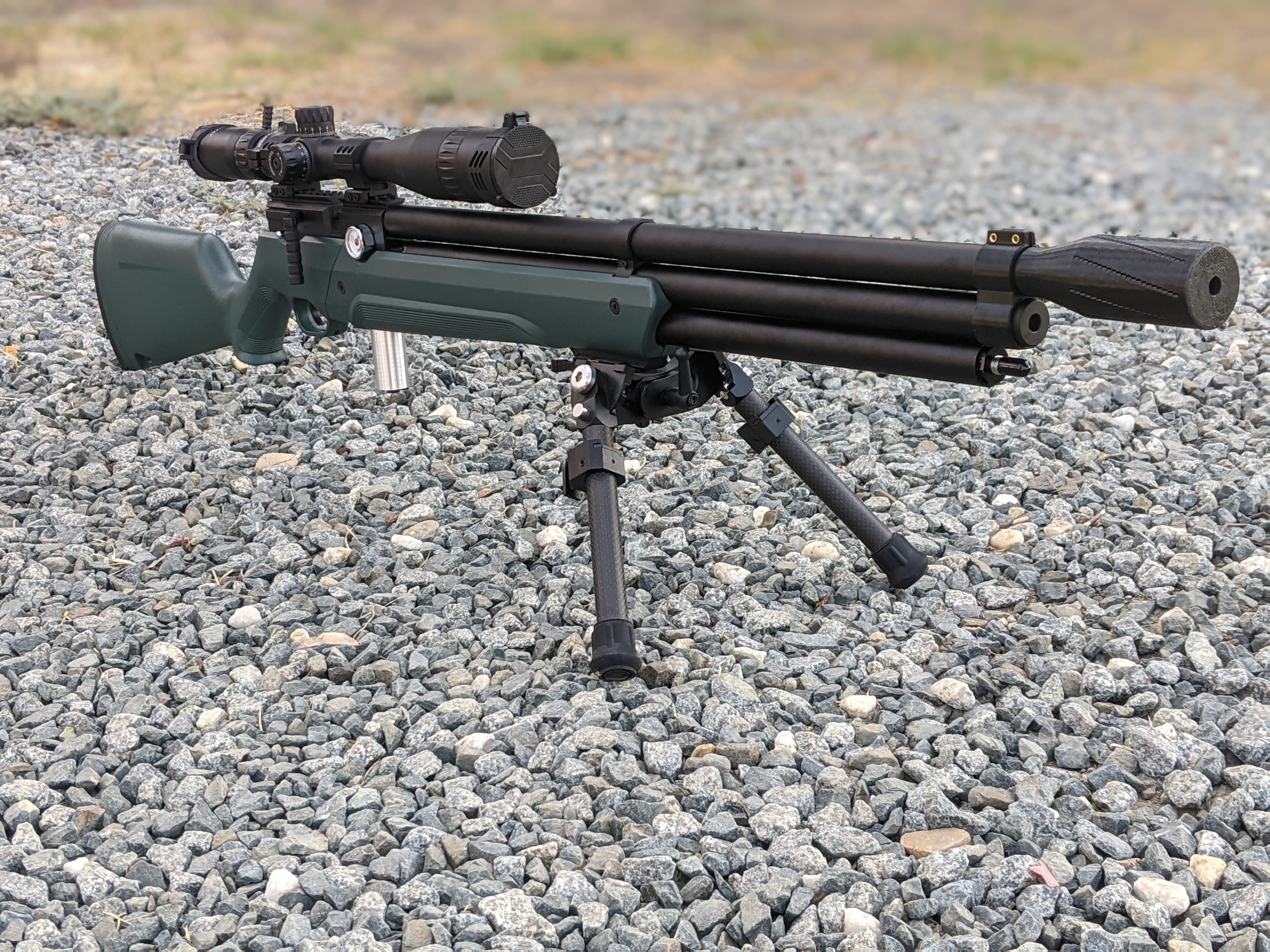

Reviving old thread because I have original Avenger that I bottle swapped and have the long / short tubes sitting around.

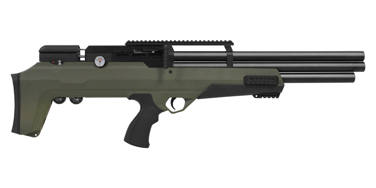

I am very interested in putting the long tube on an Avenger Bullpup II but havent purchased yet. I've been googling around and stumbled upon this:
It is an Avenger Bullpup II but in OD green and already has the long tube installed from the factory!! What a joke, Air Venturi USA! We would totally buy that exact set up here. Love that 2 tone color, and it claims to be 280CC b/c the 2 long tubes.
I watched the video (no clue what he says but every 5th word is English and unfortunately my closed captioning didn't work..) Anyway it looks like over seas they get a complete setup with the 2 long tubes and an LDC included with their Behemoth.
Anyone think that the 280CC claim is accurate? If normal is 180 then 280 CC is 1.55 x the capacity and that'd be a great upgrade since it seems putting a bottle on a bullpup is difficult anymore, plus I already have the extra long tube in my box.
Just thought I'd share this link / video cause I think you guys would like to see a "factory 2 long tuber".
So, those who did the bullpup two long tube mod. What did you use to get the tube to fit? Was it just an Xacto knife or was it a plug you remove? From the video it seems like there was a plug on the old style bullpup but idk I don't have the Bullpup II yet.
Anyone else wanna chime in with their numbers? How many more shots/fill do you get by going to 2 long tubes?

I just found this thread.. I'm kinda new around here.
I had the idea come to me to replace the short tube for another long tube and I'm glad to see others have already done it with success.
I have the Buck Rail Tactical kit on my .25 so I won't need to do any stock cutting. That kit also supports all 3 tubes so I won't need to add a barrel band.
I bench shoot and have added an MLok pica rail to the bottom of the BR fore grip. Putting a bipod on the forward most pica slot should mitigate the front weight added with the extra tube.
My reg is set at 2100 and I get 6 12 round Big Air mags at a 33 fpe average with my cast NOE 251 27 RF pellets. I expect this added tube to increase shot count by 2 mags. We'll see.
My typical backyard range is 45yds but I do have a steel target at 80yds out in the woods. The gun is minute of paintball accurate at my 45yds and I can do 1" groups at 80 with a 4 - 5 mil dot hold over.
I weigh and cull the pellets to 27.4 +- .20. I tumble and size them.
Anyways.. another member is sending me the tube and I'm looking forward to doing this and sharing my results.
Oh yeah, I will be getting the parts to make the gun .22 as an option... I cast .22 pellets as well.
