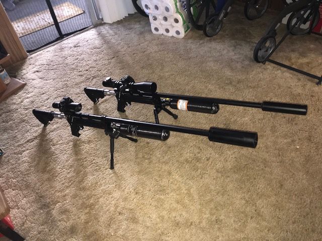

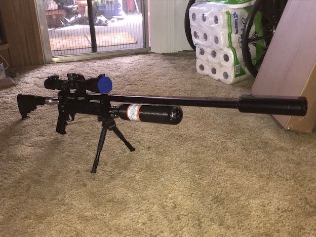

I know im a tad bit late but what chassis and stock are you running on these gauntlets? ive been looking for something like this and no luck.
I 3D printed my own setup on the front stock and hand grip, I made an adapter for the but stock on my lathe, just a standard adjustable stock from PA, go to Tinkercad and search for Gauntlet grip and Gauntlet both halves fore grip.

Thank you!!! Love the way yours is set up. I'm trying to make it a little lighter and more agile and I've heard this takes 2-3 lbs off from the original synthetic stock. That ebay link has some incredible stuff, that will most likely be the rout I go. He seems to have really good feedback too.

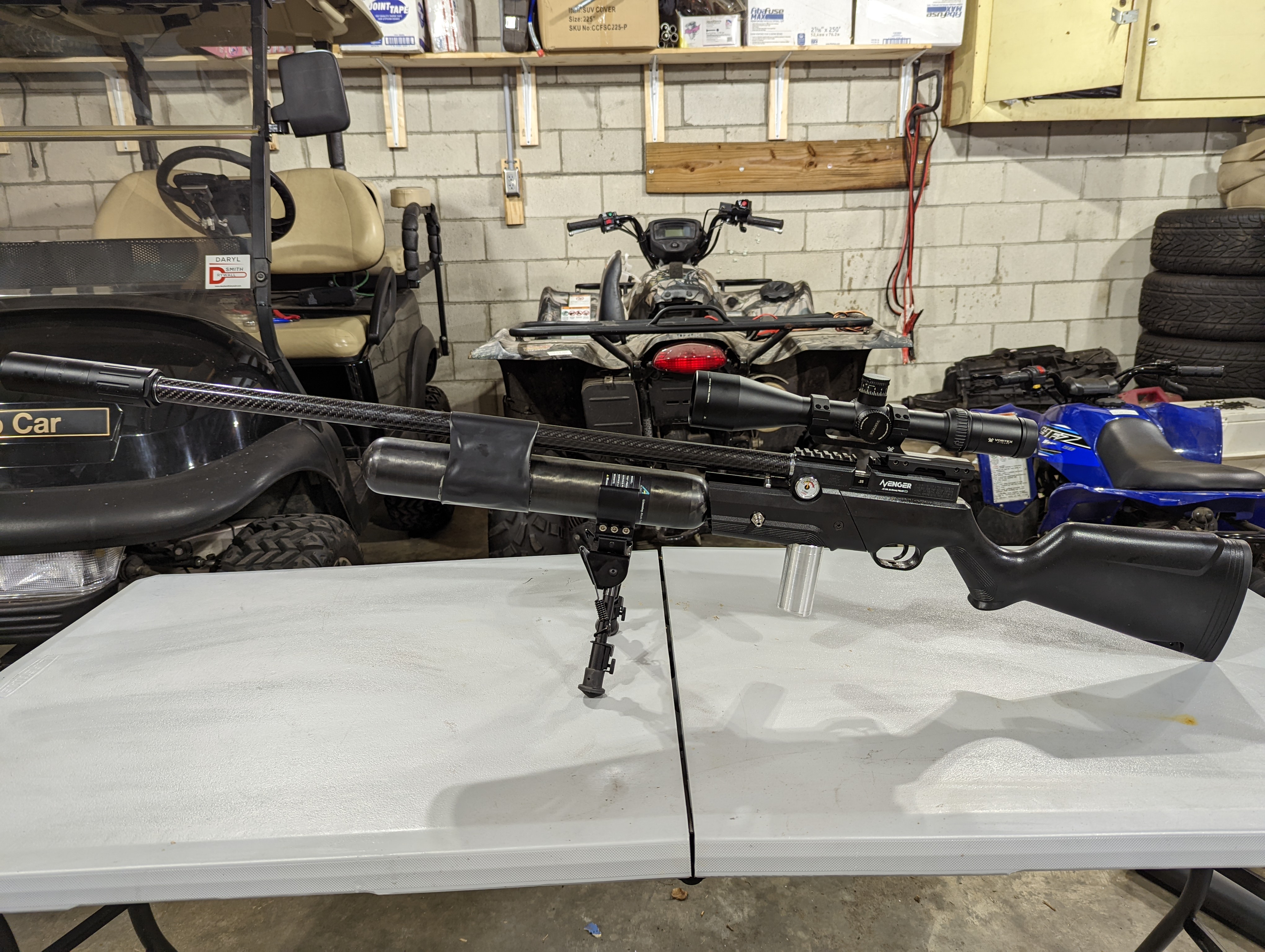

This is my barrel stiffening solution. TJ barrel wrapped in multiple epoxied layers and a homemade "barrel band". The barrel band is actually just molded epoxy putty in between the barrel and bottle and then it is wrapped in super thick adhesive backed shrink tube. I made the epoxy support section because my barrel and bottle are not actually perfectly in line which caused all sorts of headaches when trying to use standard bands. This way they can be slightly off center to each other but tightly clamped. That heat shrink tube is very strong!
Nice work! It looks bad @$$!
