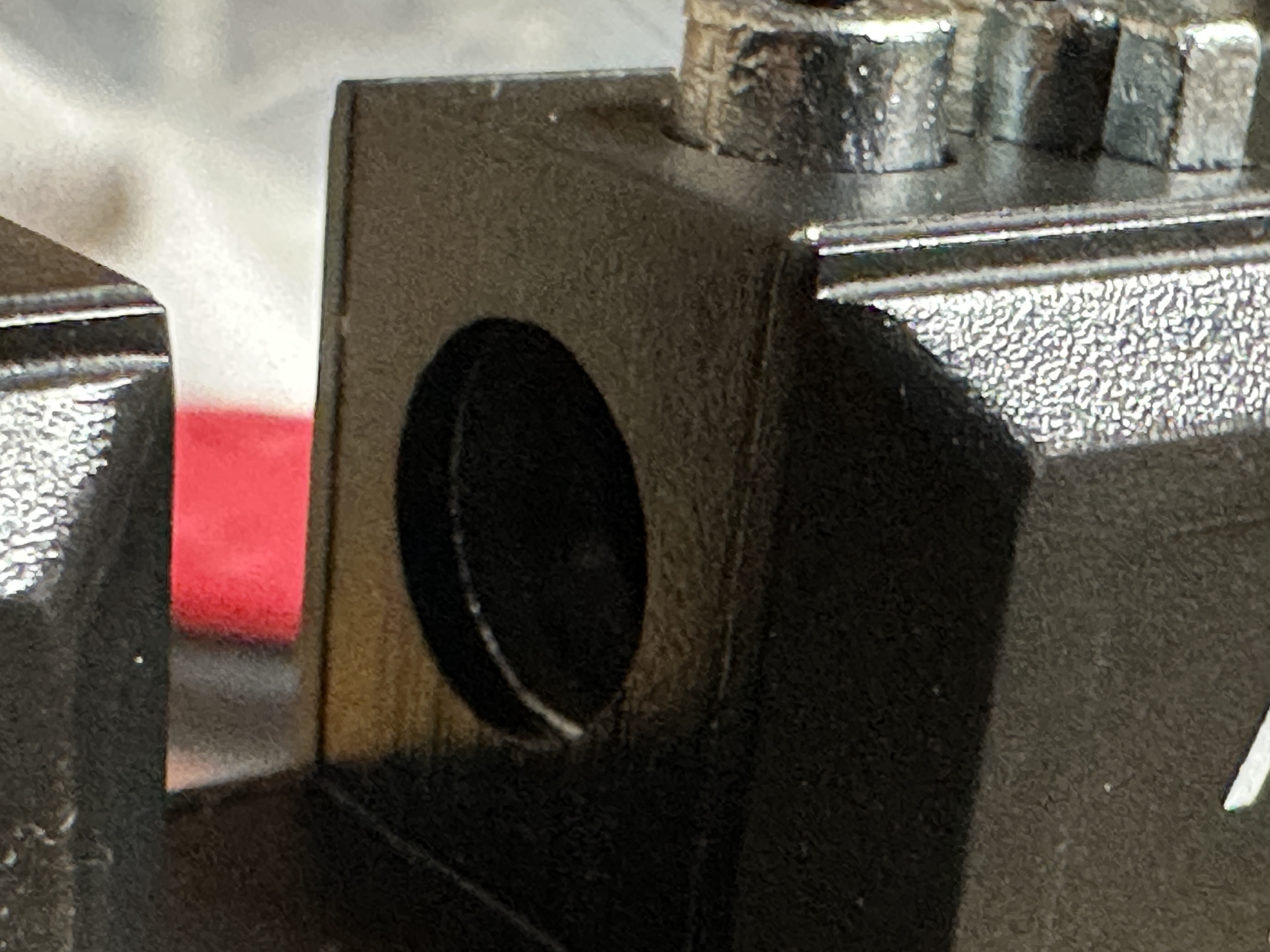

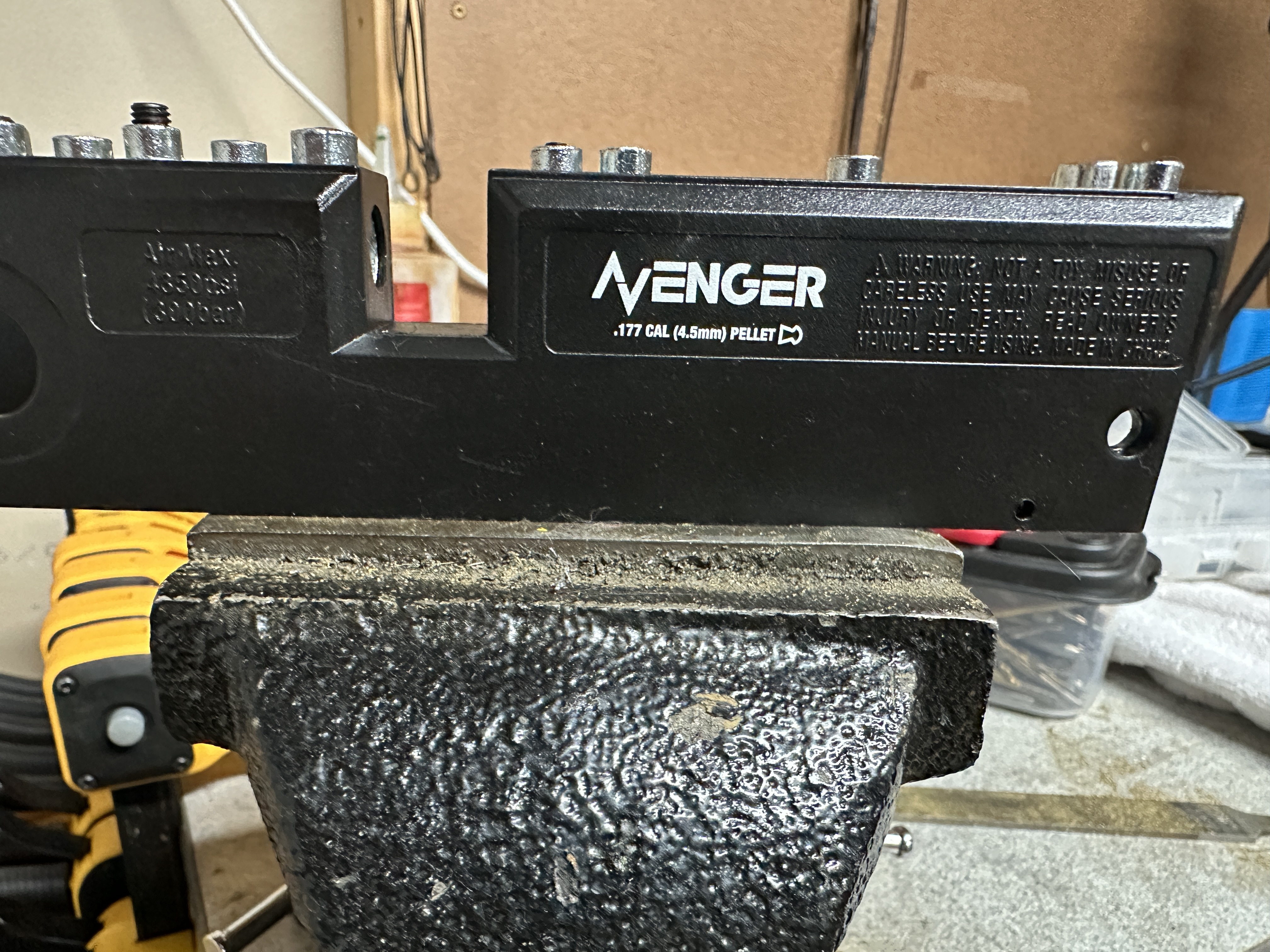

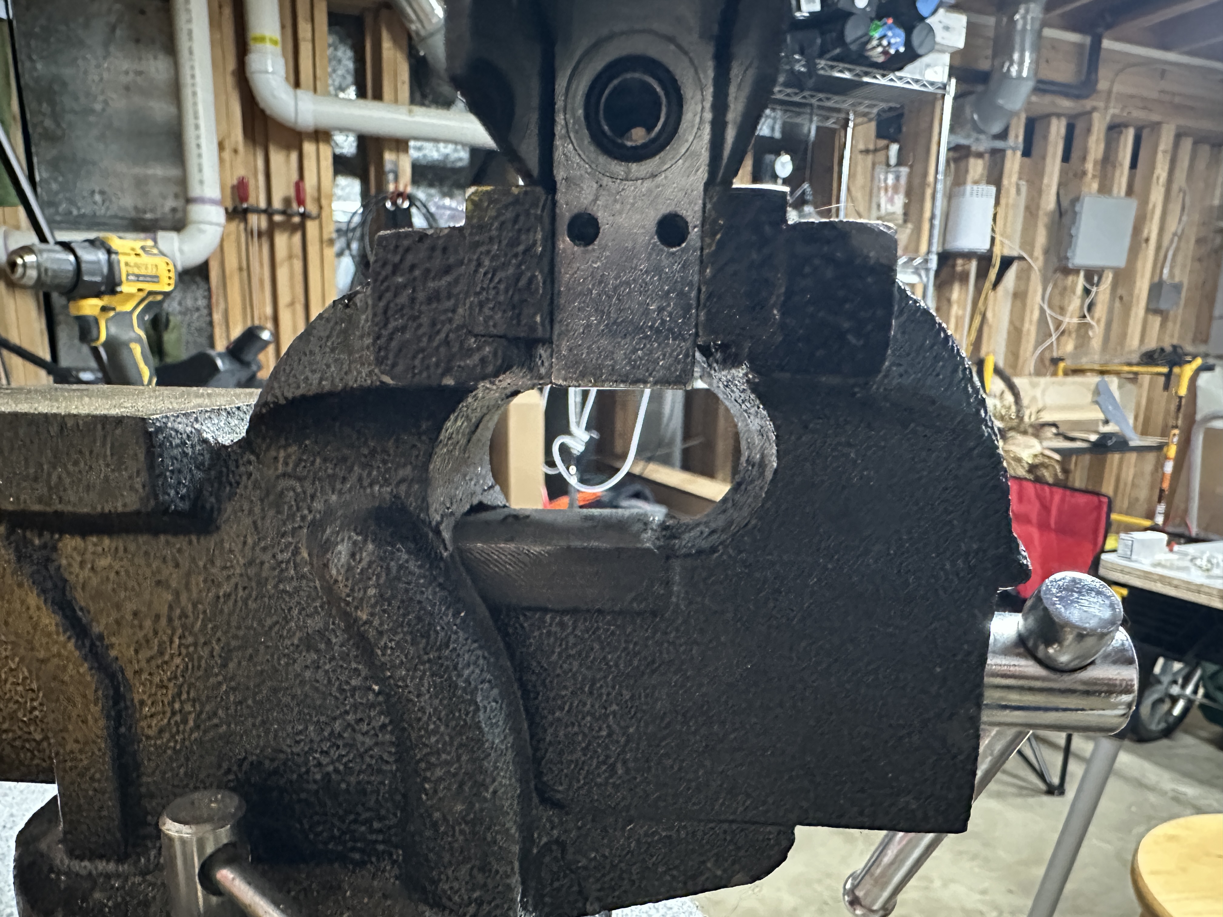

I took a look at the spare avenger bullpup receiver I have for a future project/parts and figured it out. Once you have the charging handle removed. Remove the pin that is located in the back and lower part of the plastic cover. The pin protrudes on both side to help keep the plastic cover on. The second piece that keeps things in place is the plastic bushing the pellet probe rides through. I used a small wooden dowel to push it to the rear about a 1/4 of on inch. I then placed the receiver in a vise with the plastic cover straddling the jaws. Don't lock it in, just have the plastic cover sitting on the jaws. Lightly tap the cast part of the receiver with a rubber mallet or small dead blow hammer if needed. Should have done this with my first avenger project. I got it separated but it was pure brute force and ignorance.

I just tried it and finally the thing is off, all I had to do was push it a little with the back of a pencil and the cover came off. ( have to admit i already went a little crazy with a chisel before i saw your post but it was still stuck). Thanks a lot!
