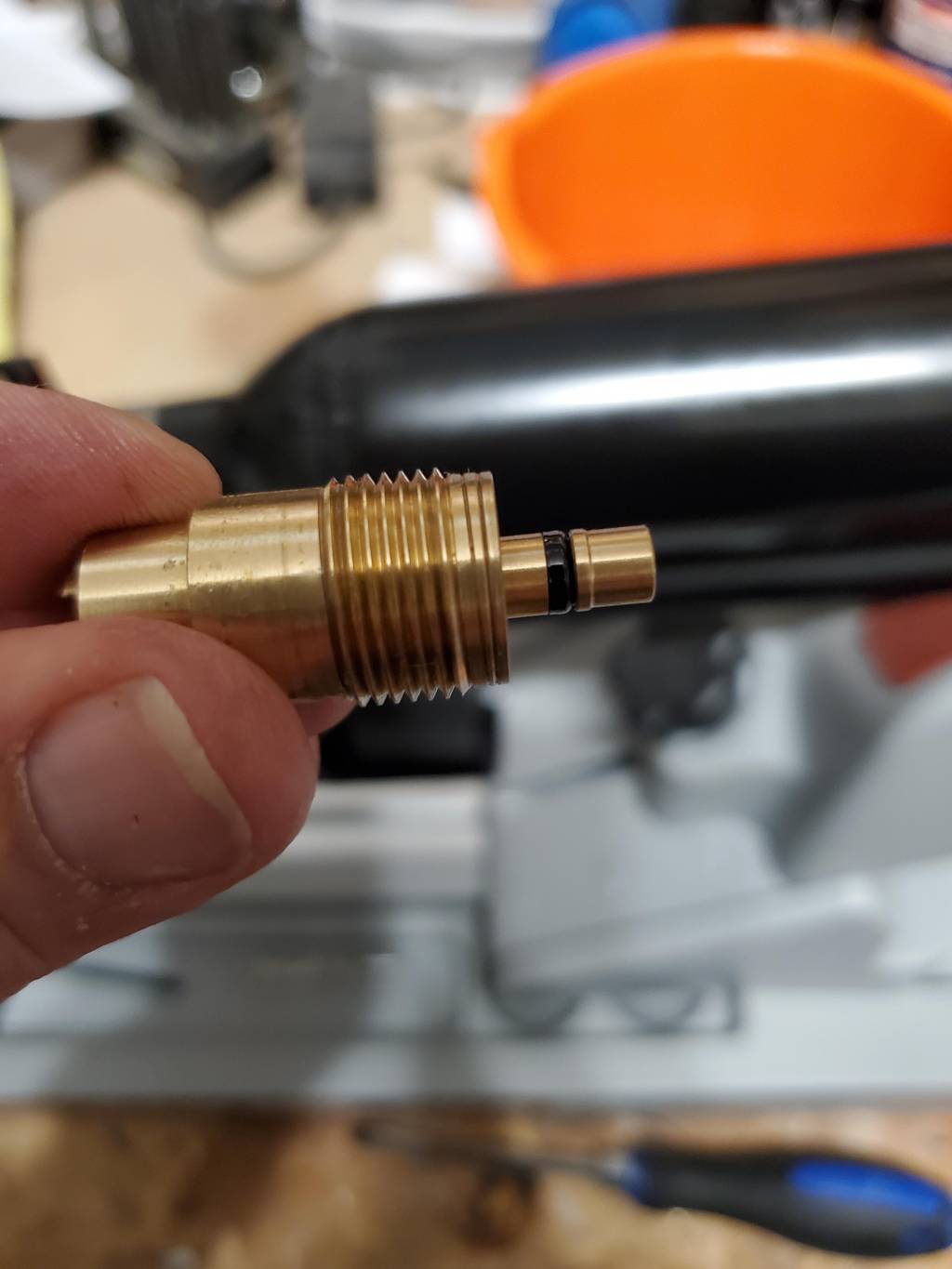

Hello all. I need some direction. I recently purchased
on Ebay a new Avenger with no box or papers. I bought all the parts to convert to bottle. After I degassed and installed all parts, I filled back up with air. I noticed a hissing sound where the regulator is. I took it out to inspect it. Clean as new. I tried again. Still leaking. I tried thread tape whit and yellow, still leaking. I added a little greese. Yup, still leaking. I am at a loss as what to do now. This is a gift for my daughter who's birthday is 46 days from now. I called Air Venturi. They said I could send it in but I have no warranty. Any suggestions? Thanks in advance.

@Golfdad - Mine developed a leak after degassing a couple times. Turned out to be some crud that was left inside from manufacturing....the crud got lodged in between the bleed screw and seal. Are you sure it's leaking at the reg? When mine leaked, it was coming out of one of the holes in the cover, next to the bleed screw. Also, when I had my reg out, I found the o-rings had some damage (cut during assembly....at the factory). Might be worth looking at the o-rings with magnification....or just replace them.
@trophysquirrel - yes, drift the pin out enough to provide clearance to unscrew the reg. 2mm, if I remember correctly.
Edit: the pic in this post was illustrating the reg seal, but you can see where there might be a problem with the o-ring (I replaced it....I'll see if I can dig up where I found the "equivalent" size suggested by Tyler Patner). https://www.airgunnation.com/topic/avenger-regulator-newbie-questions/#post-1005567
Edit2: the small one's equivalent is a -005 (3/32"ID x 7/32"OD x 1/16"CS B90). Here's the thread: https://www.gatewaytoairguns.org/GTA/index.php?topic=177140.0 The op in that thread used a -006. This is too big. The -005 is mentioned a few posts down.
