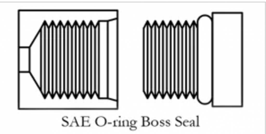

The fill nipple has straight threads, either M10 or 1/8 BSPP. It has a seal at the bottom that the base of the nipple compresses.
Update: Typically, the check valve is incorporated in the foster fill. This one it is down stream of it. I would replace the seal first, or sand out rough surfaces. It is typically a white plastic like seal. Worse case, you can try sealing it with tape on the male threads. I think there would be low risk of failure. It only has pressure while you are pumping. I also know that many have fixed the chinese hand pumps the same way. Good luck.
