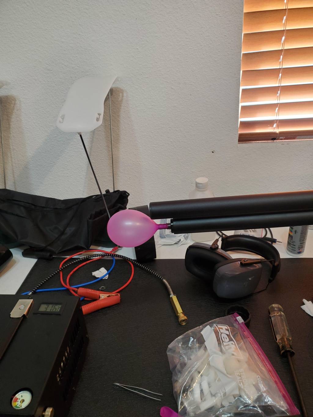

I've been very careful adjusting the reg. It creeped from day one but now I'm noticing a drop in the main tank. Topped it off Monday and will let It sit till Friday and see if it stabilizes. Plan is to keep shooting it for a few weeks. Let's find out if this is just a quirk or a actual problem. As long as it holds air, a little reg creep i can live with.
Mystery solved
