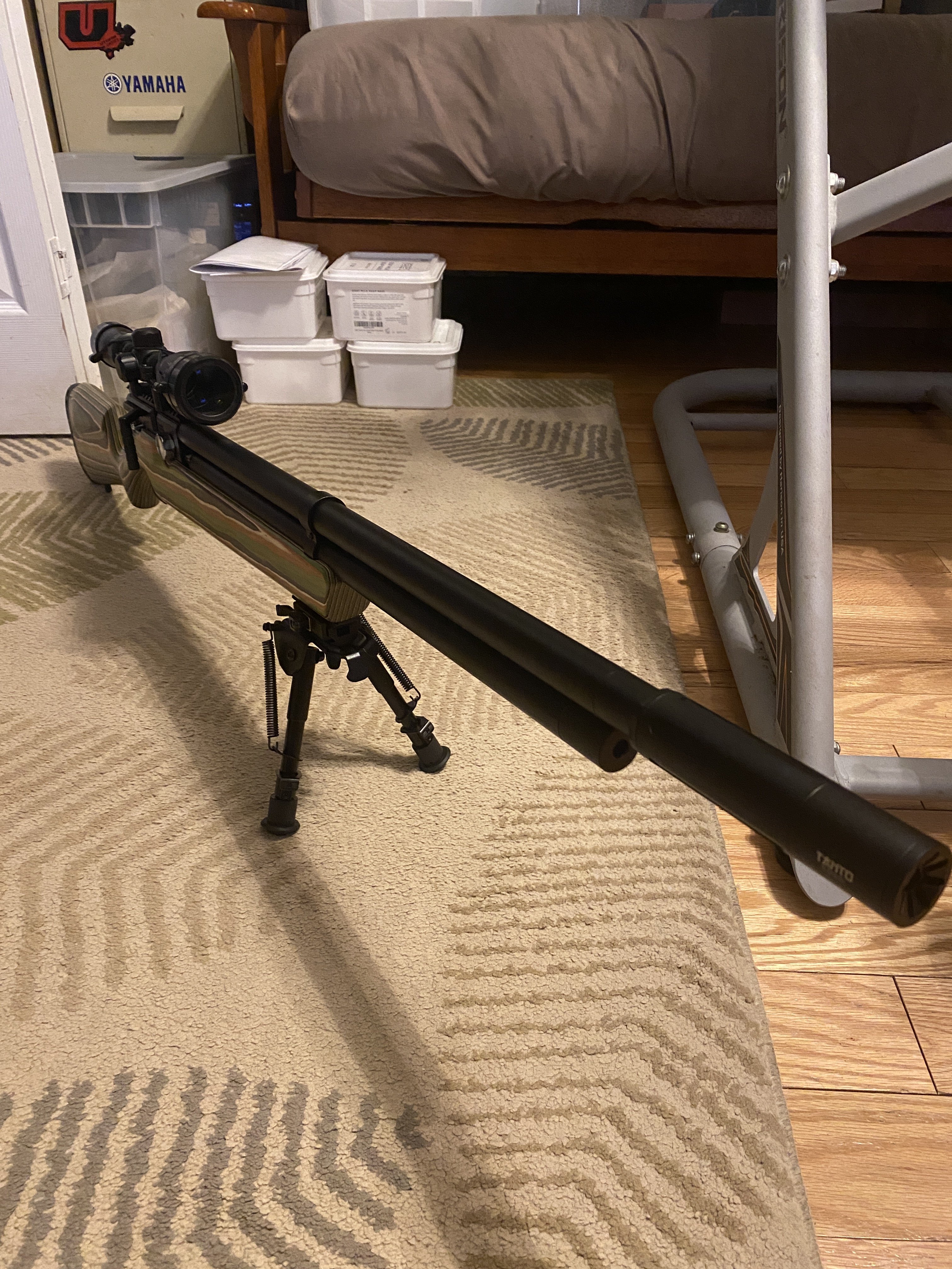

Hey peoples how's everyone doing. I just got into PCPs about 3 weeks ago. I picked up a Gamo Arrow and it shoots great using Crosman Premier 14.3g .22 hollow points. I decided to grab an Avenger, DonyFL 1/2 20 UNF adapter/barrel stabilizer, Tanto moderator, Saber Tactical upgraded pic rails and a descent compressor. I finished putting it all together, filled her to about 3500 PSI and took it out. I'm shooting the same 14.3g Crosman hollow points I shoot from my break barrels and from my Gamo Arrow, and I can see the pellet start to spiral at about 20 yards. I'm only shooting to 50 at the most, 9 times out of 10. At 50 I'm having to hold down 2 mil in my scope and left 1mil. The pellets land right on top of each other, nearly. I tried dropping the regulator down to 1300 PSI and no preload tension on the HS to 1 1/2 turn in on the HS. Also, many 1/4 turns between. I couldn't get the velocity below 880. Do I need to run a heavier pellet to get rid of the spiraling. None of my other guns spiral at all that I can see and hold excellent groups. Sub MOA at 50 yards so 1/2" groups. If a heavier pellet is the answer does anyone have any recommendations? There are so many choices. Oh, to add, I clean my pellets, dry them well and lube them with REM Oil. A very thin coat, they aren't dripping wet with lubrication. I don't know, I've found cleaning and lubing like this works very well for me. Thanks

The spiraling reared its ugly head again. Wasn't sure why. Stacey gave me the green light to disassemble the gun, letting me know it wouldn't void my warranty. Kind of important seeing I was having issues. I discovered the barrel wasn't properly seated into the receiver and the barrel grub screws were a bit loose for my taste. Simply re-seating the barrel took care of it. I'm finding I can run several different tunes and pellet weights now, and the pellet flies in a nice straight arc like it's supposed to. I found a happy spot at 2000 PSI and +2.25 on the hammer spring. She is whistling dixie now. Extreme spread on the shot string is 6FPS and averaging 883FPS with H&N Match 21.14g pellets. So glad that worked out well. Thanks to everyone who was supportive and helpful. Glad I didn't send my gun back for a "faulty" barrel.

I think it's a beautiful gun with the colorful wooden stock. One of the main reasons I pulled the trigger on it. Thanks for the complement. Yes, I'm very satisfied that I was able to fix it and not jump the gun and send it back.
