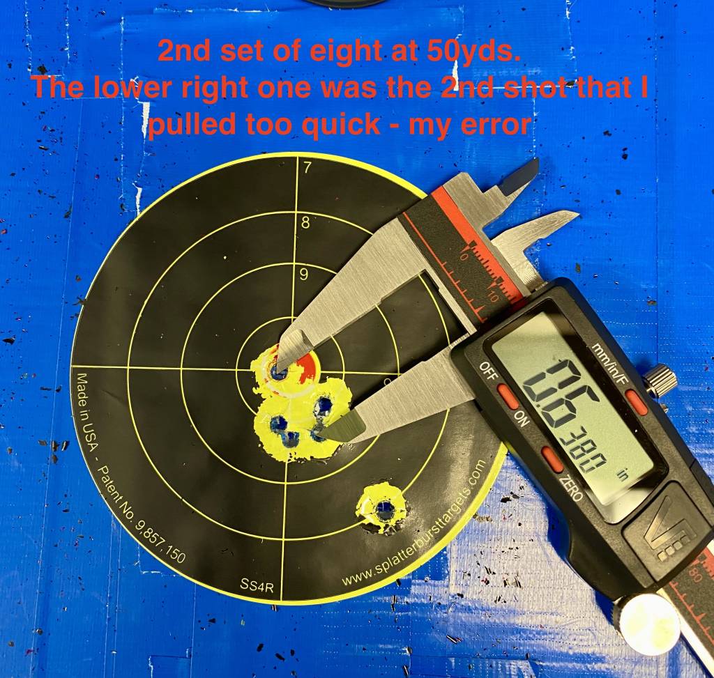

My .25 at 50 yds
Nice!!! I hope I am able to do that well with mine. Have to get it out to where I can do 50 yards. Sure it is capable just not sure about me. Lol. I’m just glad that 30 FPS spike is manageable for now in a hunting situation.
