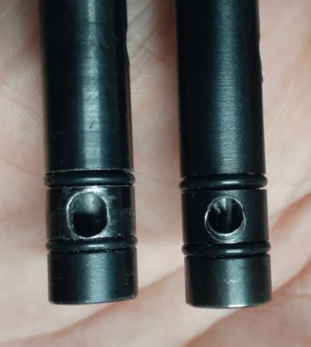

I was thinking the "Big 3"
Plenum 10cc
Transfer and barrel port
OEM valve port and light spring
Mine has the AE Swede plenum, and the factory reg is set at like 1600psi I think. Like Heavy-Impact suggests, I just used light weight slugs to get the speed I wanted without pushing things too hard. I would try some Nielsen 17.5g or some of the lighter H&N or the FX slugs before doing any drilling. You might be shocked at how well a mostly stock Avenger does with the tiny slugs. But dont expect it do fling the heavier slugs at fast velocities. While the platform has great power potential, its not going to be able to keep up with the big kids.

You'd be surprised. I've supplied parts to people that have got over 100ft/lbs out of their .25's.... though I will admit that they needed to back it off to 70's and 80's to dial in the accuracy with the OE barrel.
Yeah I kind of wish I had bought a 25 Cal instead because of the power potential. But in 22 Cal the upper limit is much lower, and the barrel twist isnt quite good enough for the heavy slugs.
The 1:18 twist should be fine for slugs, it's the odd choke in the OE barrels that's the problem.
I make LW barrels for the Avenger / Avenge X that have a 1:17.7 twist and no choke and they stabilize slugs just fine. Customers have been shooting 40 and 50 grain slugs (.25 cal again) accurately.
