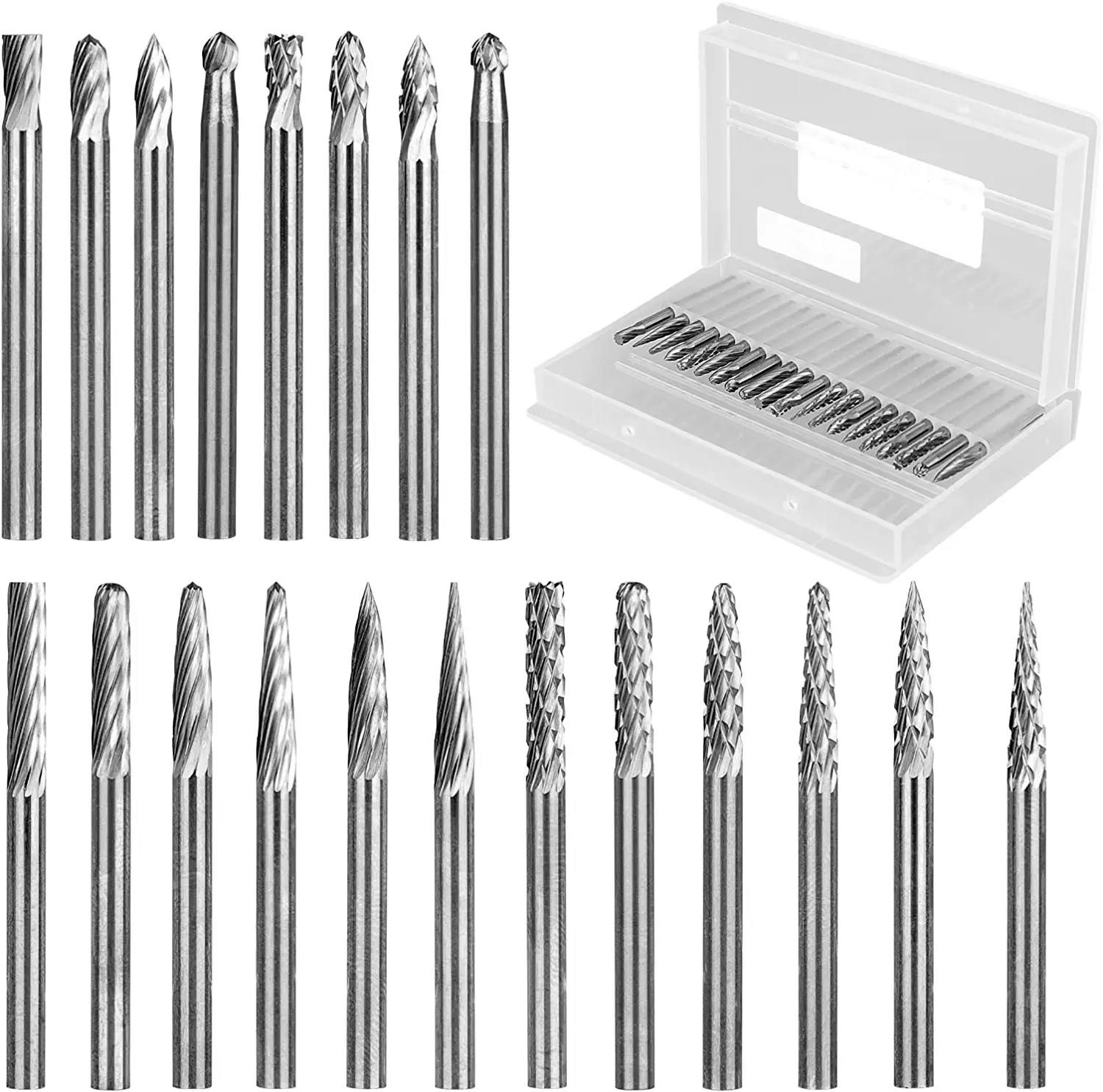

x2 on the carbide burrs for shaping operations like the oval barrel port. I’ve used files enough to wear out quite a few so I’m no stranger to filing, but $10 erases the drudgery of tasks like this.
Upvote 0
I recommend buying a single cut set with coarser teeth if you have experience cutting metal with a rotary tool. They don't load up and they cut faster. It's good to have 1/8" and 1/4".x2 on the carbide burrs for shaping operations like the oval barrel port. I’ve used files enough to wear out quite a few so I’m no stranger to filing, but $10 erases the drudgery of tasks like this.

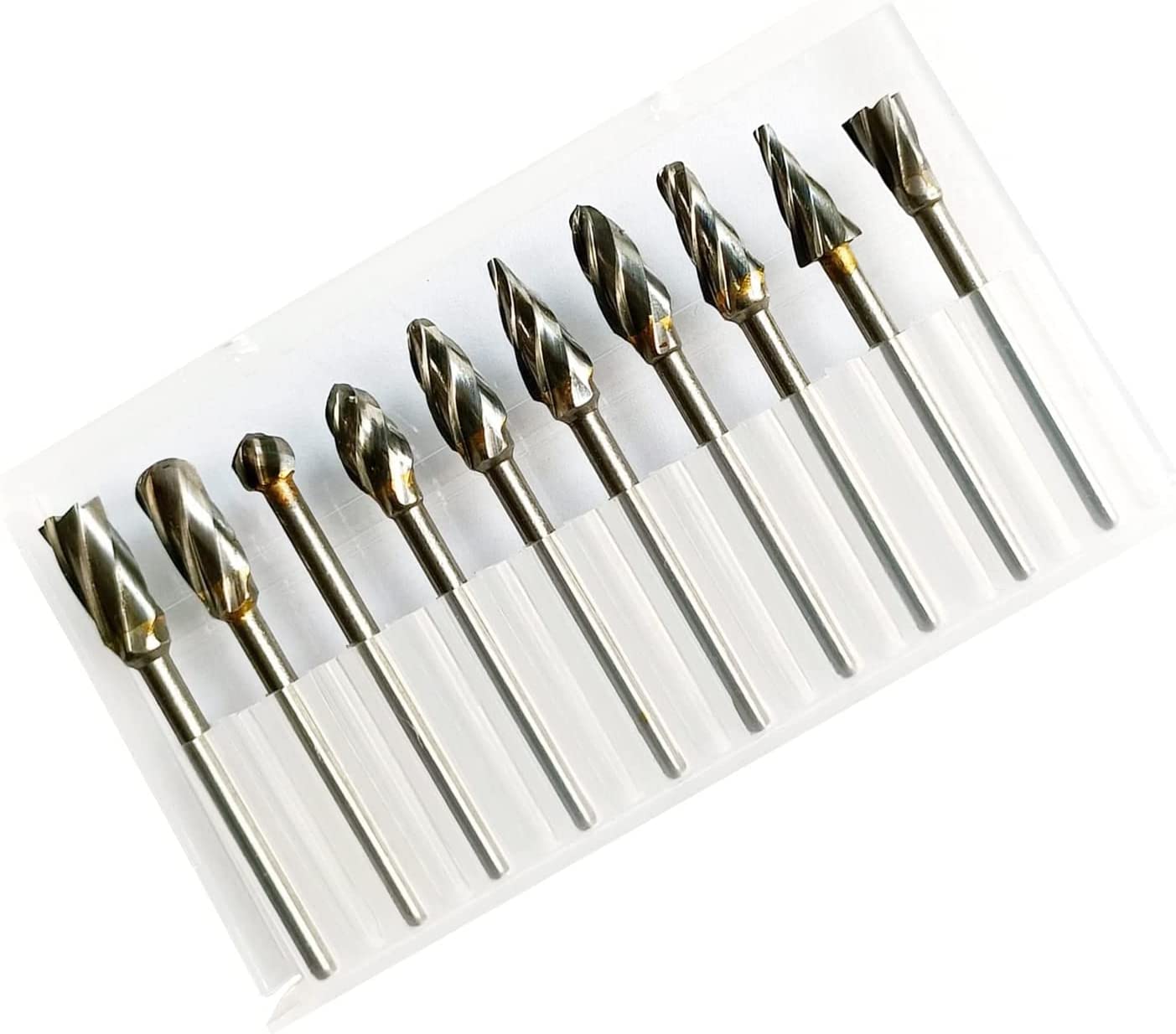

Those big single cut ones in the pic here are for aluminum so just be careful which you buy. The ones for steel have much smaller flutes.I recommend buying a single cut set with coarser teeth if you have experience cutting metal with a rotary tool. They don't load up and they cut faster. It's good to have 1/8" and 1/4".
They're still relatively small and well suited for steel also. They just don't load up with aluminum as easy. I did say "if you have experience cutting metal with a rotary tool." I have more than 40 years experience and prefer the faster cut and non loading attributes.Those big single cut ones in the pic here are for aluminum so just be careful which you buy. The ones for steel have much smaller flutes.

Carbide burr set
