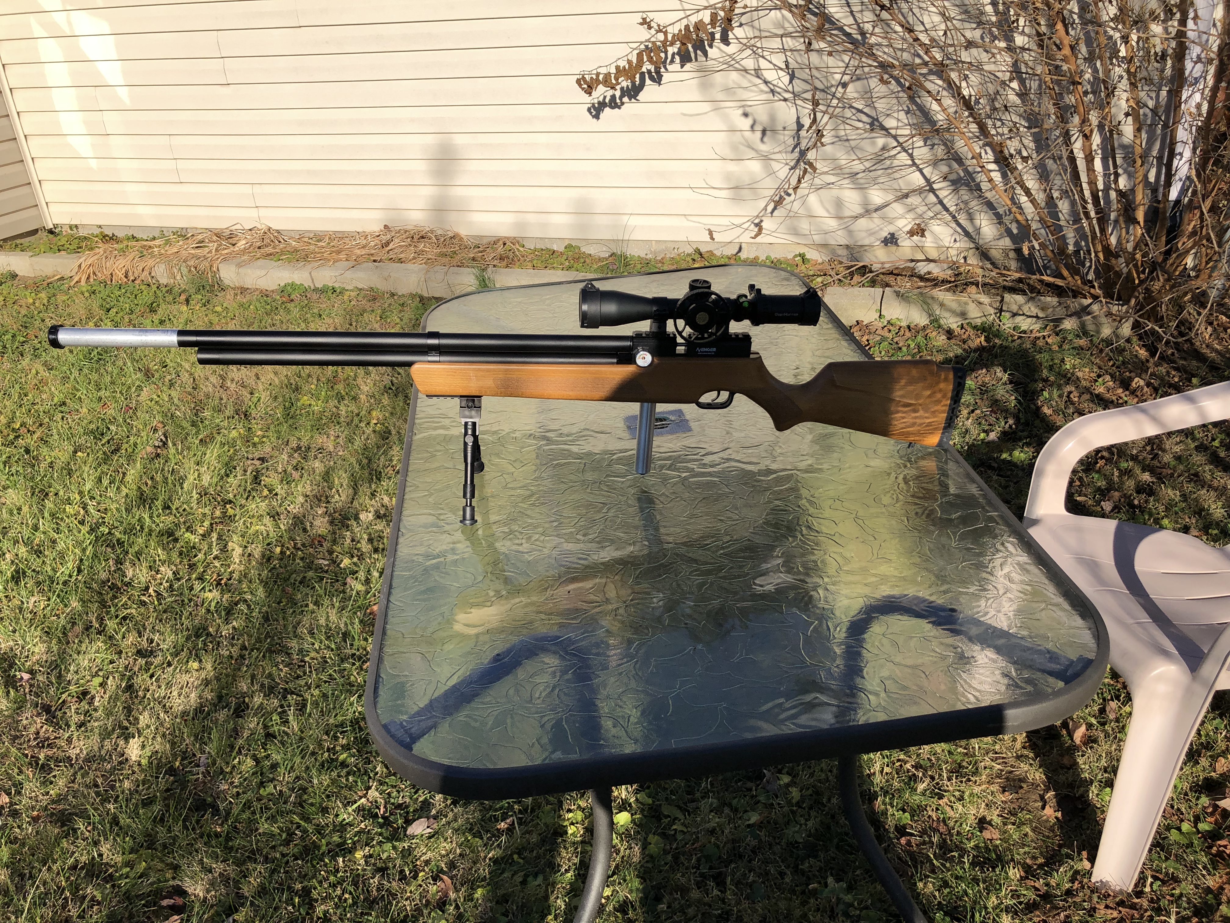

I also made the LDC I made fish bone stile 2 peace baffle system I put a spring in the center between the two so I have an expansion chamber it’s made a big difference. I still have to paint it.

Dude I have to give you props that stuff is very time consuming. I’m making mine because I want the experience of making it, but I would have no problem buying one. My Avenger came under powered so I’m doing this so I can push pellets and slugs at their optimal speeds. At the most I could push the 25.39s at 913 fps now without maxing it out I’m getting 967 fps and I noticed the standard deviation was much lower.

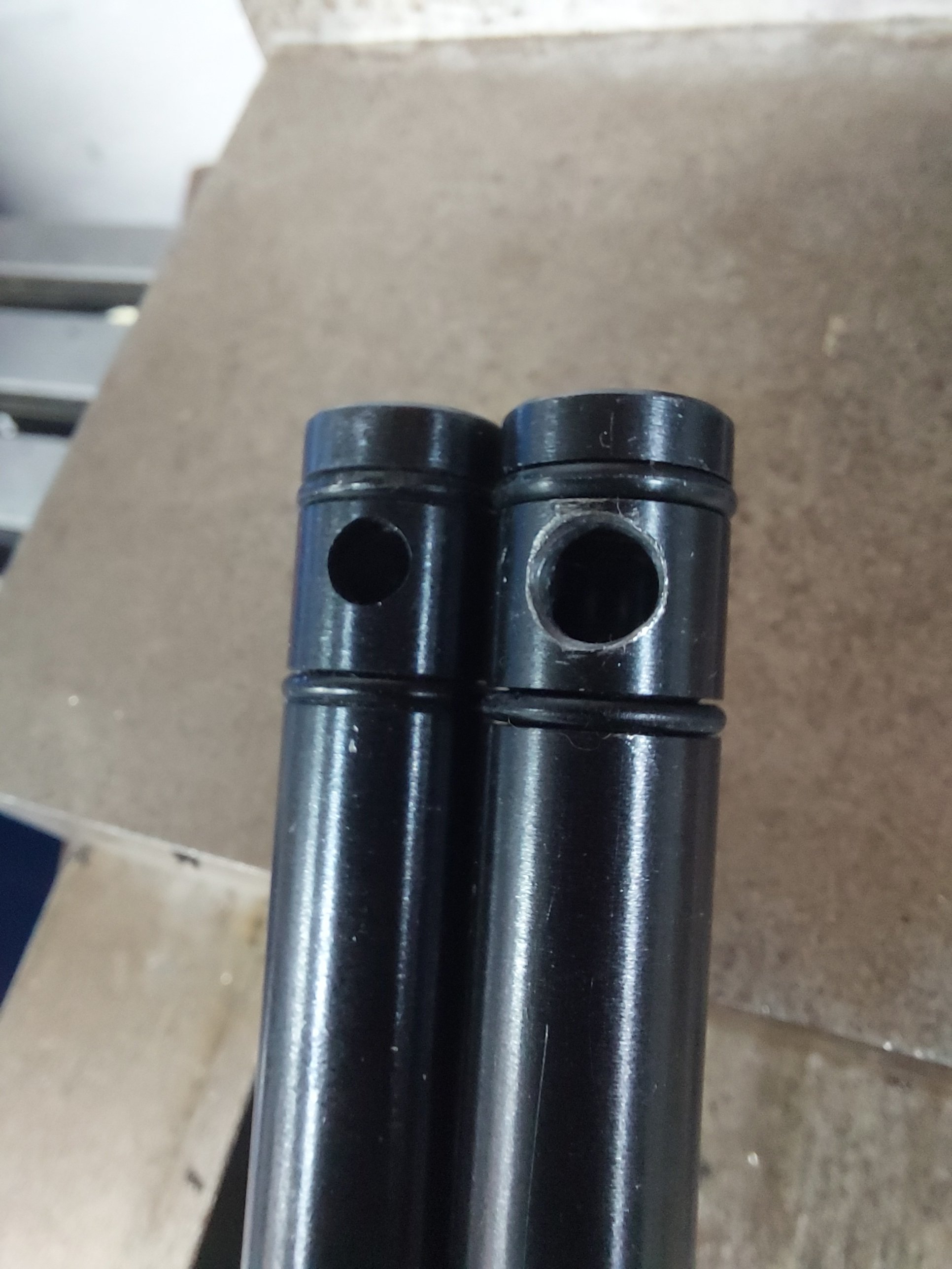

There's plenty of other restrictions to be taken care of to let these rifles breath better. The barrel port is one of the biggest.
Original .22 port next to 5mm with beveled edges.
My thoughts are that if there's only one mod you going to do to this rifle, then the barrel port is it.
While I agree that it helps I actually think the lighter valve spring along with opening up the valve itself helped the most. It was one of the last things I did to my .25 avenger and it had a big impact. I actually put too light of a spring and needed a bit heavier one trimmed down a touch to work better. On my gun I ported the transfer port along with the barrel port and upgraded to the 16cc power plenum ( which is nicely made btw) and it gained roughly 10 FPE which was nice. Now it wasn't until I changed the spring and ported the valve that I gained another 15-20 FPE. The gun has maxed out at 83 FPE using the 43.2 Seneca/run jin pellets. And that there is the catch. This gun is a "pellet gun". With the lighter 34 grain jsb and 20 different slugs it doesn't go much over low 70's FPE. I have found that the barrel is holding back this gun I believe. To really use this new power you have to shoot the pellets a little too fast or hunt for a slug that will work which it seems none of them can rival a JSB pellet due to the barrel design. This is why I have a TJ barrel on order so I can max this gun out with slugs. The TJ barrel "should" increase speeds alot I believe as it is a non choked barrel and will be about 3" longer. I believe I will be able to reach over 85 FPE after that.. hopefully with something other than pellets.

That's good to know. I was hoping to get to 80+ft/lbs and now I know it's achievable. I don't know how big you went with the valve / poppet but I'll be going 7mm (5.9mm being the max with the OE poppet) with a new peek poppet to match. I'll also be using the 25cc plemum.

Yes I went to 5.9mm with the stock poppet. I would be interested to see the results of a custom poppet and 7mm port. Though I wonder if the transfer and barrel port will be able to flow the same. I believe 90 FPE may be achievable however it's possible a heavier hammer may be needed. Just speculation though.
