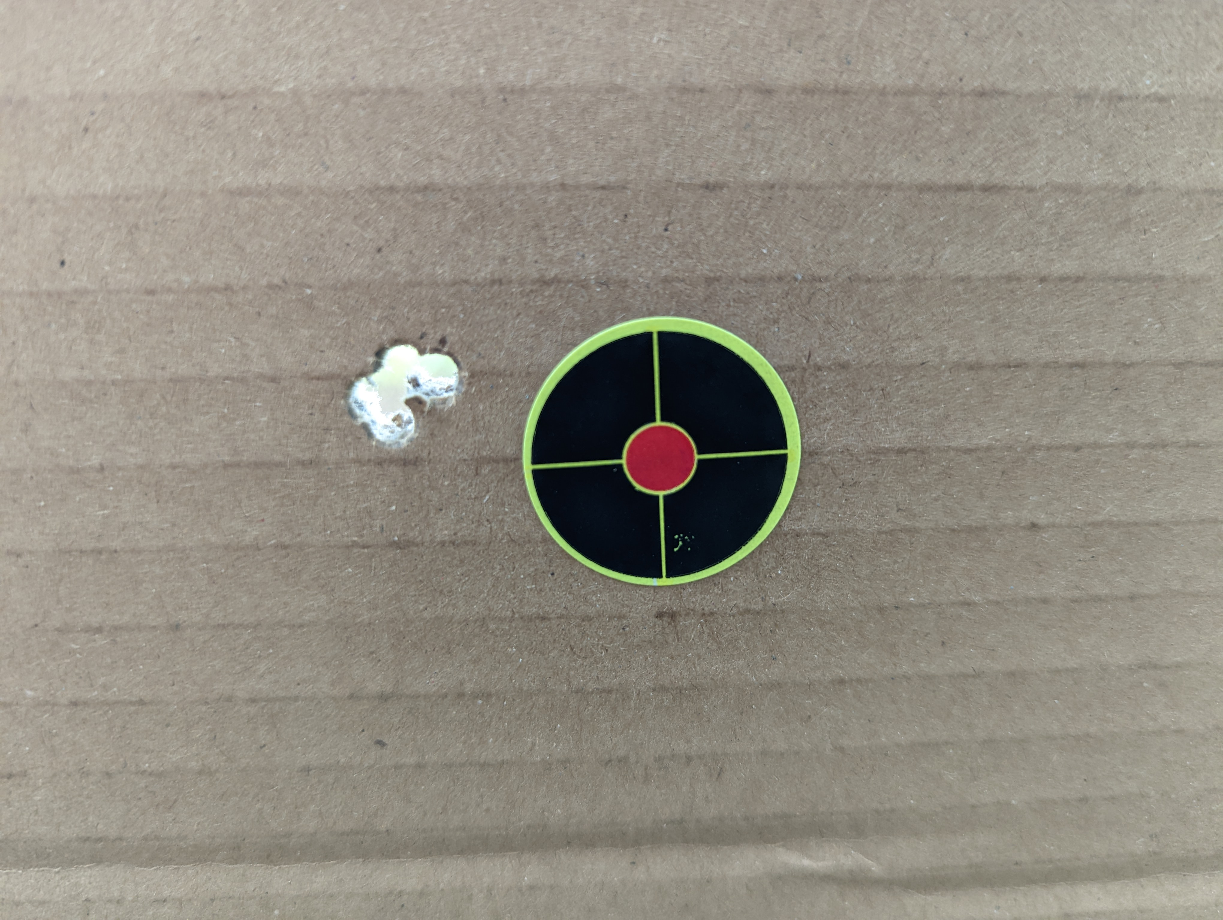

The very first 5 shot group I shot with mine after installing it. 51 yards 17.5 NSA 2.165" 950 fps 24" barrel nothing else modified.

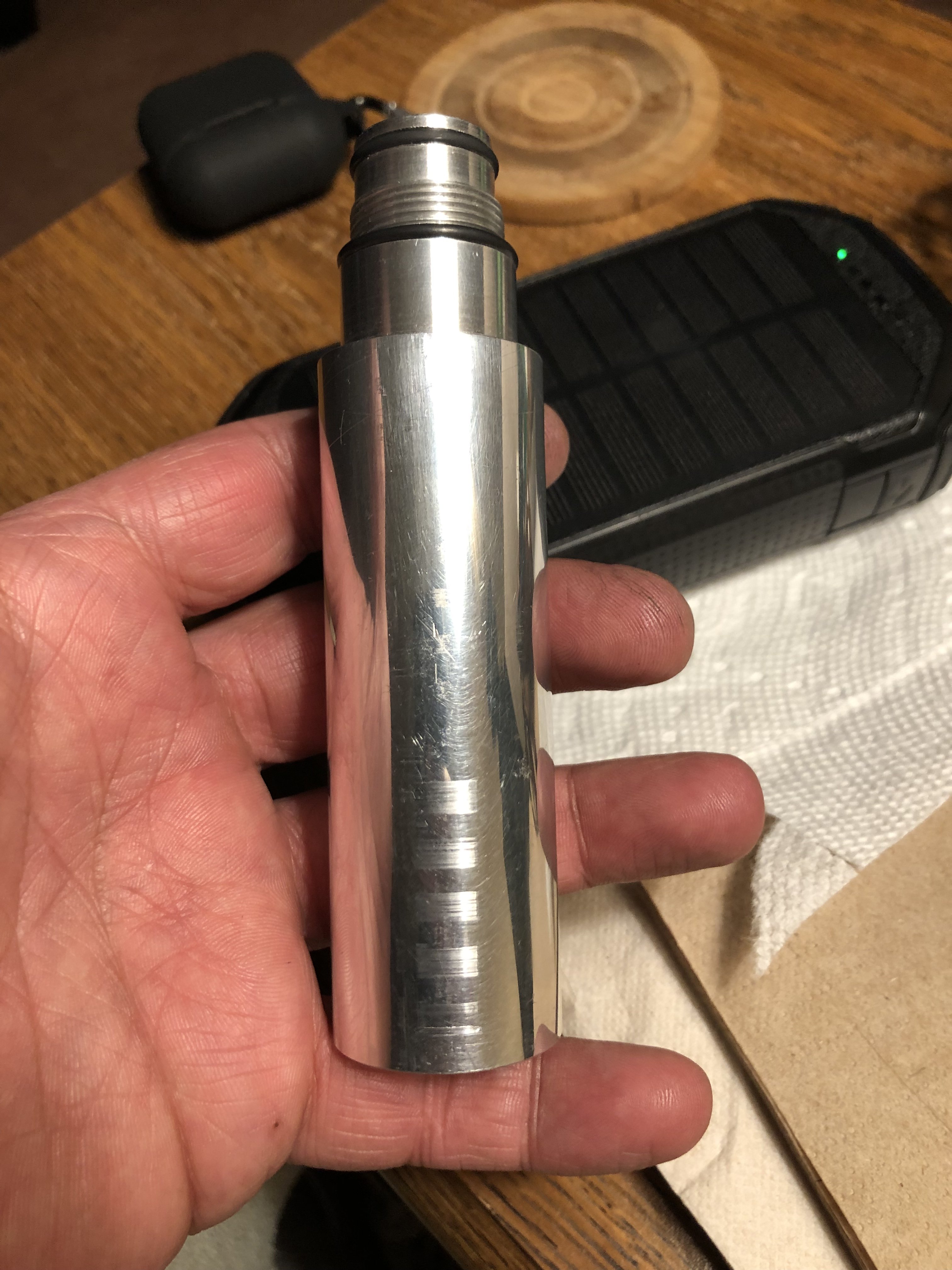

I use 7075 and 1-1/4" for my 25cc plenums. 3/4" for the initial main volume bore then counter bore with a HSS tool I made. Rounded on the back side that comes up towards the plug and pointed on the leading edge. I cut bevels in the front side of the bores to lead into the smaller bores. You do have to be careful on how thin you get the walls.
I do all this in the lathe.

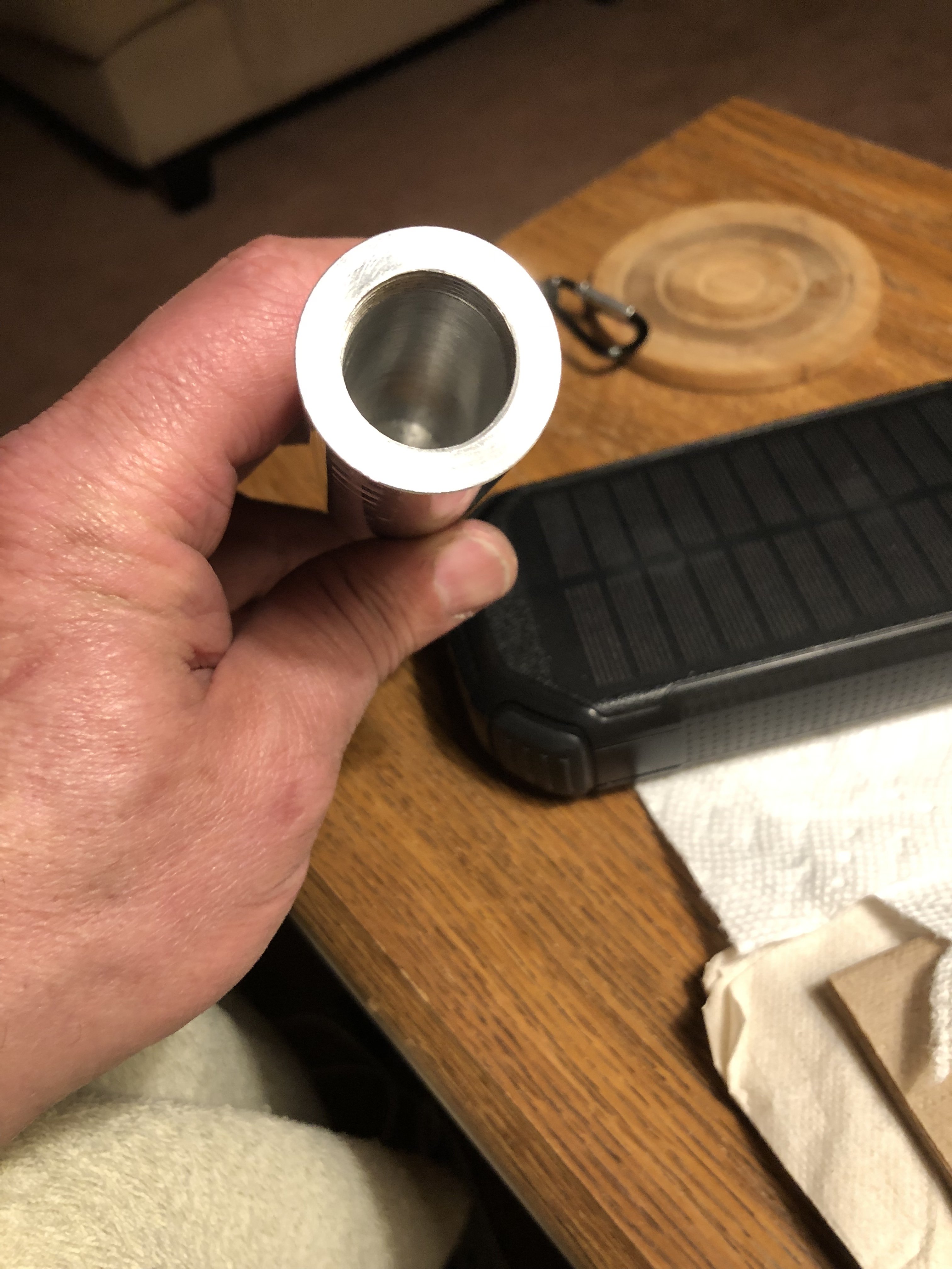

I got most of it done I haven’t done my Final Cut on the internal bore yet but I got the rest done. The long one was just for testing to make sure the ends sealed properly and it worked great. I also used 7075 and 1 1/4 shaft stock the total length of the part is 4 1/4 long.
You only need the first seal on the internal neck but if the outer one works for you then 👍 That thing will be huge when you bore it out! Definitely need to open up your ports and valve to fully take advantage of it.
