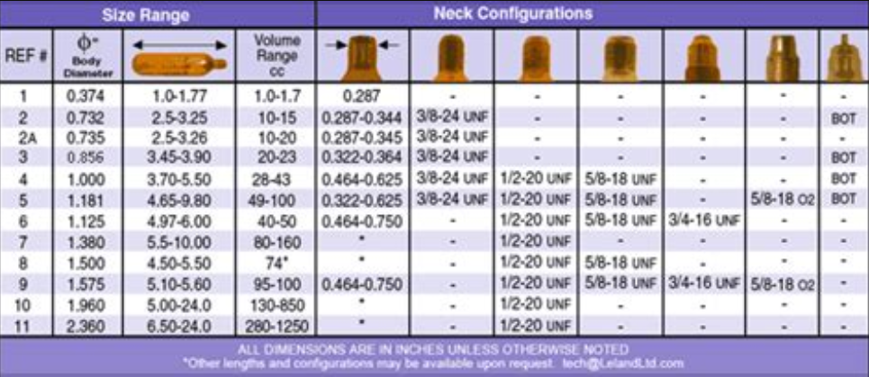

Has anyone considered using a threaded disposable C02 cylinder as a plenum to save some time? You'd just need to make a bushing to fit.

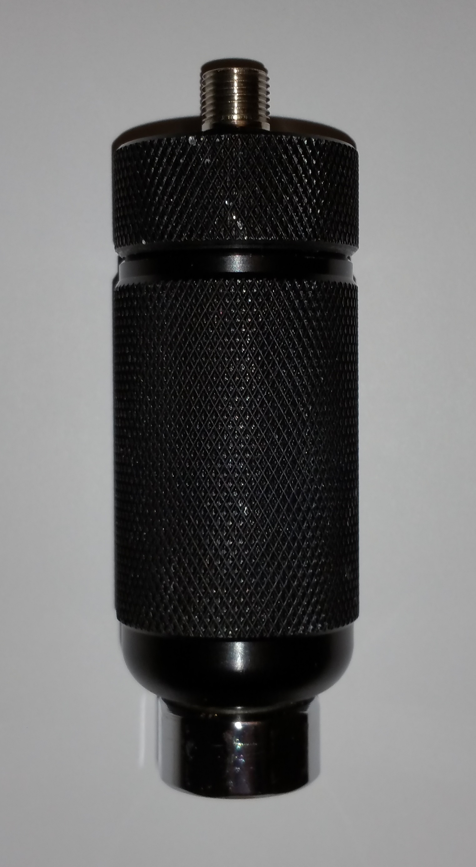

Or you can use an inline filter housing and a close nipple. I believe I was first to do that on an impact before designing a larger one. You can put an air bleed in the bottom rather than a gauge. This one came from my first Yong Heng compressor.

That's good to know. I was hoping to get to 80+ft/lbs and now I know it's achievable. I don't know how big you went with the valve / poppet but I'll be going 7mm (5.9mm being the max with the OE poppet) with a new peek poppet to match. I'll also be using the 25cc plemum.

Glad you like the plemum 👍
An inline filter housing is a pretty good idea. The CO2 bulb though 🤔 I don't think it's capable of taking 3000psi is it?
I doubt it's rated for it but they're seamless hydroformed steel and should be capable. Better safe than sorry though, I just remembered c02 is stored as liquid and the pressure is much lower. I can't find any test info.

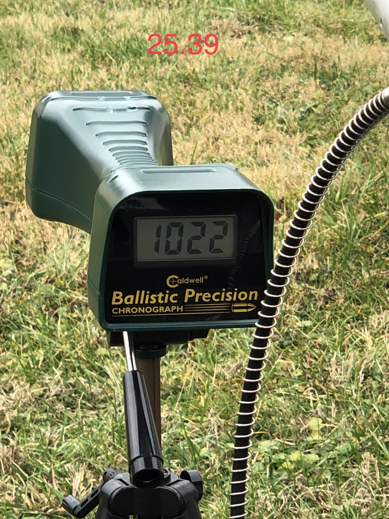

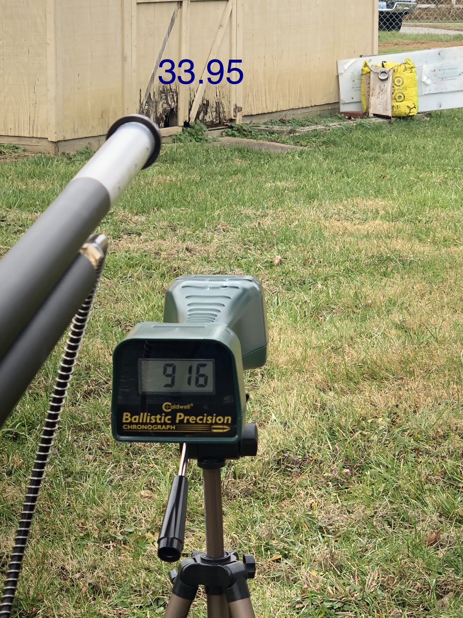

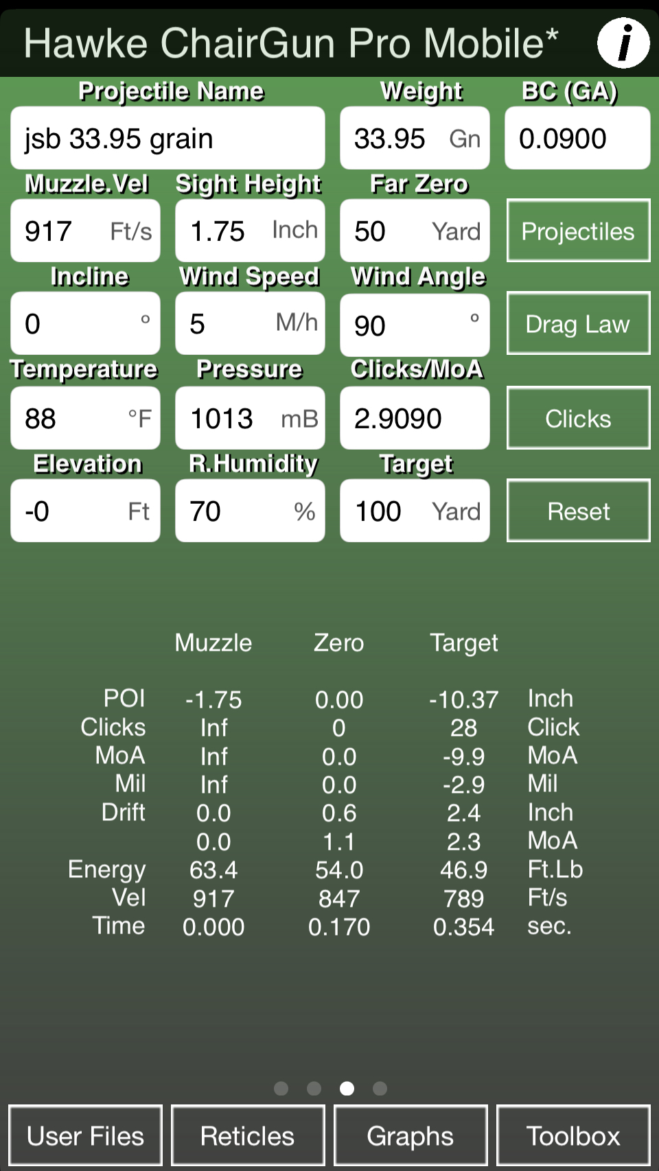

I’m really surprised at how powerful it has become and I’m not even pushing it. Today I shot the 25.39 and with the regulator set at only 2100 I got 1022. The mods have really increased the power and efficiency I got several duplicate velocities. At the same regulator settings the 33.95 got 917 FPS That’s 63.4 fpe ! This is what I was aiming for being able to push The pellets and slugs to the optimal fps and not having to max out the rifle to get there. The groups for the 33.95s really tightened up when I was able to push them to 900 FPS.
