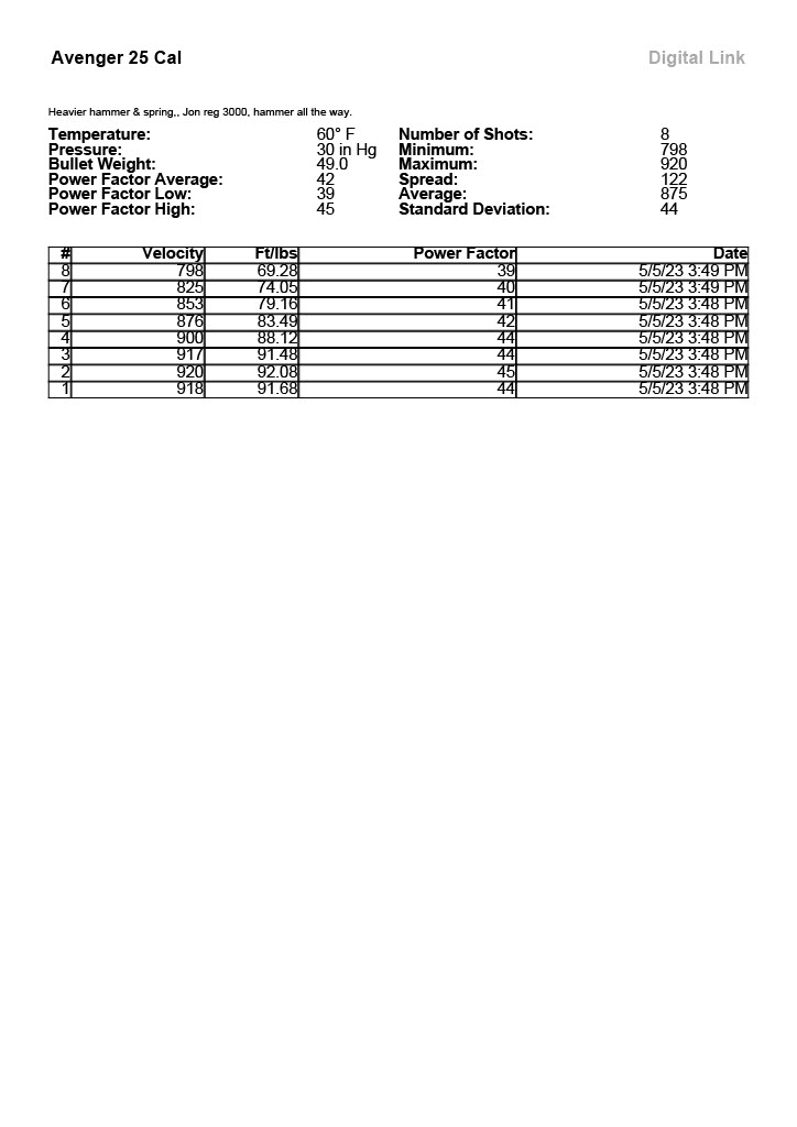

I do this work if you dont feel confident enough. I drill the transfer port to 1/4" which removes all threads, make a larger (7mm) setscrew fit the lighter spring and enlarge the valve to 5.8mm from 5.4mm to increase air flow. I then put everything back together and pressure test before sending back. $75hr - 2-1/2 hours.
I recently did this work in a .25 action and with a 16cc plenum and just a small amount of testing, it's putting out 76ft/lbs right now. We pretty sure there's more in it but he's having add on regulator issues. It's only putting out 2200psi when it should be 3000psi.

The barrel is the first thing to do and if you do only one tuning mod, that should be it. go as large as you dare. .187" is 85% of caliber but I know people who've gone full caliber and not had issues. You could also go to .187 and slot a little.

I have a customer / friend / collaborator, now running a .22 bullpup with a plemum I made for it and he's getting into the 60's fpe, that's also with porting done and a bigger valve / poppet.
I also have another friend / customer / collaborator that's getting into the 100's with his .25. He's the second I've now helped achieve .22LR power.

Numiza Airguns has some videos on YouTube. You'll have to go back through his catalog to find them. He only goes as far as using the OE poppet with a slight larger hole, which still adds power. I go bigger and make bigger poppets plus supply heavier hammer springs for when running high reg pressures with the bigger poppet. You can open up the barrel port a bit with a drill but you can get more with a milling machine because you don't need to run on the hole center. You can also drill the transfer port to 1/4" but you'll also need to make a new set screw as you drill out the threads. I do this also.
