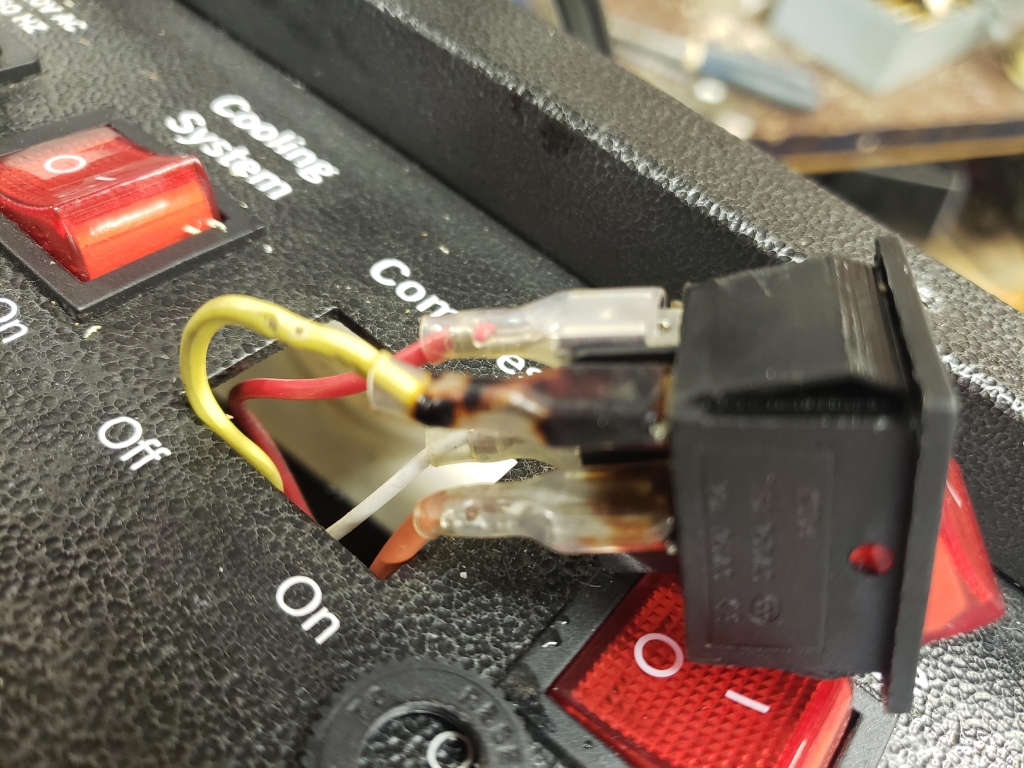

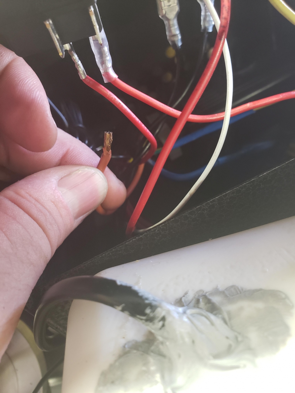

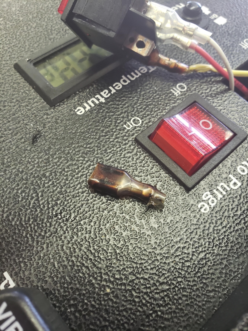

On my Hatsan Lightning(very similar) I had been having electrical issues too. Blowing cb in box and on compressor etc. I changed my plug in receptacle, circuit breaker in my box and on the compressor but still had issues. Hatsan sent me a new power switch and when I went to change it I noticed that a couple of the wires on the switch were burnt and one fell out of the terminal. I replaced those terminals and switch and it works great now. I figure it must have been loose connection issues.
So i would check the wire connections and switches. The AV switches are the same as on my Hatsan and they are cheap from Pyramid Air so bought extras to have just in case.
My Tux is on it's last legs. So I ordered one of the AV's. Randy I had to replace the power inlet, the power switch, I replaced the wire between the 2 with 14 gauge wire.Those wire connectors are garbage. I bought the 20amp/600v rated ones at work no more issues there. The power switch just quit again! They are rated @10amps and we are drawing right at 15. I will end up doing all this all over with the AV, it's a brand labeled Tuxing I believe. THIS time. I am going to order what is called MTW wire. It has 5 times the strands and is made for high vibration application like in factories. I am ordering the inlet and power switch also rated 20a/600v
