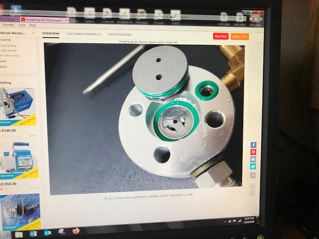

jking- Where did you source the Yong heng rings?(They look like the same I had for my Tuxing) Appreciate all the help both you & Kopfjaeger have given me-

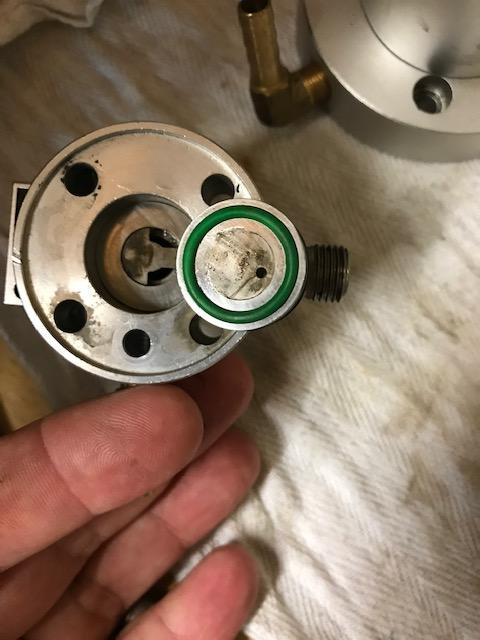

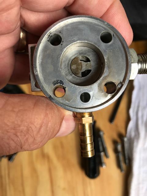

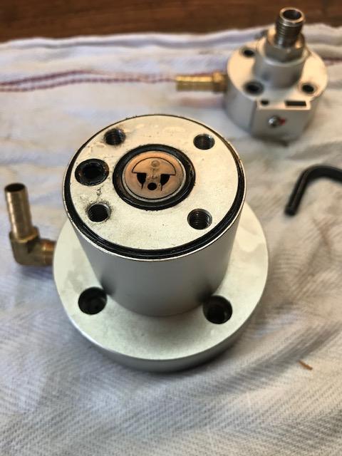

Now I'm REALLY scratching my head- replaced both valve plates & put back together to check while waiting on new rings & now I have ZERO pressure ! WTF! Even with one broken plate & 1 carboned up, I was getting 1500 on line pressure.Got to be major leak somewhere so will tear apart & replace all seals. Any other thoughts?
Thanks, Jimmy- went & re-did & back to 2500 but no more- so now wait for piston rings
