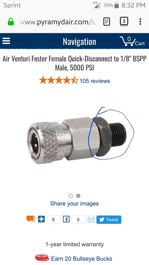

Do any of you guys know where I can order just this part I need ? Can't find it in any hardware stores locally so far. Thanks in advance.
Why don't you just buy a foster with a male BSPP thread? One less joint to leak.

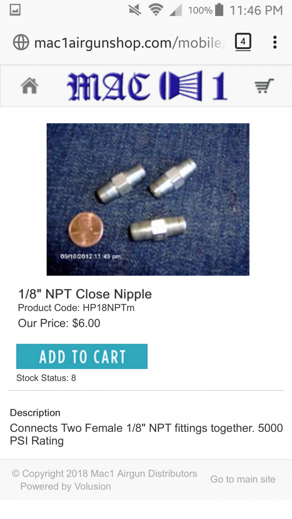

So I need that one part I circled. Is that 1/8npt male to 1/8 npt male or that 1/8 npt male to 1/8 bsp ??
It's 1/8npt male to 1/8 bsp. Why order a pricey difficult to find adapter instead of following Eaglebeak's suggestion and buy the fitting with the adapter built in already? One less joint to leak and it's cheaper than the adapter alone. Plus you'll need a dowty seal between the Foster fitting and this adapter for an air seal. If you need a 1/8 bsp thread on your Foster BenGunn's 1/8 npt fitting link won't work for you. Another solution would be to just buy another microbore fill hose that doesn't terminate in a female bsp fitting as you have. You can buy an entire 36" microbore hose with Foster quick disconnect from Aliexpress for under $12 shipped which is cheaper than that adapter alone.
