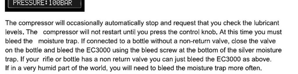

Here is something from page 8 of the Hill manual:
Wish Hill had provided an explanation of why the unit would do something like this. Their English English is confusing to me at times.
Perhaps your unit has got this mixed up with the high temp cutoff procedure.
