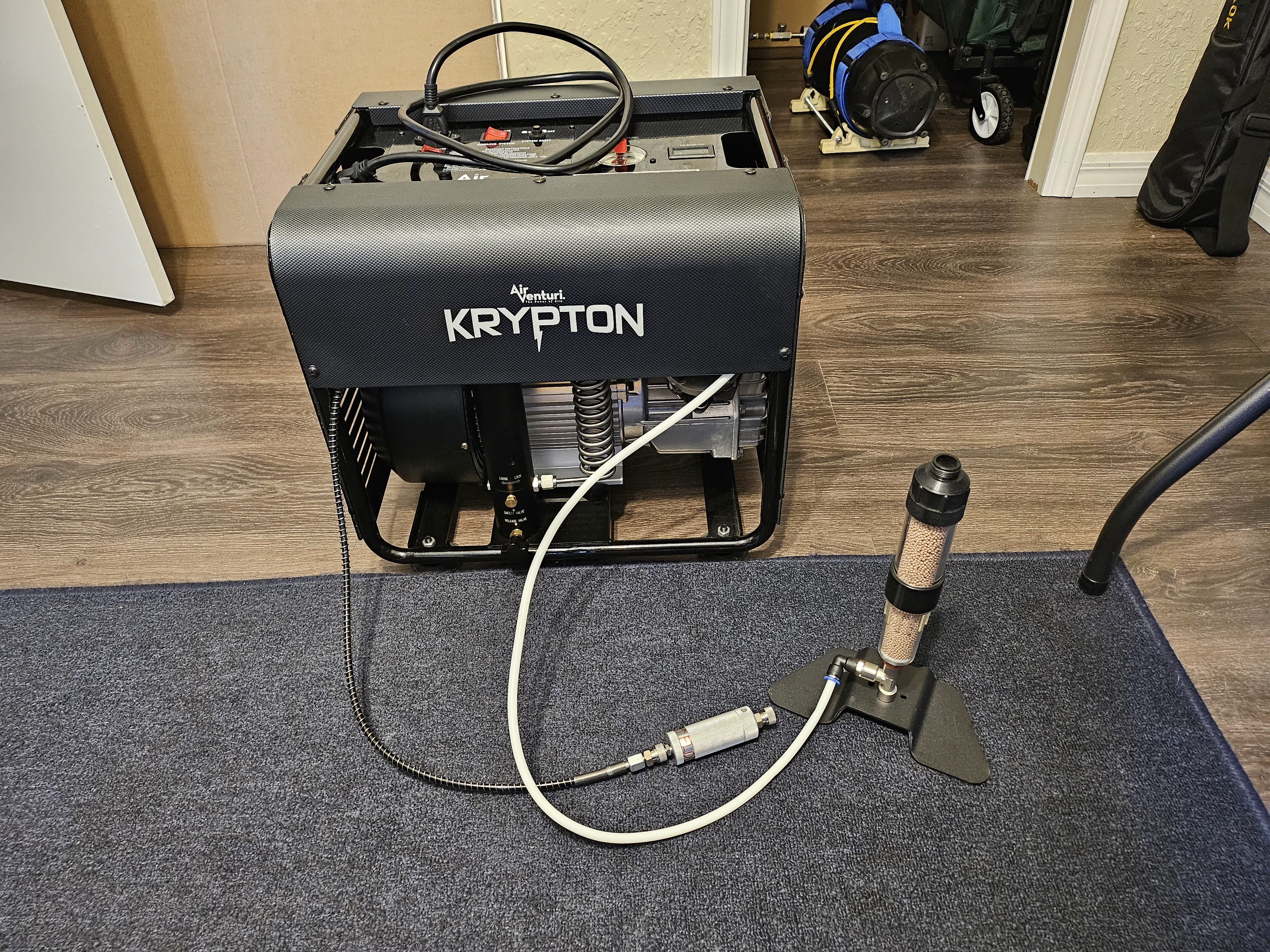

So far this new machine is working flawlessly...I just have to remember to close the pressure relief valve before starting a fill. I filled all four of my scba tanks and it didn't miss a beat. As a matter of fact, just a few minutes ago I just received a package from UPS with the "Air Venturi Dry Air Intake Filter For Air Venturi 4500 psi Compressor"...it removes the moisture from the air going into the compressor...I forgot to order when I ordered the machine.
I will keep you guys posted on the performance of my new Krypton as time goes by...my only regret is waiting so long to finally get my own compressor so I don't have to drive clear across town and back to get my tanks filled...I hated having to do that. Its especially important if you work on your own guns or work on guns for friends like I do, because you go through a lot of air when doing so.

Ok, I just got my new Air Venturi Dry Air Intake Filter installed - the directions say to replace the dessicant every 6 hours depending on humidity levels in your area...so I went to Pyramyd and found the dessicant replacement packages cost over $7.00 each...:unsure: so I went on Google and found dry air dessicant beads for far less money! As a matter of fact I found one brand of silica gel beads that can be regenerated by placing them in the oven at 250 degrees for 2 hours, or in the microwave oven for 10 minutes on the "Defrost" setting...and there are many other brands of silica gel beads for sale in bulk for way less than those little packages from Pyramyd...:cool:
Chuckster, that air intake filter using tan beads is a total marketing joke. You were smart to figure out that tan desiccant media beads aren't best in air intakes. They are designed to remove residual moisture under extreme pressure. They last much longer if there is a water separator tower before the compressed air even enters the final moisture filter in a high end compressor. Silica gel beads are a better substitute for intake filters and the color change feature is a bonus. It only takes around 15 minutes in a toaster oven at 250 degrees to recharge them. Spread the silica beads out in a flat pan one layer deep. Your compressor will probably work just as effectively without an intake filter. It is a Chinese compressor marketing gimmick aimed to sell compressors rather than improve them. Air Venturi compressors don't use the best metallurgy and the components that are exposed to water vapor corrode fairly quickly.
