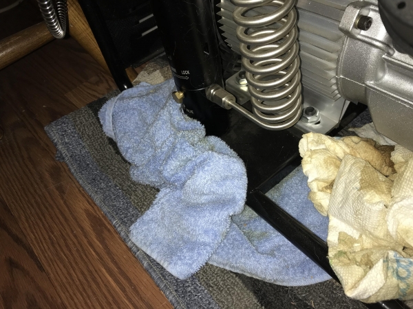

I have a towel around my compressor bleeder valve to catch any water and contaminants that blow out, keeps the mess in the towel not all over the floor.
