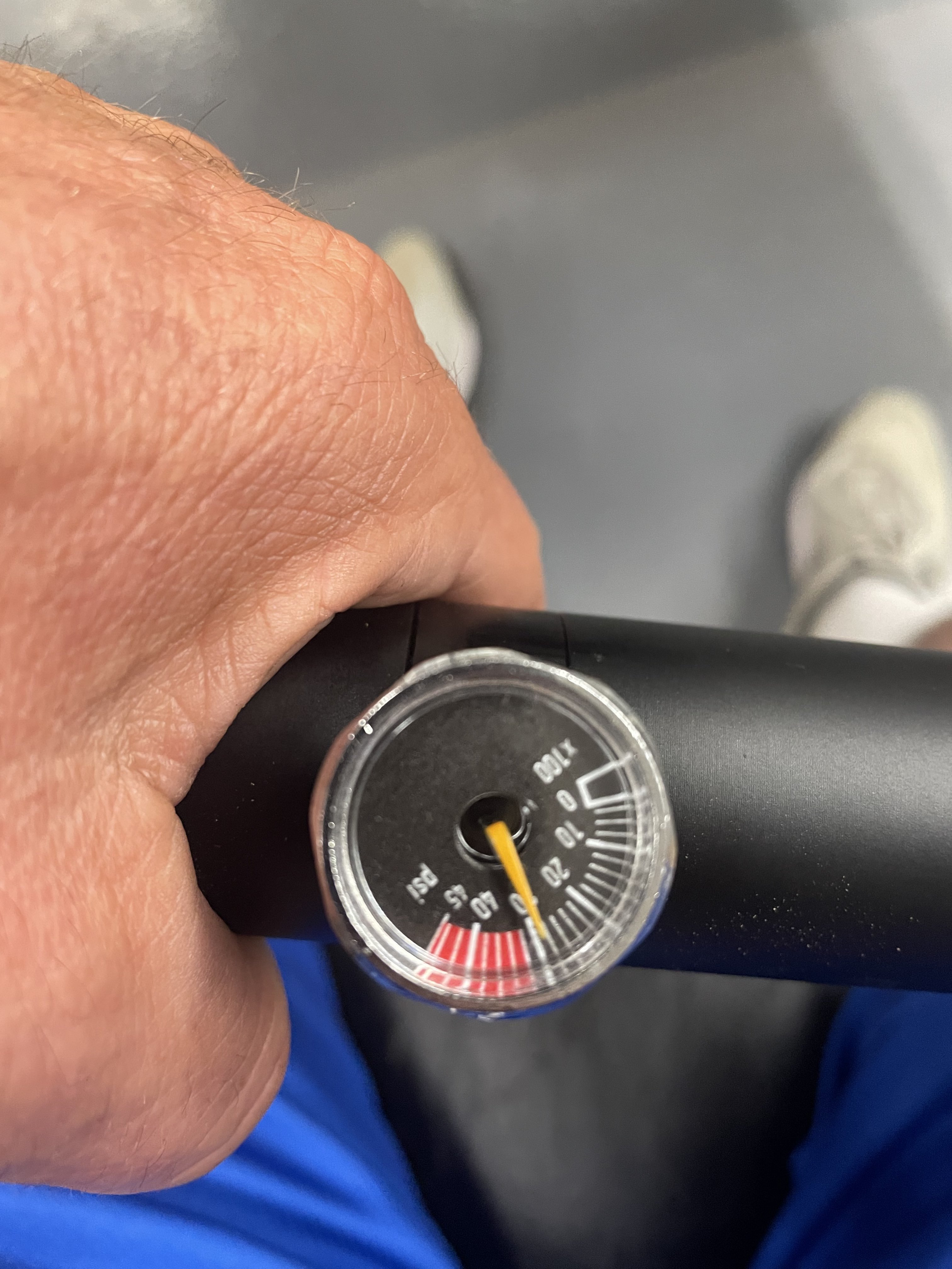

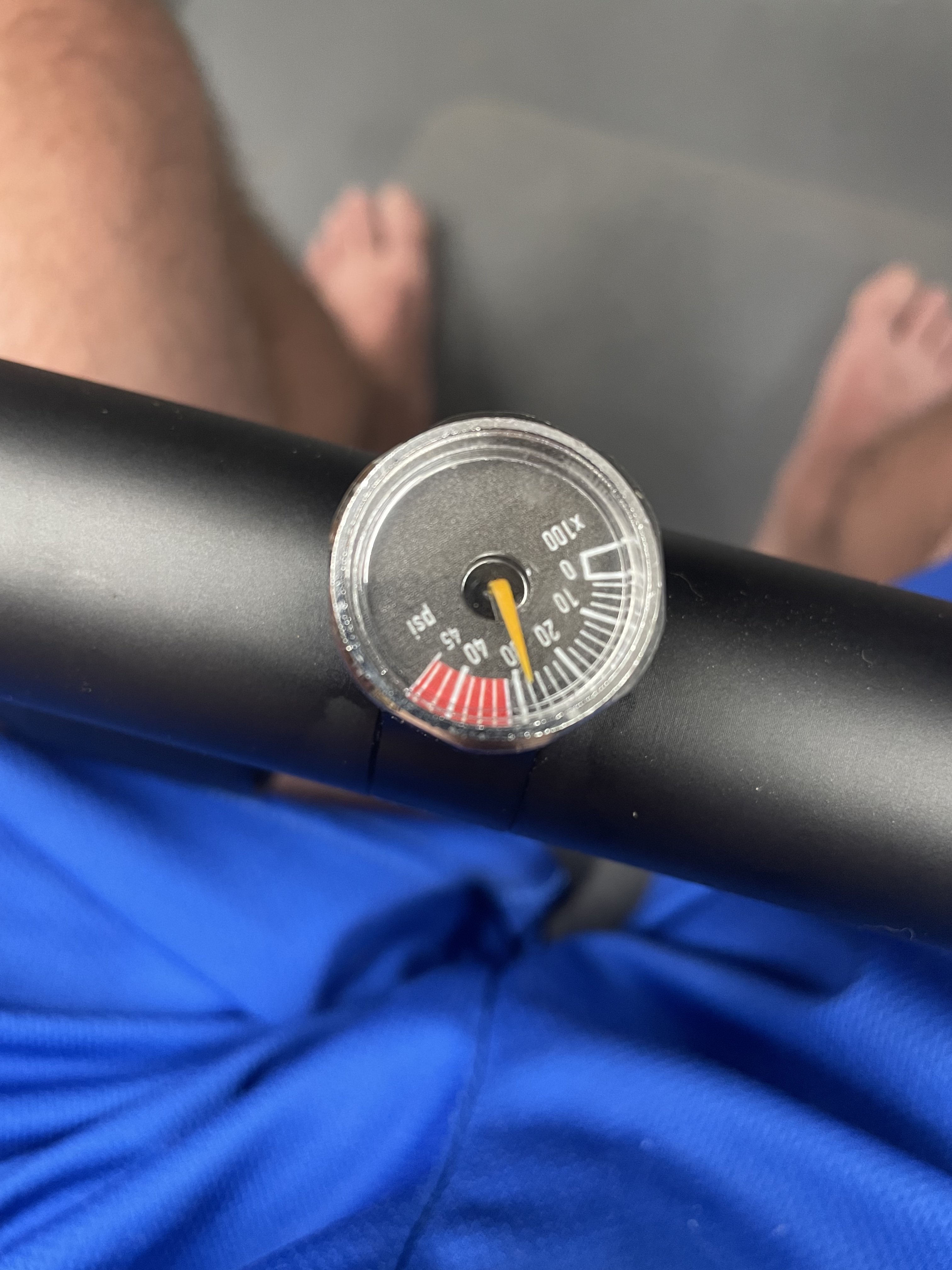

Good afternoon. I have a Airacuda Max .25. Coming up on one year old. I just realized this past weekend that I am slowly losing air pressure when the gun sits. Can anyone steer me in the right directions on what I need to do to get this back to the way it was? I’m only estimating, but, I feel as though I’m losing about 200 psi every eight hours.
