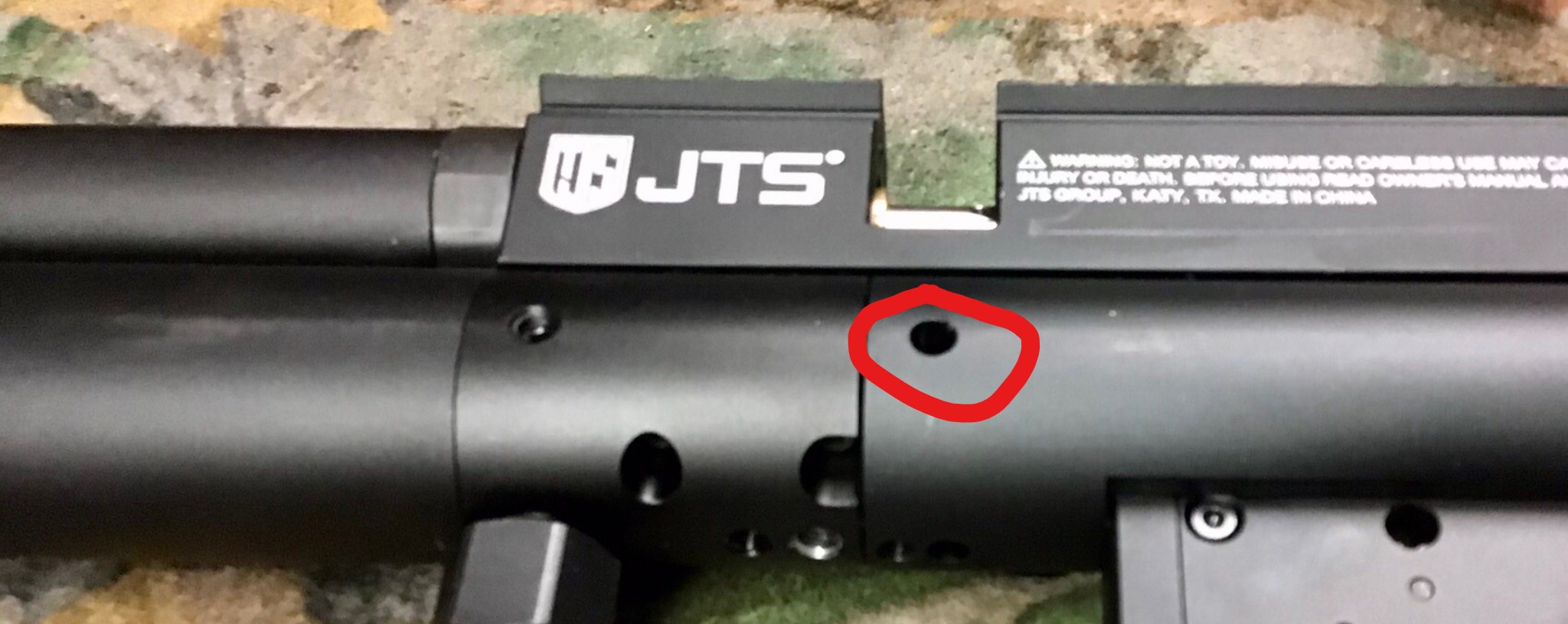

I just wanted you all to know that there is another design problem with this generation of the MAX.
This vent hole allows the hammer to strike the poppet pin, the displaced air escapes through this hole. Well... it WOULD allow the air to escape but the vent hole aligns perfectly with the stock wood buffering the vent air, causing all sorts of issues with consistency and choking speeds from the 860 FPS it shoots when the assembly is out of the stock down to 620 FPS when assembled but the FPS varies so wildly as the stock warms or cools and rises to about 750 FPS.
I went ahead and stuck my thumb over the vent hole and shot a pellet, it dropped to 300 FPS! I took the hammer spring, hammer and guide out to look at the assembly and found that indeed, it's flat walled with no air bypass on the hammer. By this time I was so annoyed that I drilled a hole through the stock, allowing the hammer to vent and allow all of the bleed air to escape.
Had I been of a cooler head, I would have run groves on the sides of the hammer (Travis, this is what needs to be done to the next gen) on the mill to bleed off the air instead.
So, if you have a MAX, you will have to either drill a hole in the stock or mill slots in the hammer to get full use of the hammer or it will be buffered on every shot but you will not know how much buffering you will get...

Once my blocks/spacers come in I believe I will just go ahead and drill hole. Does this hole just need to be as close as I can get to inner air vent? If I’m slightly off will it still be effective? What size hole/ drill bit do u recommend?

Personally .. NO HOLE
Make note on where the hole reside at the stock, how close to top edge of wood etc ...
Using a DREMEL tool and a small round burr take away some wood from the holes area making a shallow channel down to cut away area already there.
EASY PEEZY and you won't see it and more importantly NOT get debris into the vent from outside handling of the rifle !!

Great solution. I will do that I didn’t even think about the debris.

Agreed! Use a burr and make a channel, I was incredibly annoyed after several hours of troubleshooting the issue and drilled the hole to prove the fix. Had I been able to think clearly at the time, I would have made the channel instead.
I don't regret the decision though, I have matching stain so you wouldn't see it unless you were looking and an inlay will hide the hole.

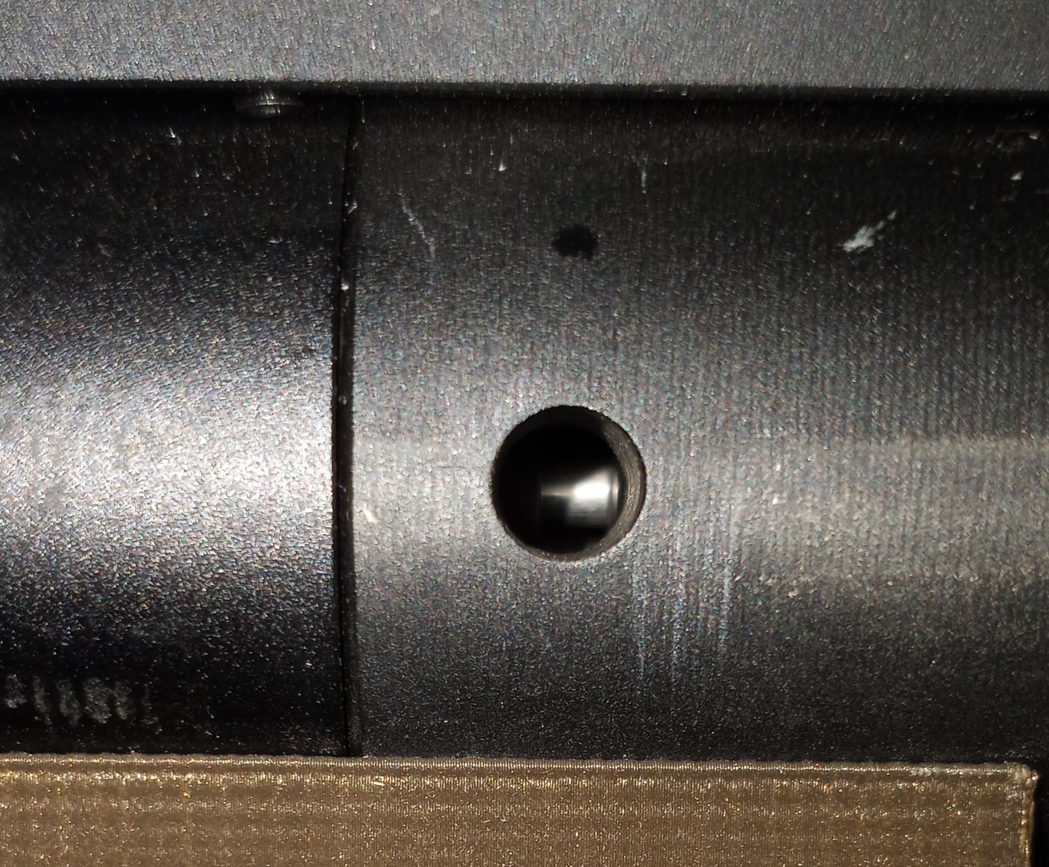

Pulled action out of stock far enough to expose vent hole then placed tape on stock exterior to mark exact location. After fully removing stock and following tape mark down inside stock I saw a light grey circular stain caused by vented air. Dremel tool with small circular stone hollowed around then cut groove to lower stock area. Wiped everything down with oily rag. Repair not visible from outside and vented air should no longer be restricted. WM
