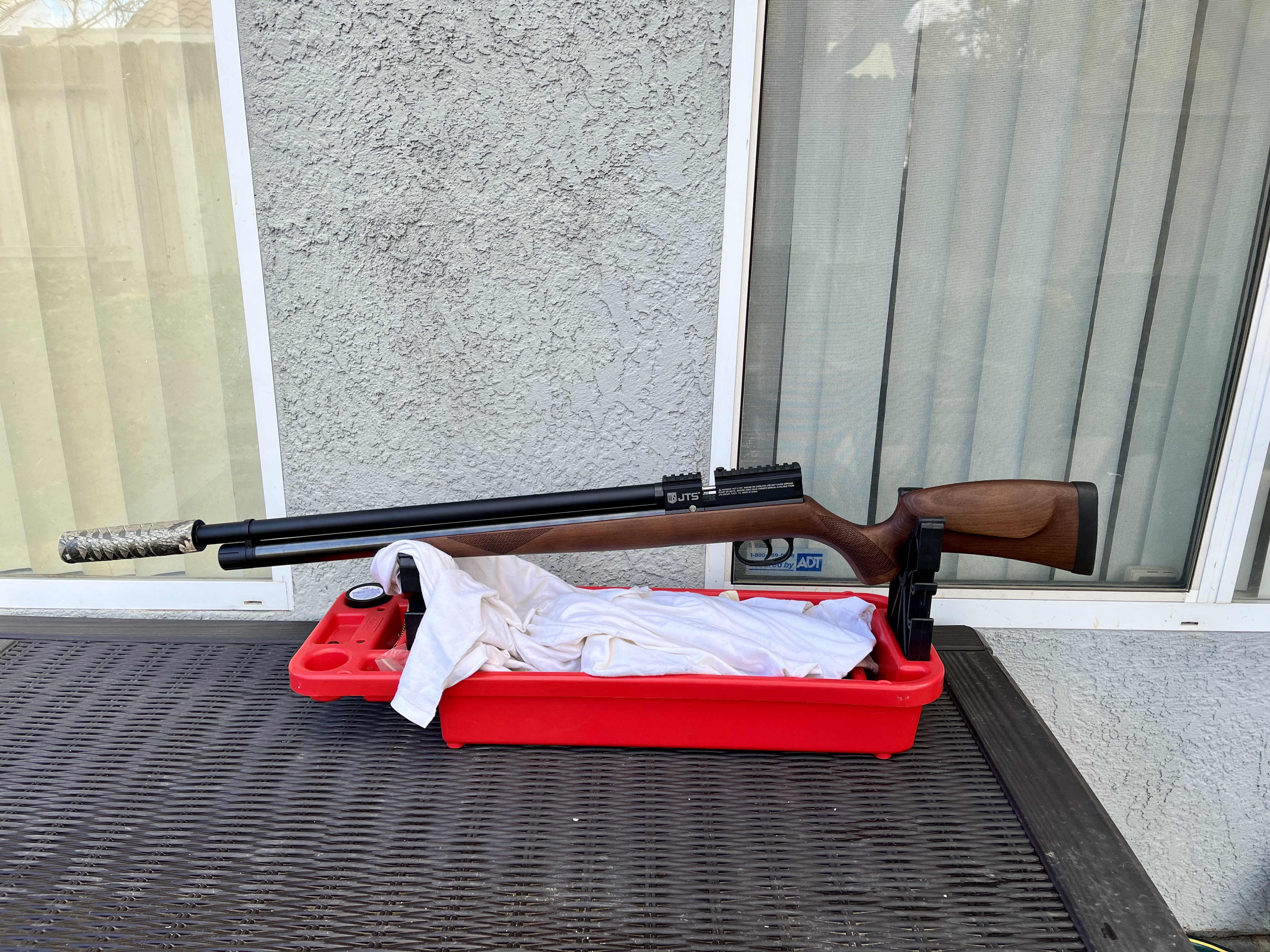

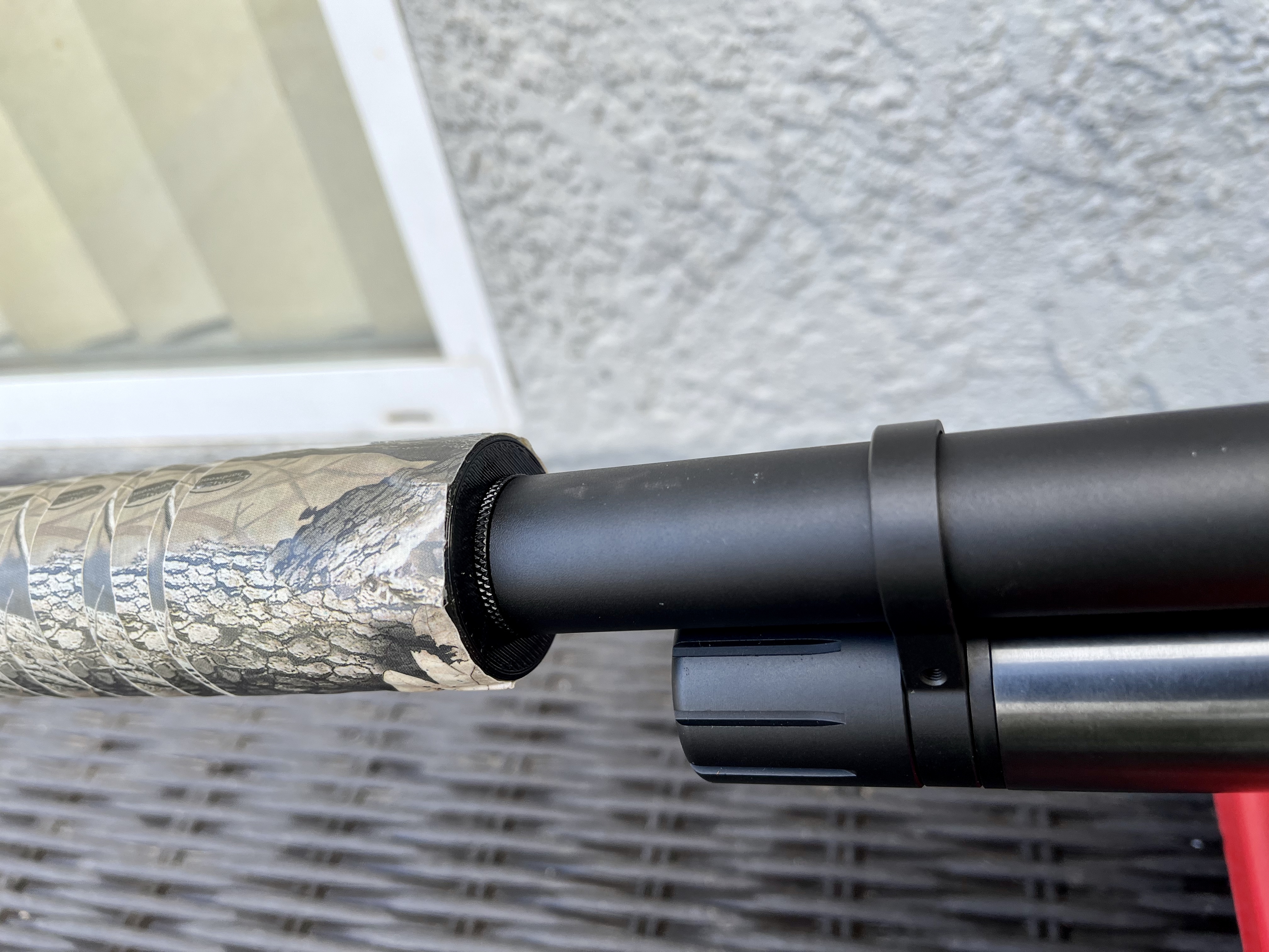

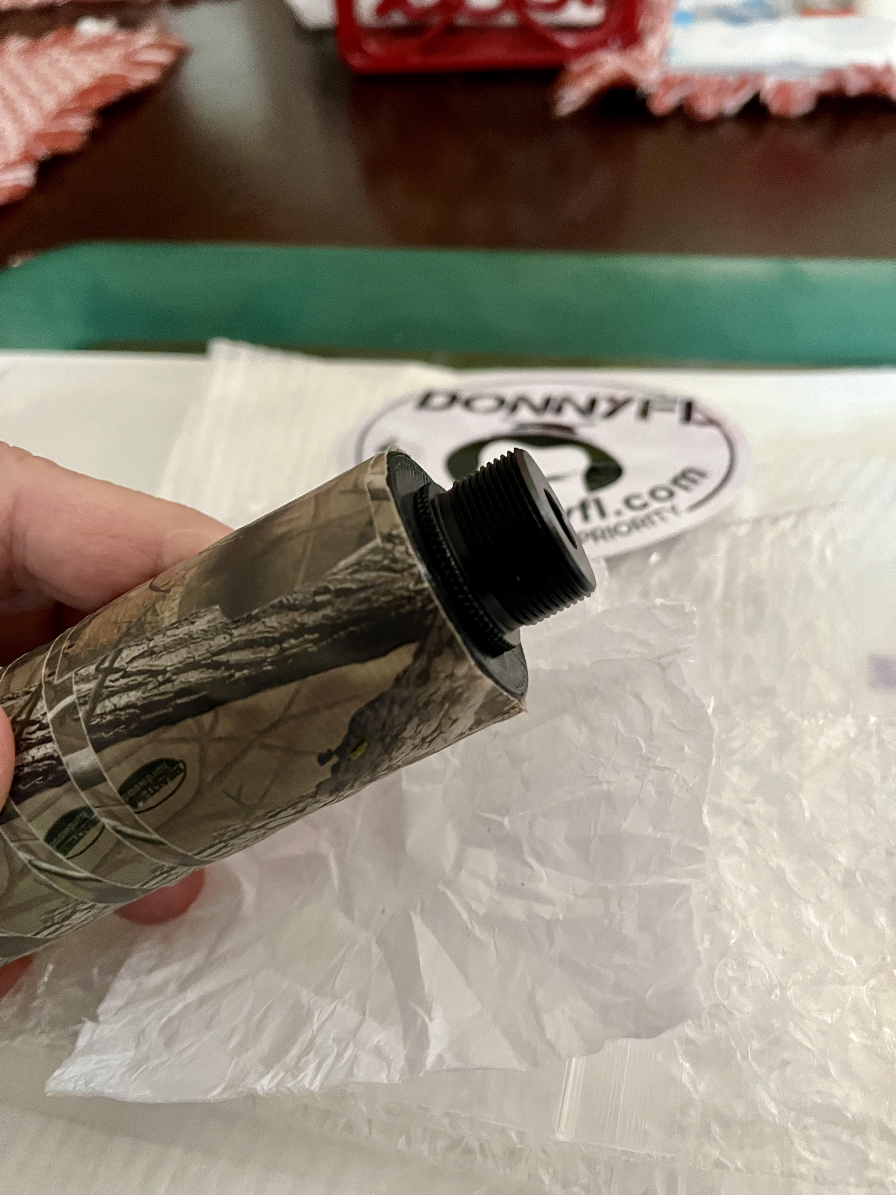

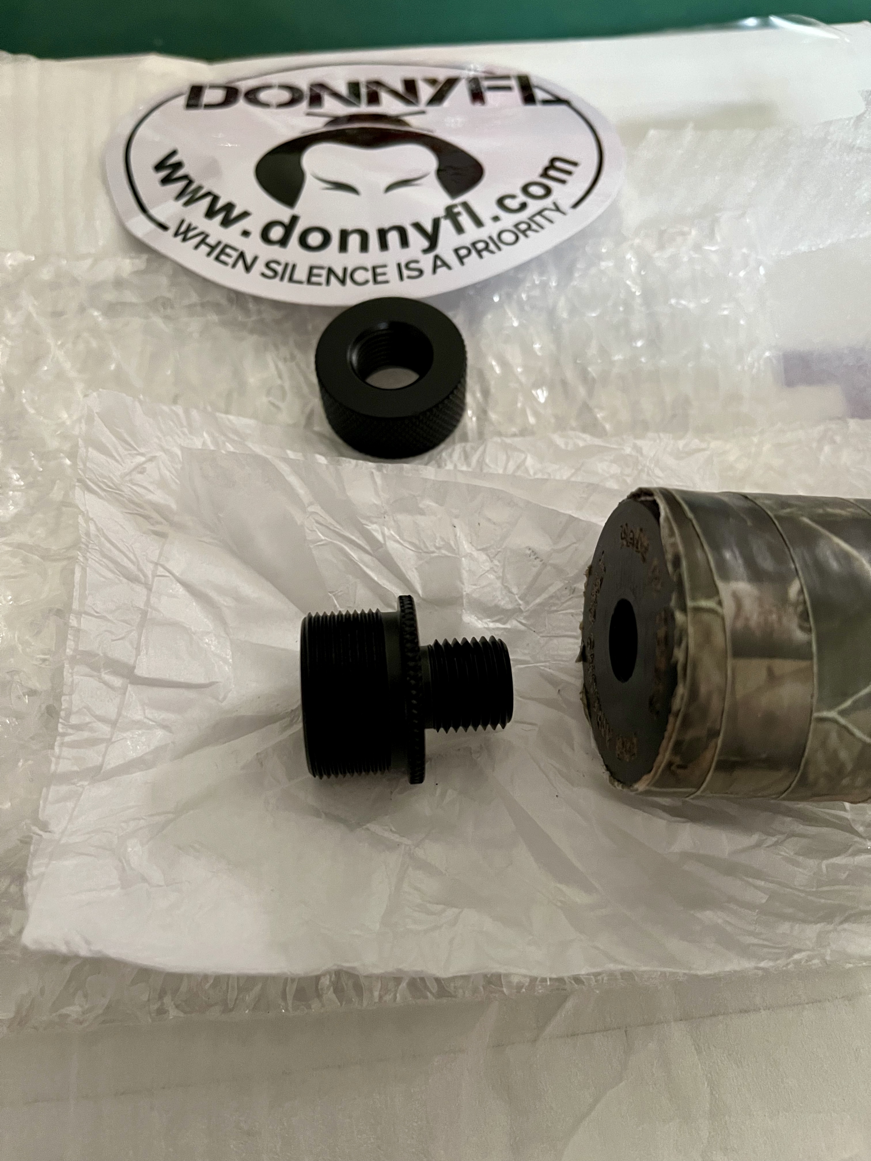

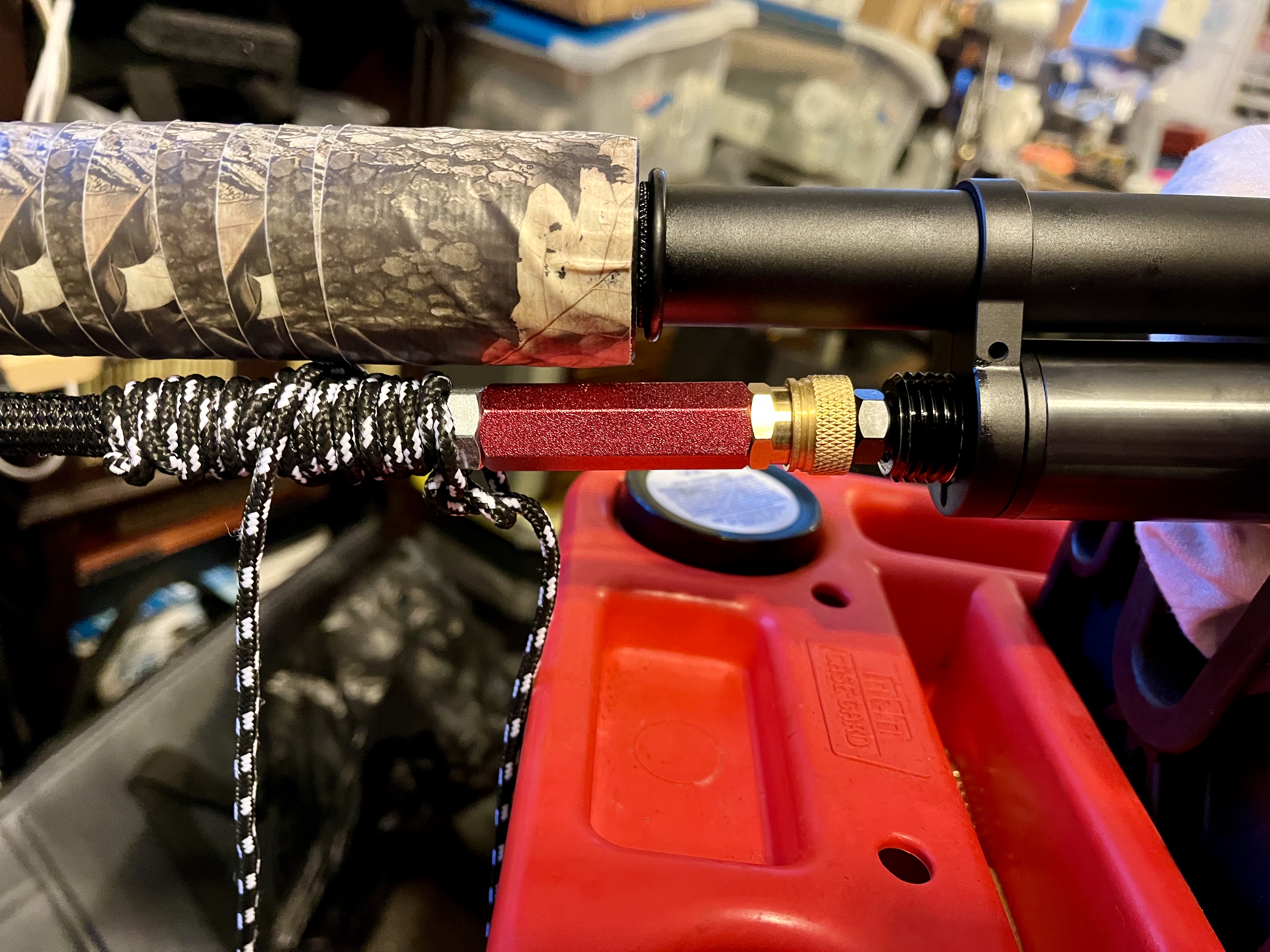

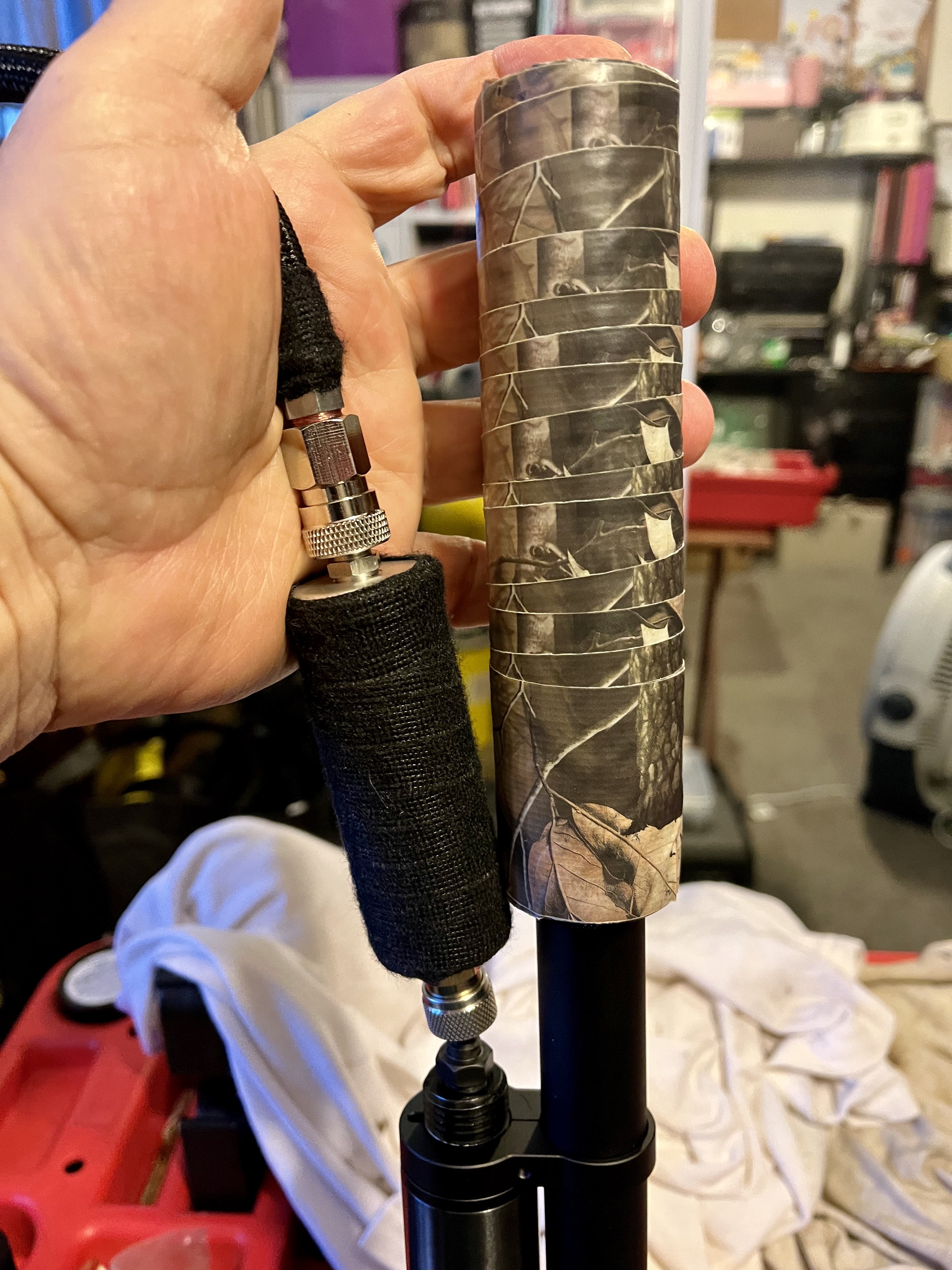

I just received my " Adapter " from DONNFLY, in today's mail. It fits perfectly with both the Aricuda Standard .25 cal Rifle & my " BUCK-RAIL .30 Cal Moderator ". I did have to relocate my " Inline Aftermarket Filters ", to allow clearance, for the connectors.
I'm going to attempt to add photos to this post..

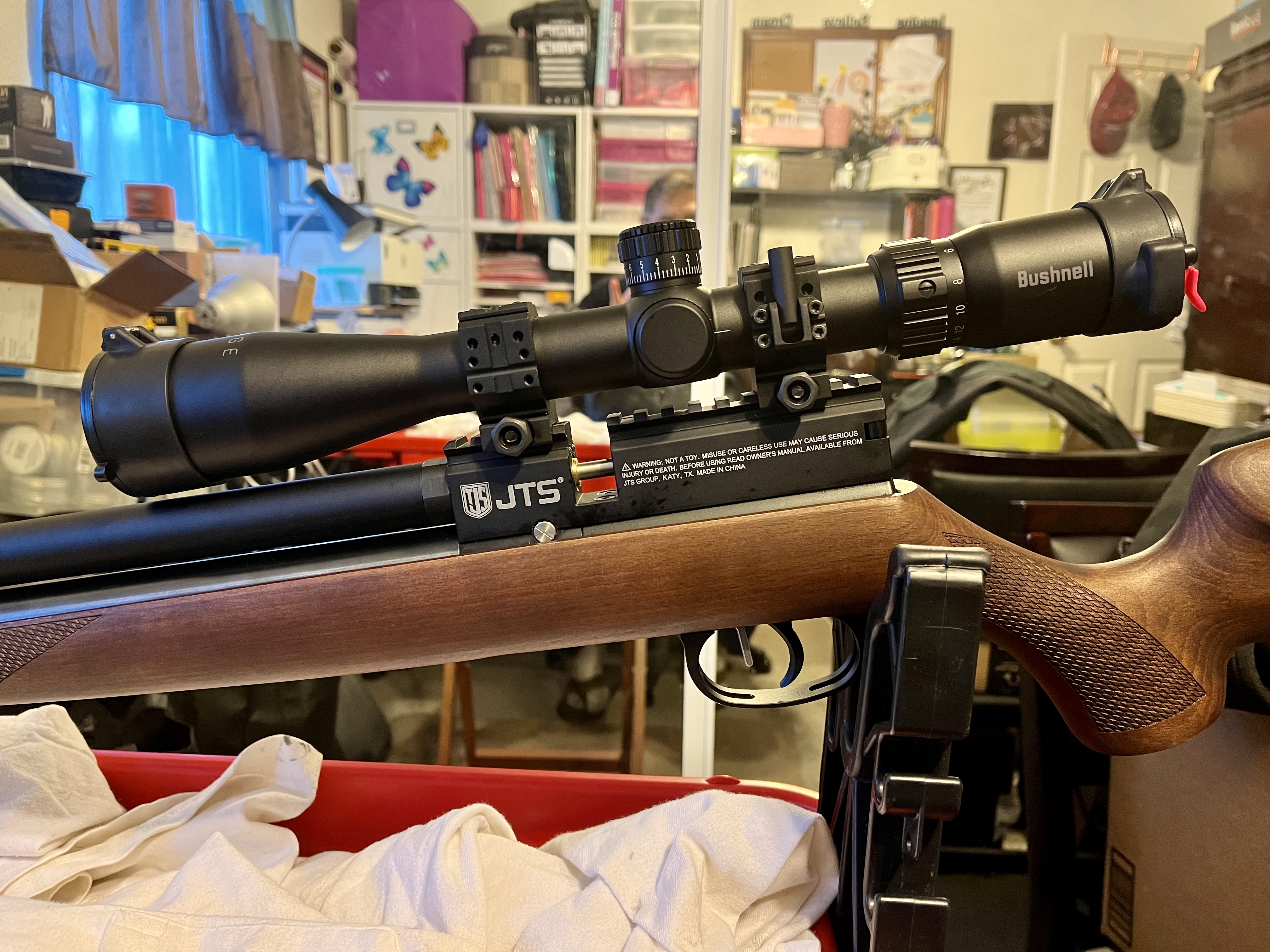

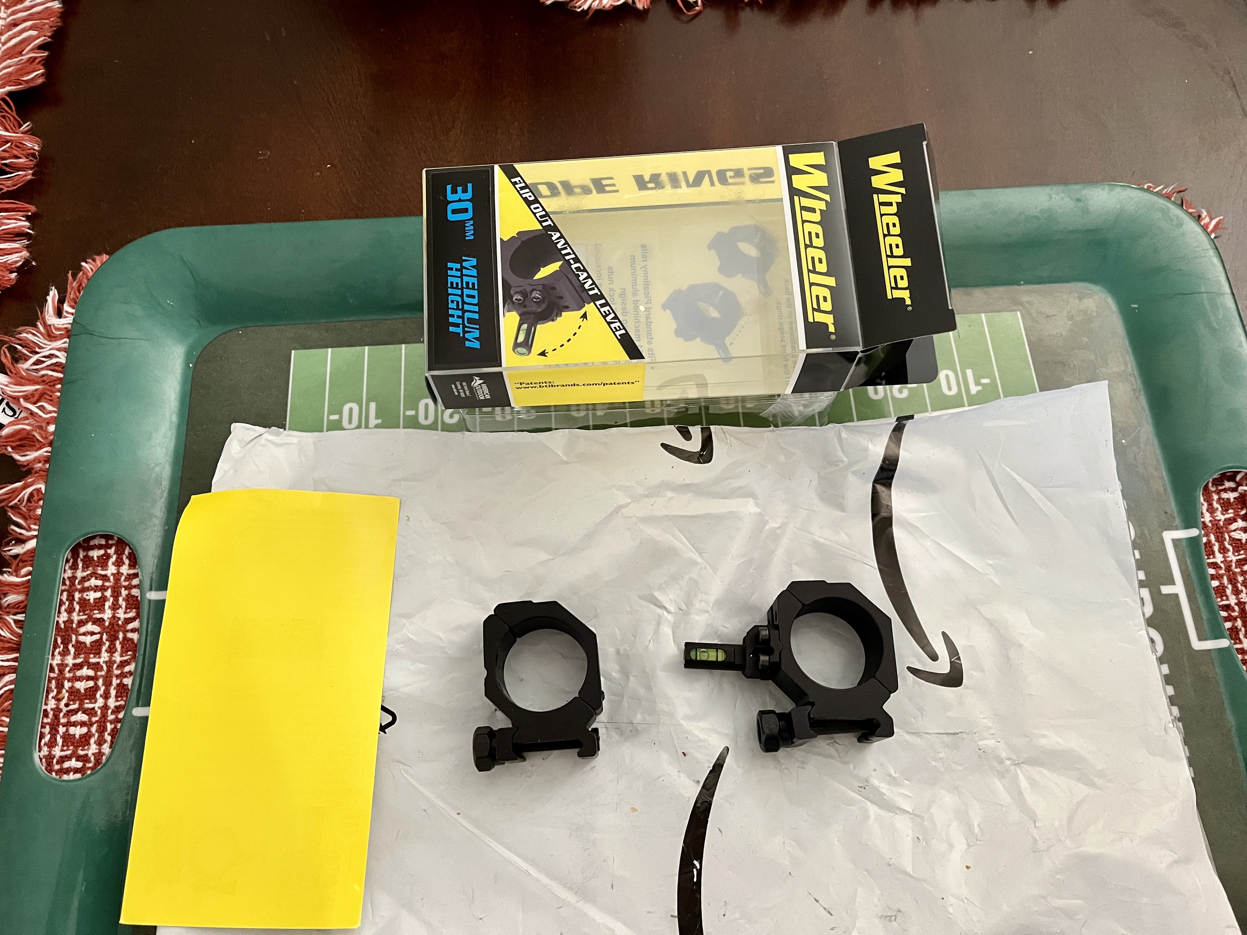

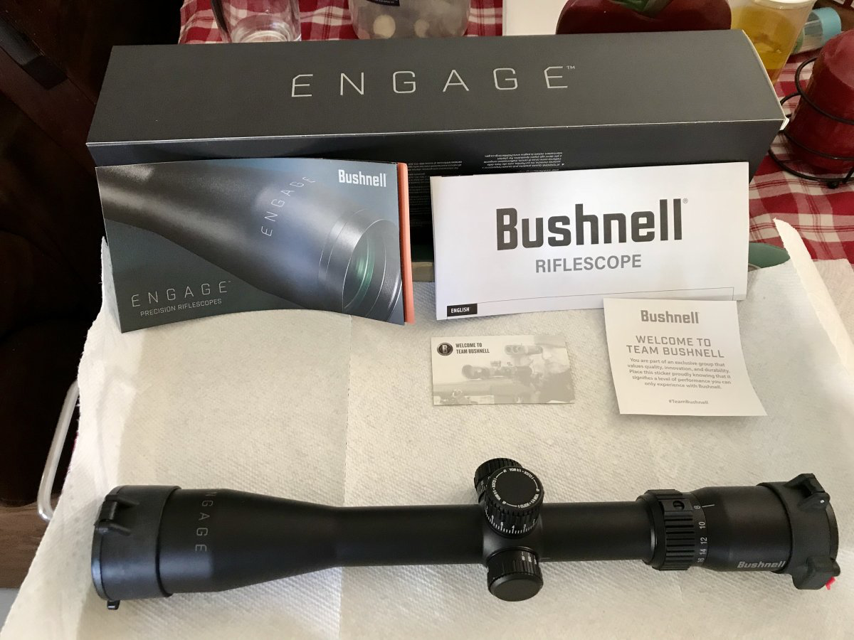

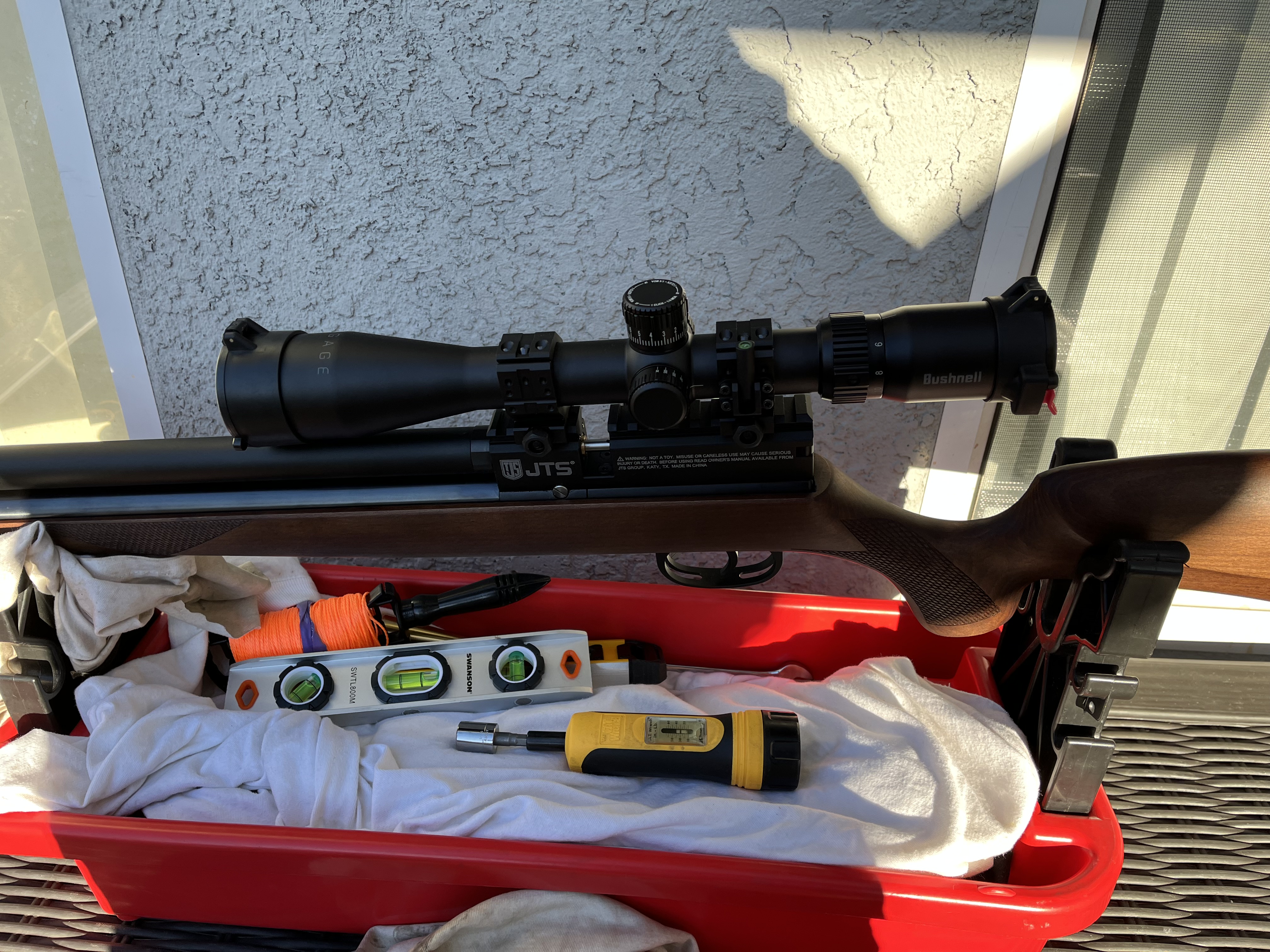

I just received a set of " Scope Rings " from " AMAZON ".
I had a Lifetime Warranty Replacement from " Bushnell " , which they kindly " UPGRADED "...:D

The " BUCK-RAIL .30 cal Moderator " works very well.. (y)
However, I do hear a very noticeable " PING " ( Hammer Spring ? ) with the Moderator on... :unsure:
