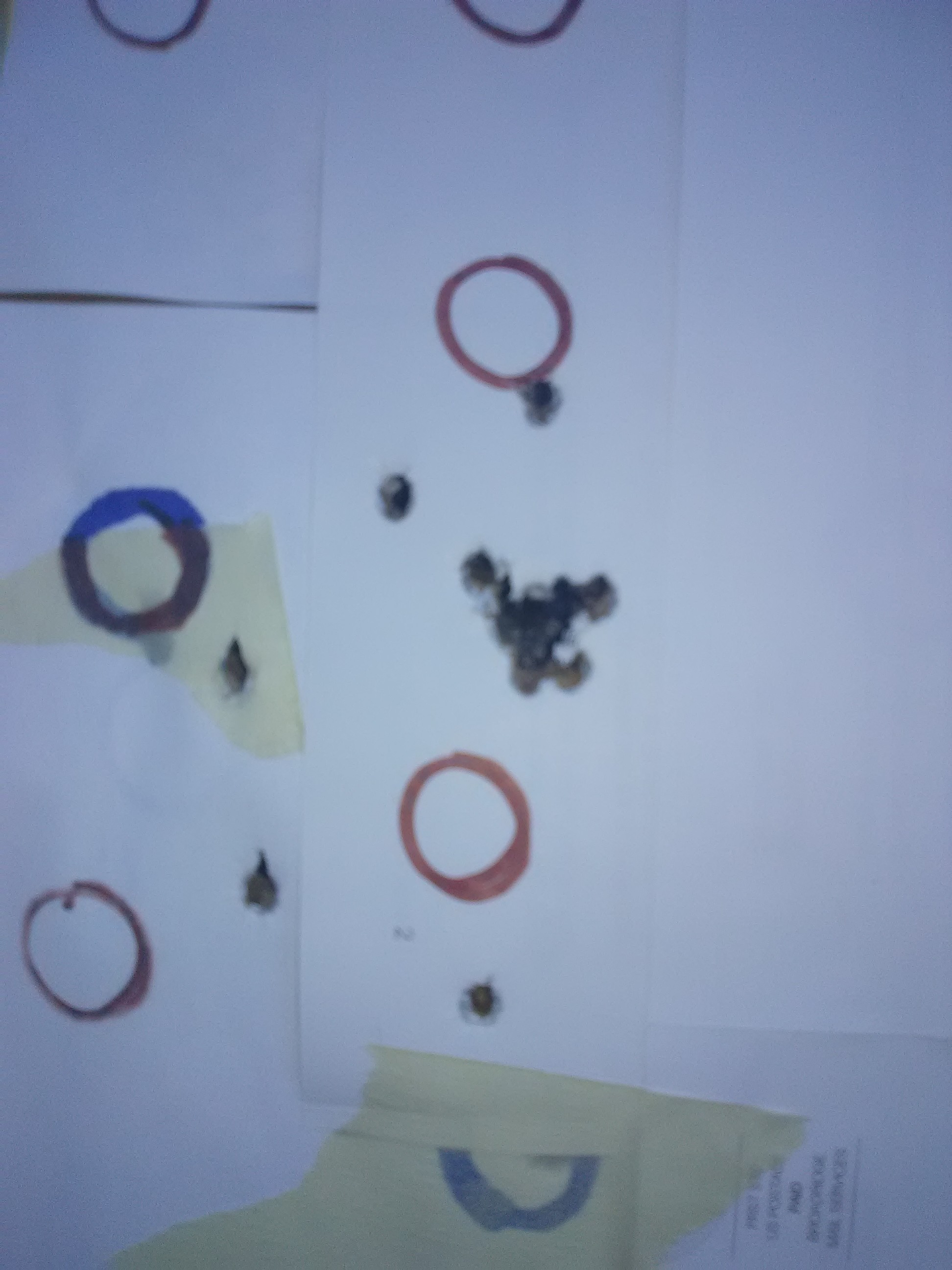

Ran tests today on the H&N pellet/slug collection, interesting results. Need to clarify my current tune is not factory, while Hammer Spring is factory, my regulator is 160 BAR, rather than factory 140. First finding, H&N Slug HP (28 gr), Barracuda Hunter (27.47 gr) and Barracuda (30.86 gr) all loaded easier in magazine but required slightly extra effort on cocking than JSB. Accuracy findings, Slug HP and Barracuda Hunter mirrored JSB (25.47) grouping, any Airacuda accurate with JSB (25.47) should have success with these. My higher regulator "tune" made very tight groups with the heavier Barracuda (30.86) pellets, will chronograph to determine foot pounds of energy. Can't recommend H&N Field Target Trophy (20.06 gr), hard to insert in magazine and too light for accuracy. If owner wanted to detune gun for low-power use, these pellets would be worth trying. Picture shows tight group of JSB (25.47) surrounded by Field Target Trophy (20.06); Point of Aim was circle. WM
