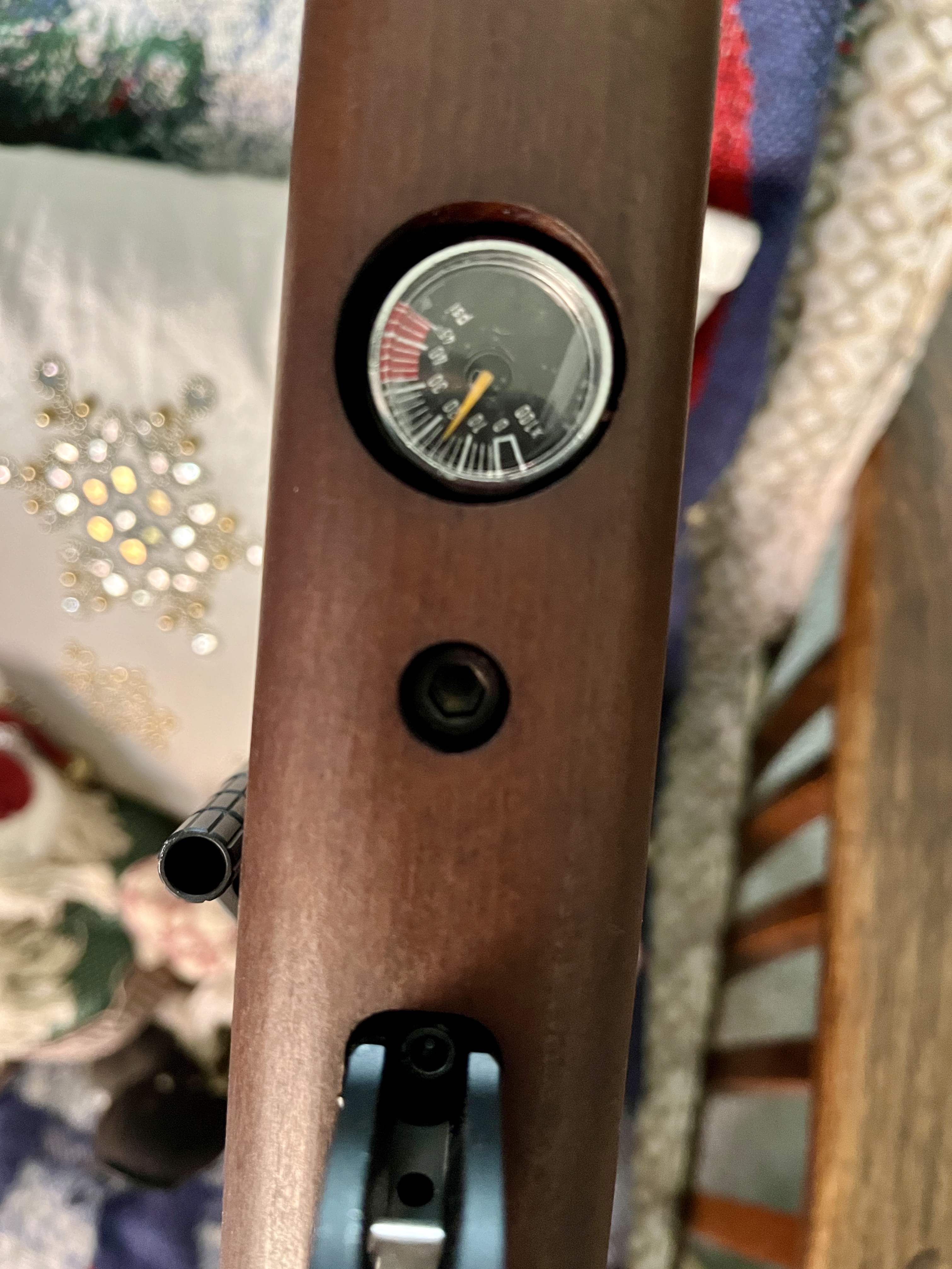

Can somebody help me? I have a Aircuda Max .25. My stock is loose. I do not want to tighten down on something that shouldn’t be tighten down. Can someone tell me where the mounts are so I can secure this to be tighter?
I put 2 O-rings on the screw before putting it back on the stock as spacers,.....works very well.

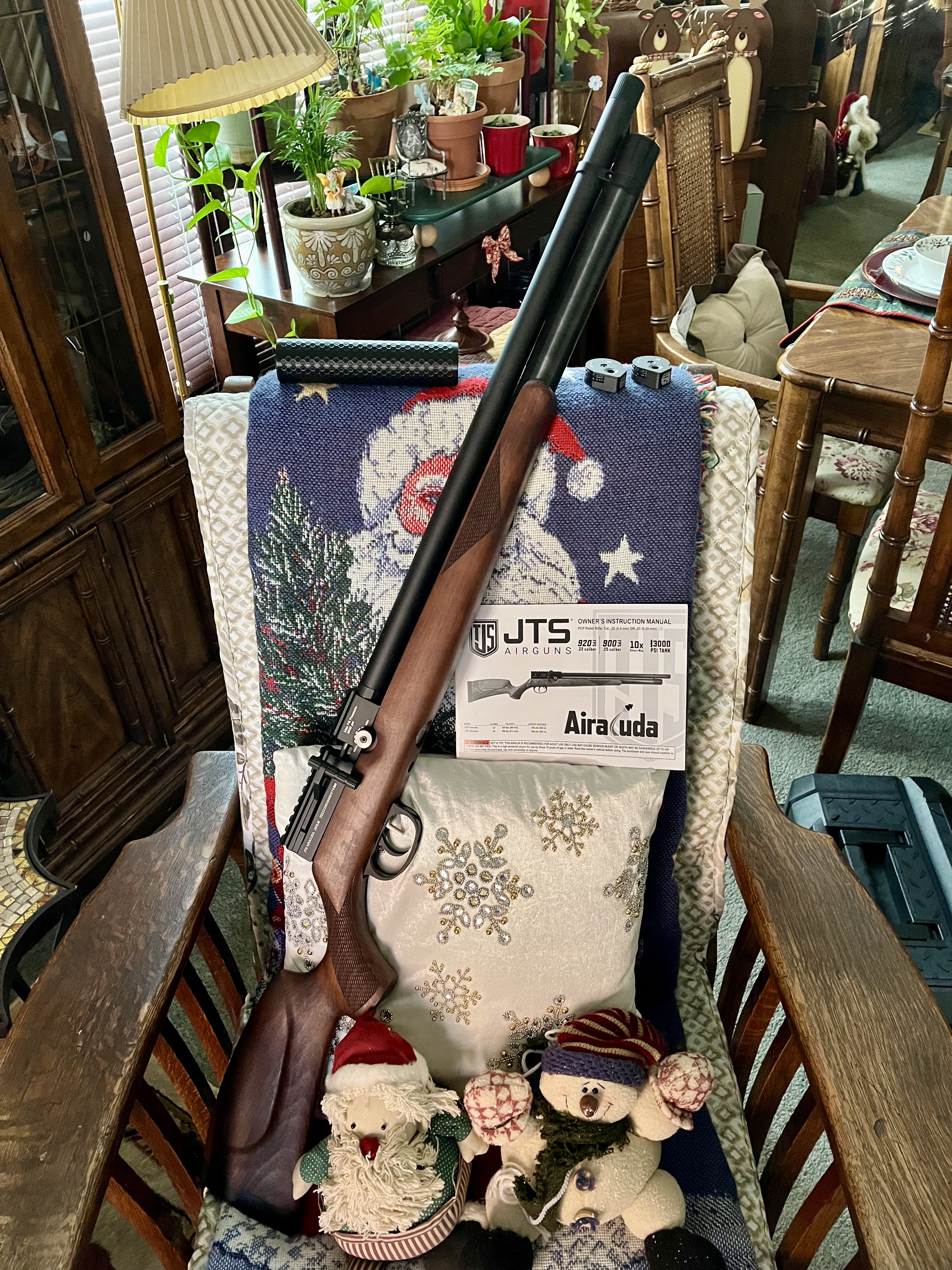

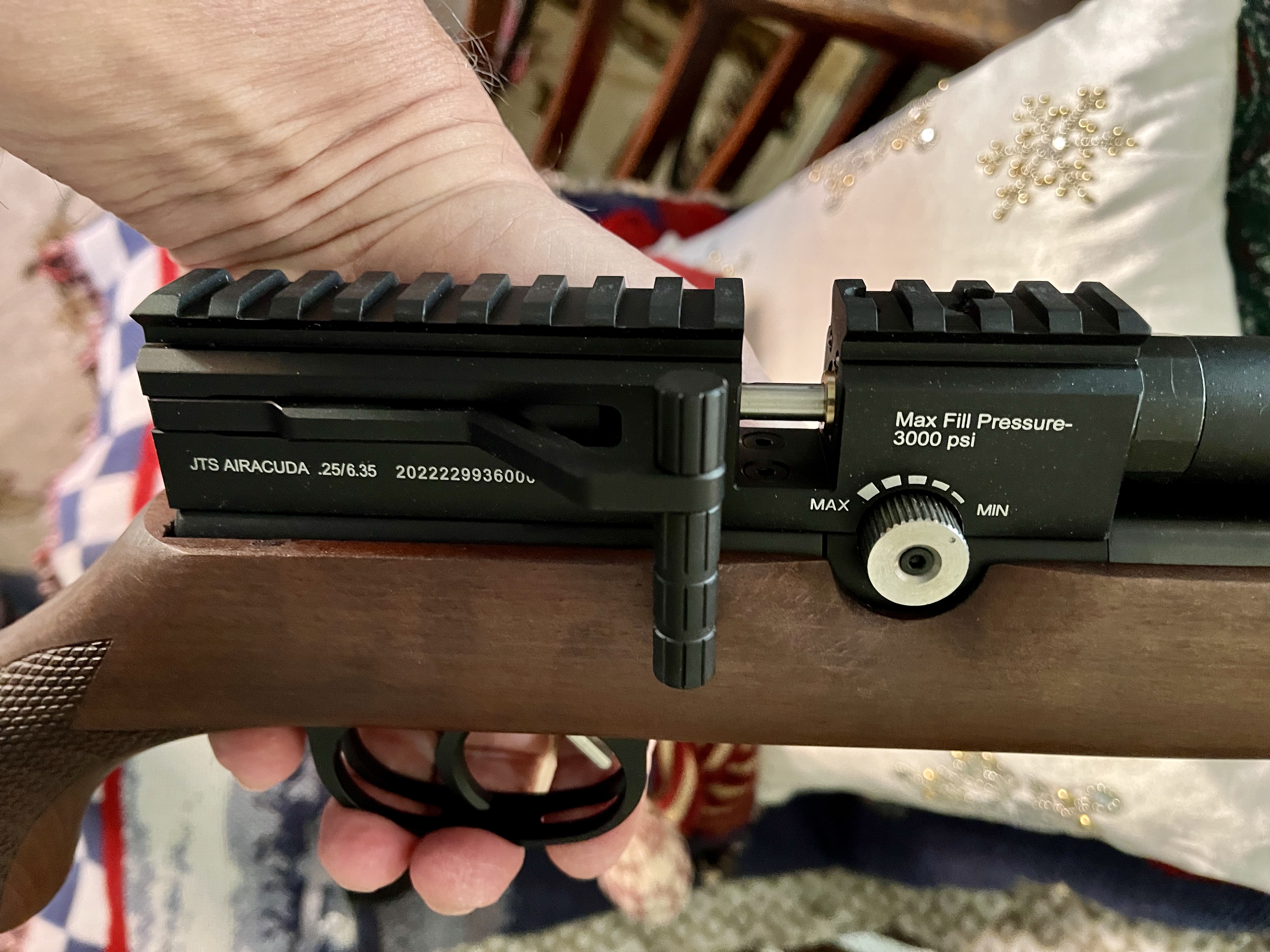

I just received my " Airacuda .25 cal Standard ".
My " Christmas Gift "..Tooooo myself. 😎

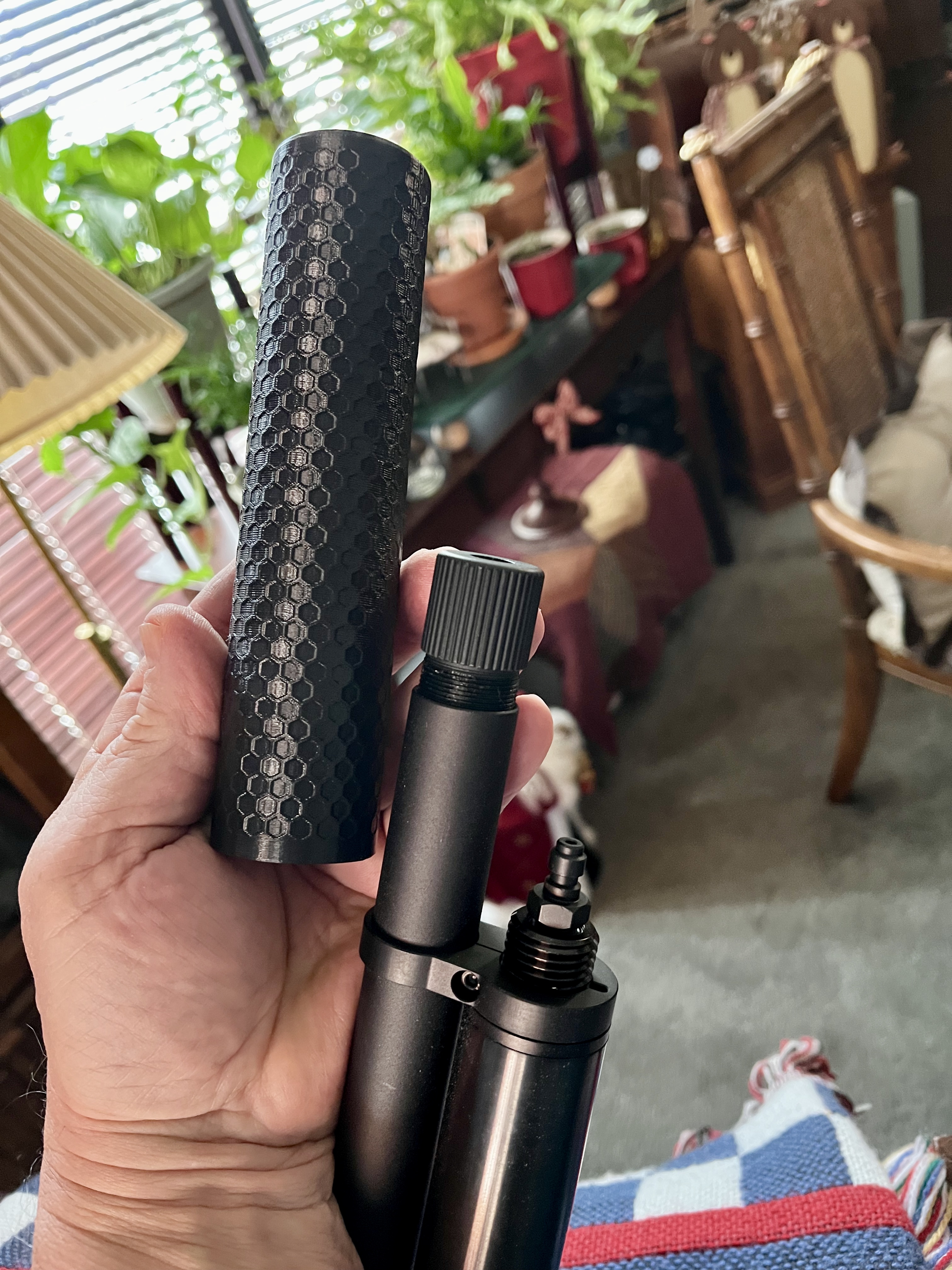

I plan to use a " BUCK-RAIL MODERATOR ", but I'll need to order an " ADAPTER " ( DONNYFL ? ).
There was Air Pressure inside.. I Dry-Fired it a few times @ the lowest setting.
I'll fill it up with compressed Air & let it set for a few days, toooo check for possible leaks..?
P.S.:
I'm really pleased with the overall look & it handles very well,.. very comparable to my .22 Lr Rifles...(y)

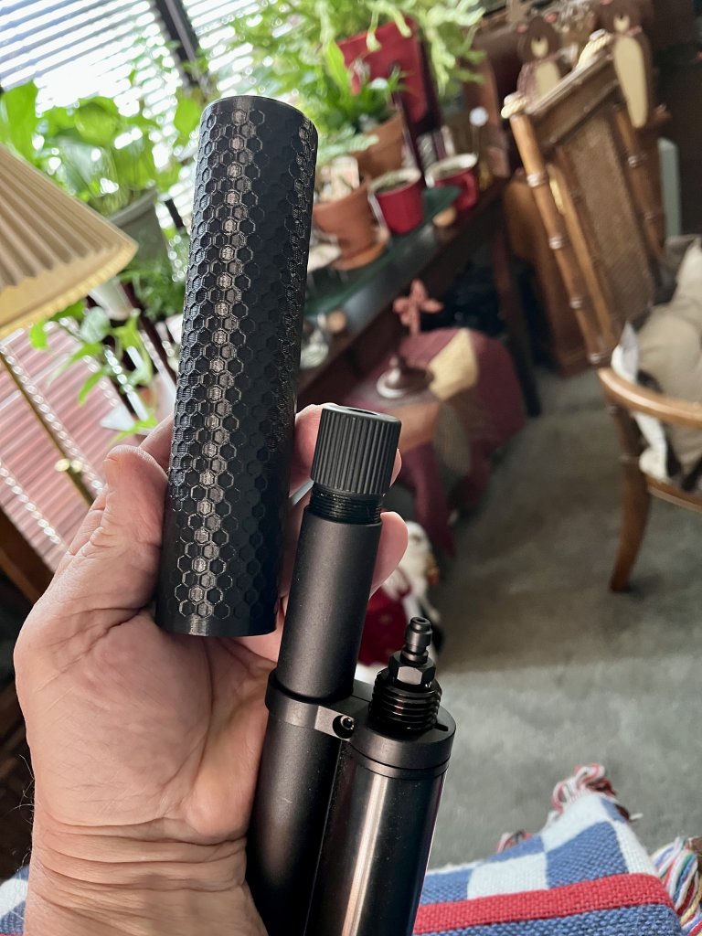

Consider the $33 Buck Rail 1/2-20 UNF Suppressor (SKU: 018-02) mentioned on Air Gun Detectives Airacuda video. Free shipping, no tax, works and looks great. WM
Thanks for the info..But, I already have in hand, the " Buck-Rail Moderator; 30 cal " model.

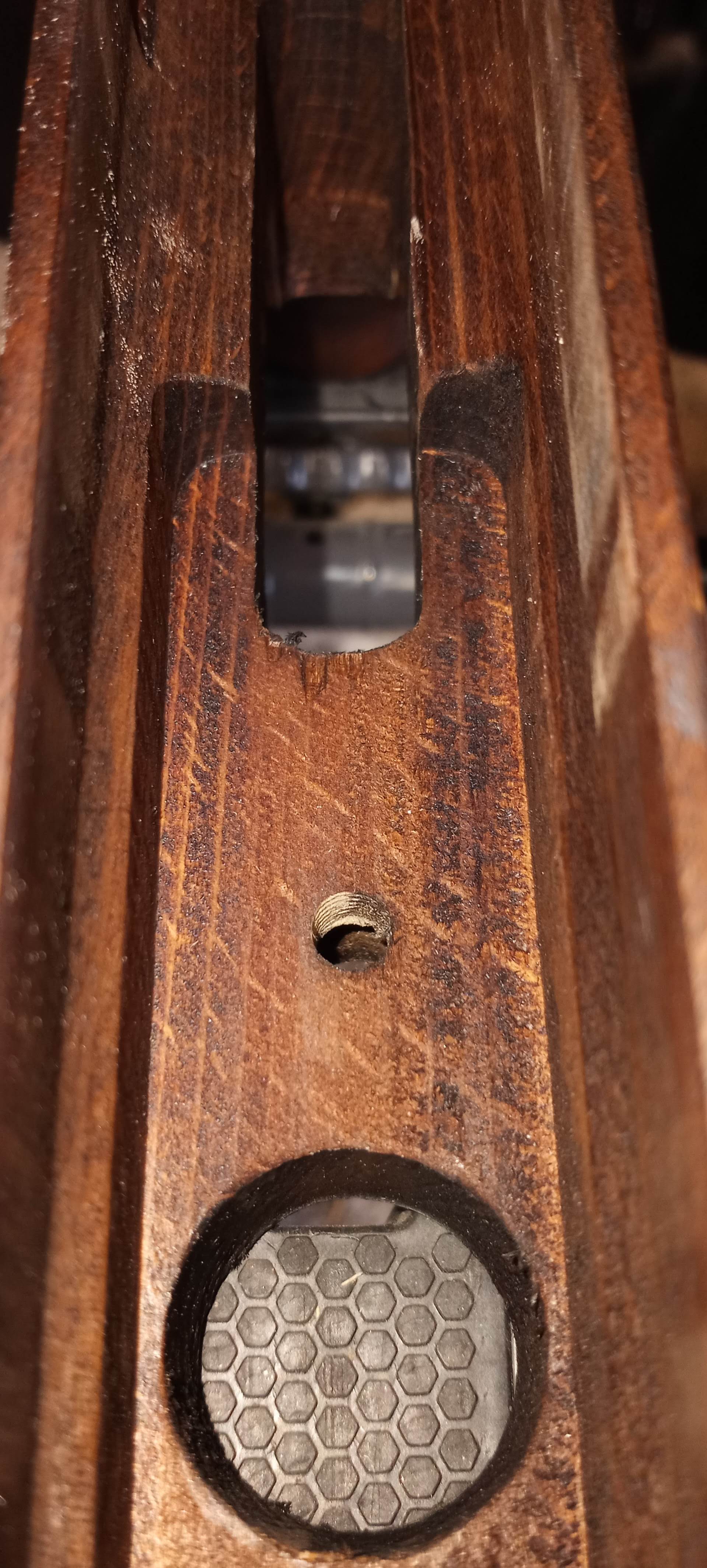

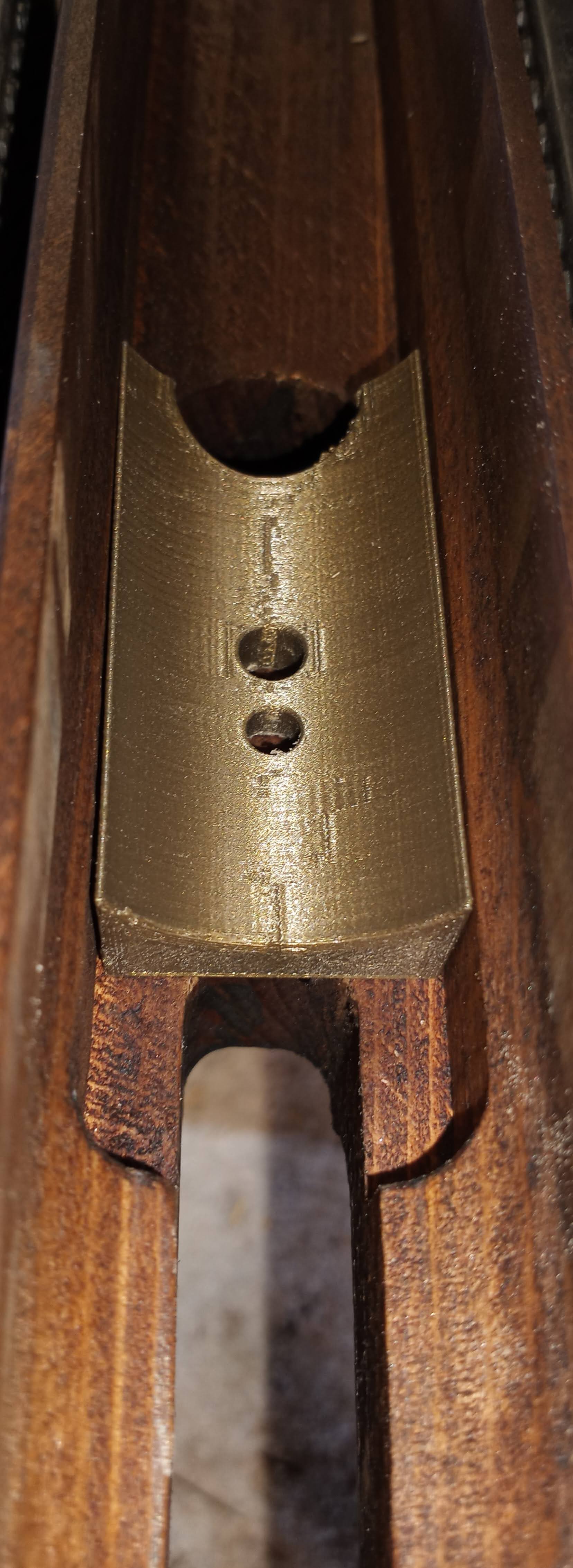

If you have a square inletted stock like below, the insert is the only way you can support the airtube, O-rings will not overcome the gap.
Reactions: nobody1
Thank you fire walker I am going to take a look at this after work today. Still waiting to hear from Travis to see what’s the next step that I need to go in. Gun shoots and operates very well other than this.
The Buckrail made a significant difference on my .22 Origin tuned to 27 FPE and .25 Origin tuned to 50 FPE. No experience with high end moderators but no Buckrail LOUD with Buckrail much quieter.Now, the Origin model is a long one piece moderator with internal and external baffles.View attachment 308868

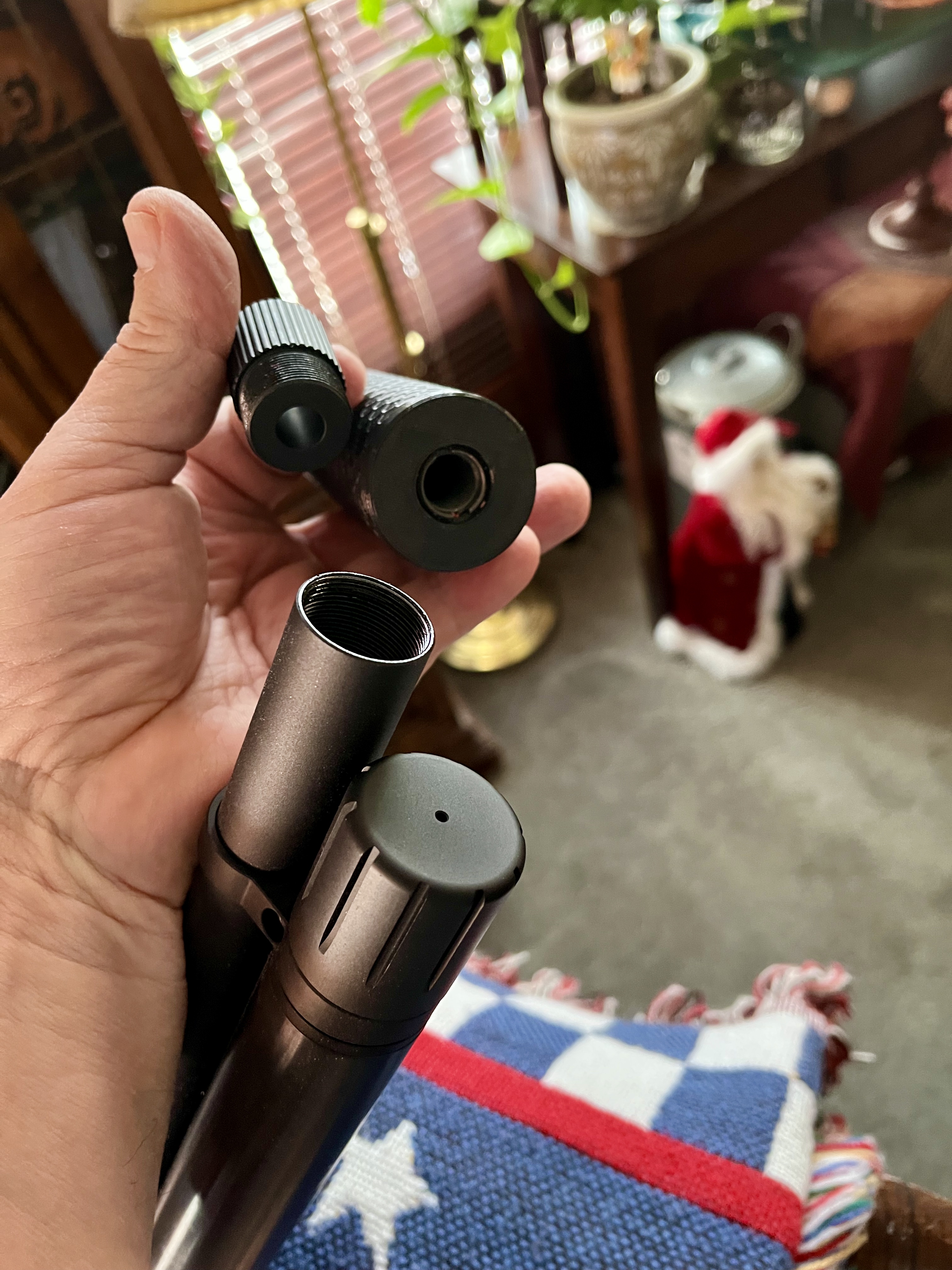

Just to make it crystal clear I can order this moderator as is and it will thread right onto a Airacuda .25 correct?
Reactions: Firewalker
No. it will thread into the shroud of Umarex Origins and Avengers. It is said that Evanix has the same shroud threads as the Airacuda and I am not sure if Buckrail makes one for Evanix shrouds. Sorry for the confusion.

Remember that the shroud thread is the same as Evanix guns, so if you can find an LDC made for Evanix rifles that screws directly into the shroud you will be golden.
