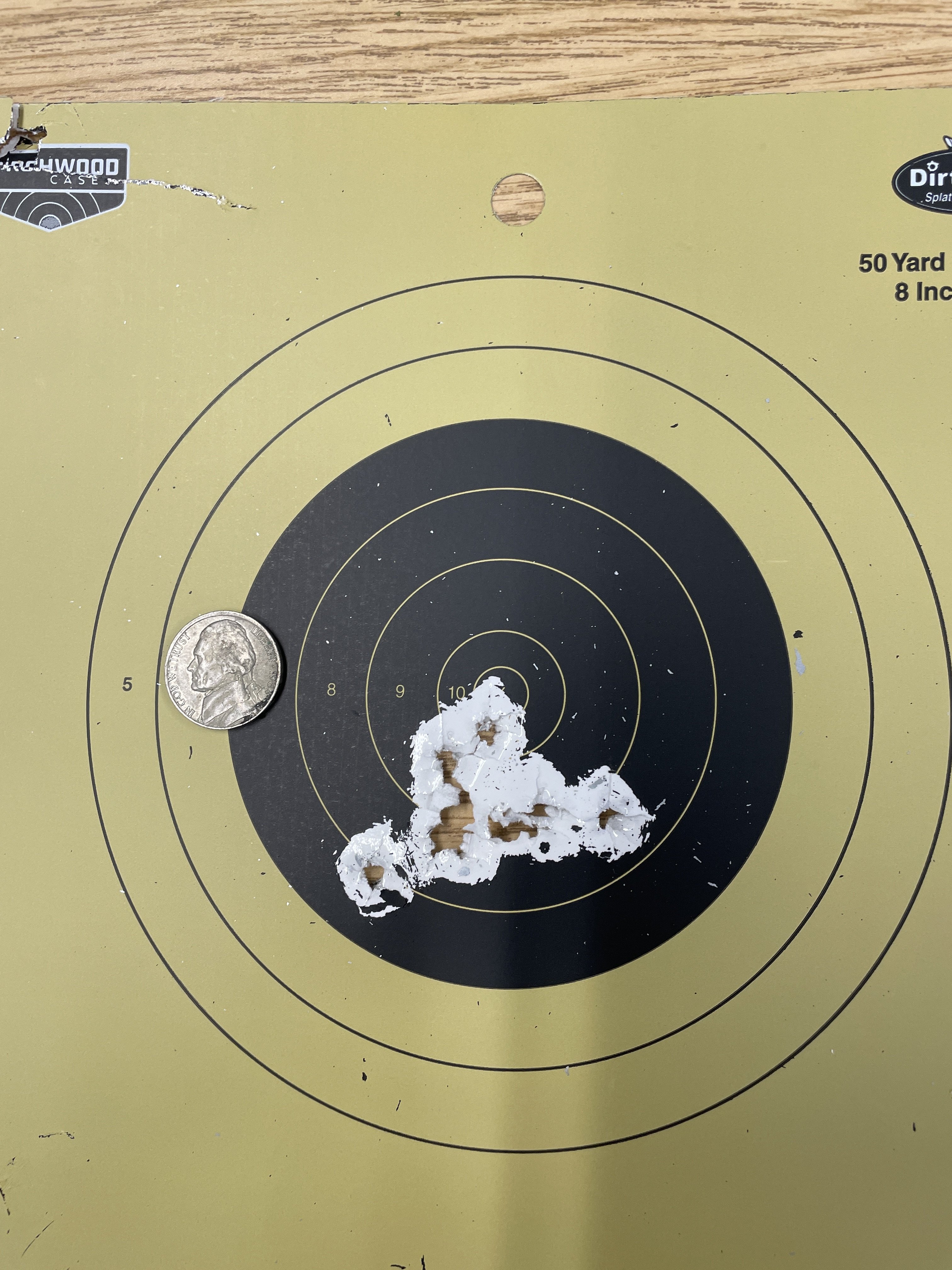

Well I’m a little embarrassed to report this but after figuring out which screw tightened up the stock I simply took an Allen wrench to it. It was incredibly loose. Tightening it three full revolutions pulled my stock up tight with no play at all! It pulled my sights up about 10 inches at 50 yards. Very glad that this is all that needed to be done. Next step was I filled to 3000 psi took 30 shots it was than approximately 1100 psi. Shot still felt strong but I don’t have anything to measure velocity. What do you guys think?
I will follow up tomorrow with centering on one target for 30 shots. To see if I lose velocity/accuracy.

With all this being said I don’t have a difficult time putting the magazines in. I will hear from Travis soon and I will ask him the same question. I did not take the stock assembly apart, I only tightened it down so I am unaware if the spacer is there or not. I don’t like to take things apart if I don’t have to. I am hoping to get some time to test accuracy today. I am also a little nervous feeling up to 3500 psi because then I will obviously be well in the red
