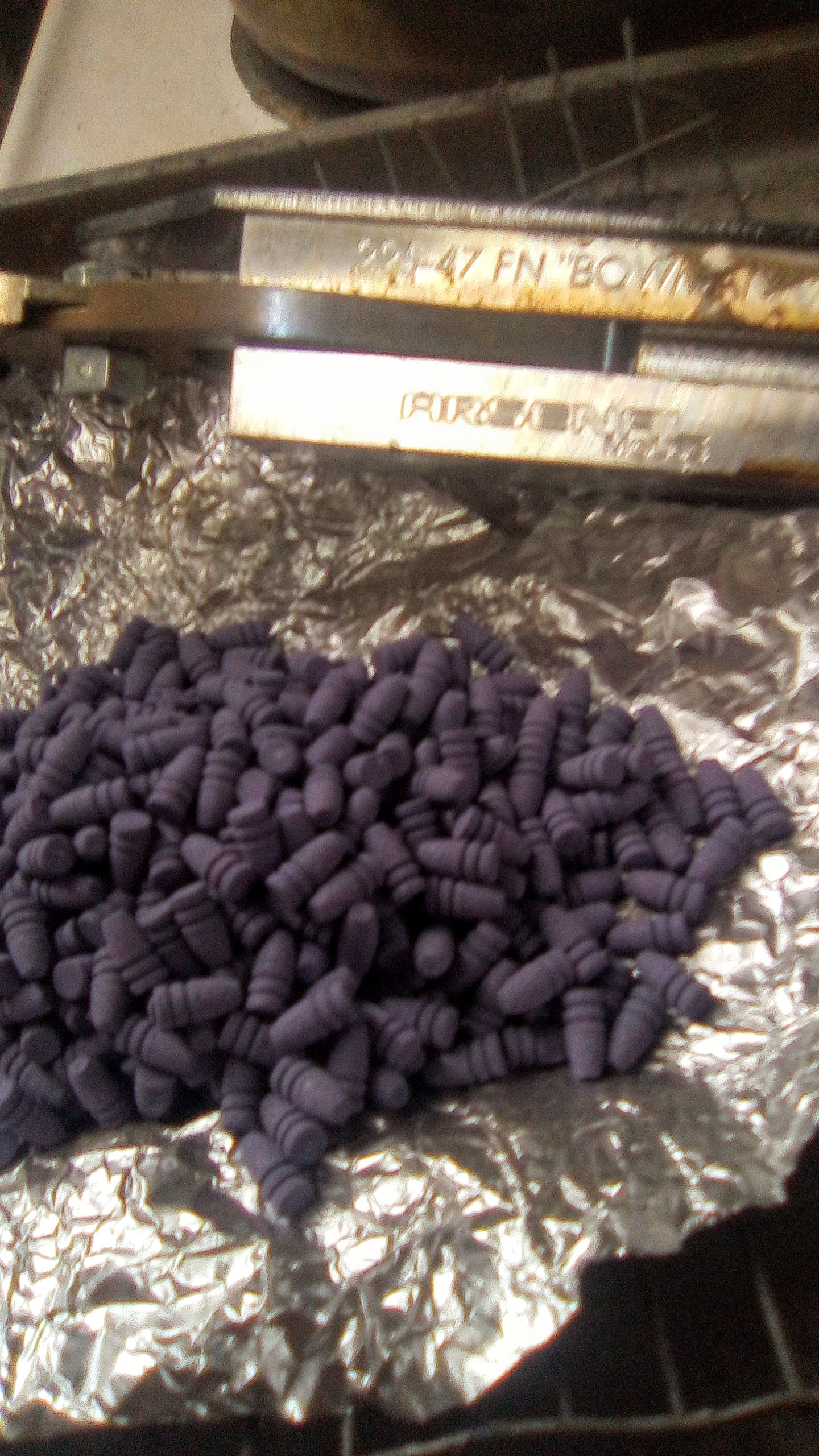

About $2.00 worth of pure lead and powder coating..A few hundred slugs....Beat tariffs... lol
WOOF !!! Blow out any windows or set off car alarms from the blast ?
It is real loud without moderator...Same power as 22lr...Same noise...With a Moderator 1.5inch diameter x 12 inchs tames its down very nicely.. Im waiting on the dony Fl talon P 1\2-20 moderator adaptor for the endcap...The differnt valves make different amounts of noise...The Doug noble valve turned all the way up is Texan loud..The trajectron valve works good too a little less powerful and a little less loud and much cheaper and easier to get at $100.00 price tag... Doug Noble valve is a absoulte beast for Condor platforms..
This has been debated over and over, but wanted to get your opinion on the powder coating. Benefit for air guns? I know folks talk about less lead dust, etc... but that makes zero difference to me. Great looking little pills there, by the way!
