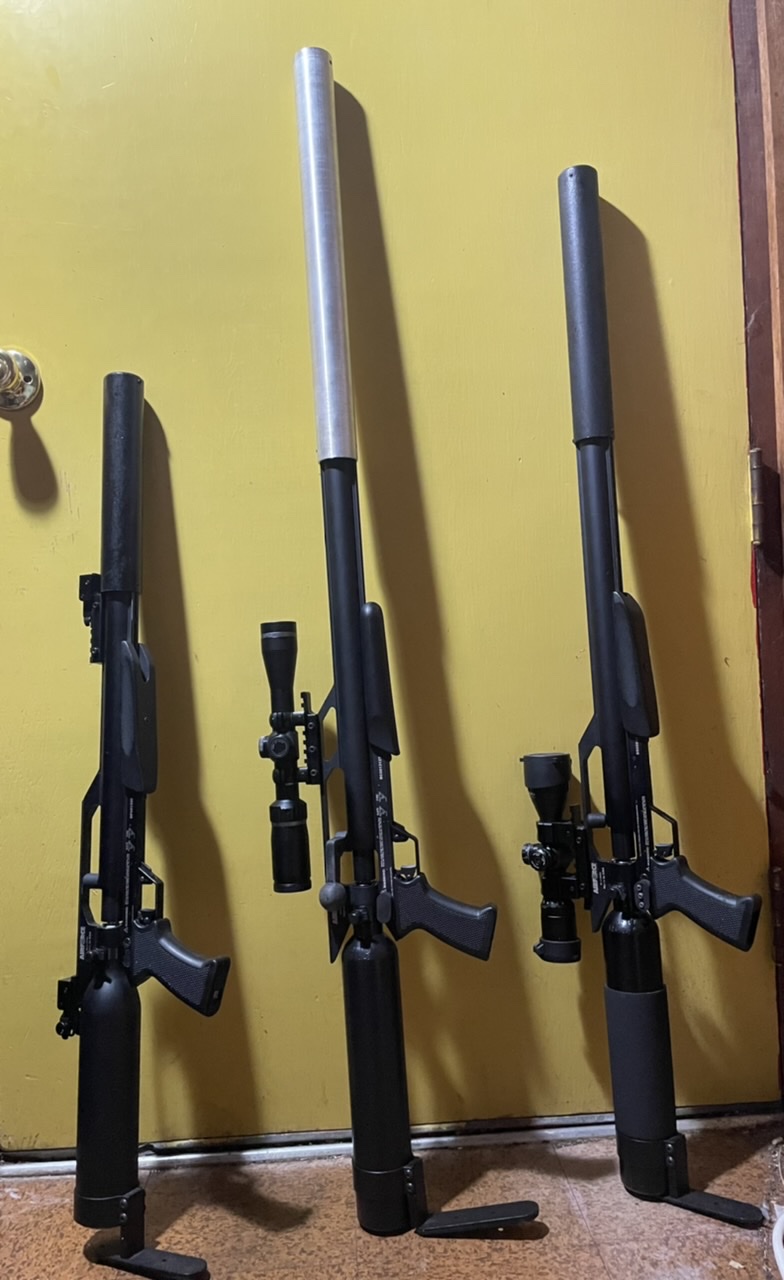

Nice! I love my airforce guns. I have three (plus almost enough parts to build a couple more)
They originated as a .177 talon ss, .25 talon P, and the third i built into a condor frame i got from airforce.
The smallest has an 18” .25 AF barrel but heavier hammer and spring and will one day have a Doug Noble valve (waiting on an order that is close to complete). I have iron sights on this and it is a great plinker. This has a 3000 psi bottle and polished / ported TT valve. This shoots 66-85 fpe.
My mid size has a .250 TJ barrel, 24” length, Doug noble hammer, valve. I case my own .25 slugs and needed a gun to shoot what I cast. I have a 4500 psi bottle but don’t fill past 3900 or so. This shoots 100+ fpe
My larger gun is like above but a 27” .257 barrel and easily hits 160 fpe
I had some extra time on my hands during the pandemic shut downs and I went a little bit over the top I guess. I don’t care about recouping any money it is the whole process and hobby that I enjoy, I am not investing.
All three have homemade extended shroud/ldc add-ons that i cobbled together from an aluminum tube and 3d printed baffles, they work very well to control sound and so far hold up to the power levels well enough
Reactions: Carlton29 and Numb

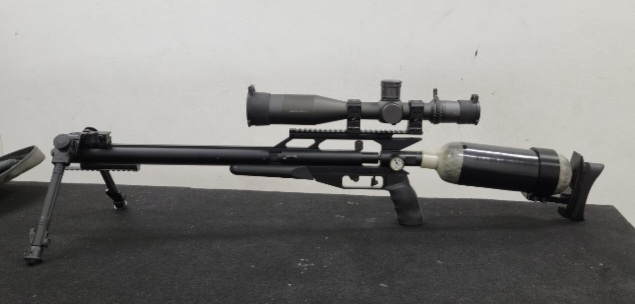

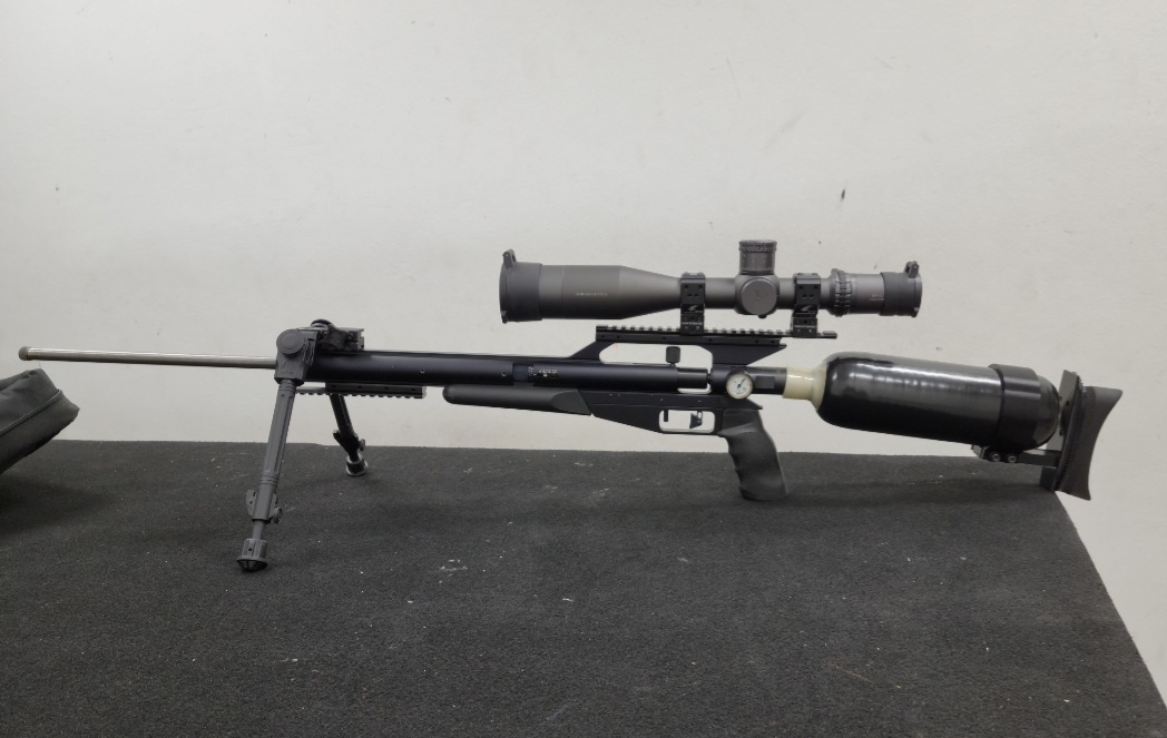

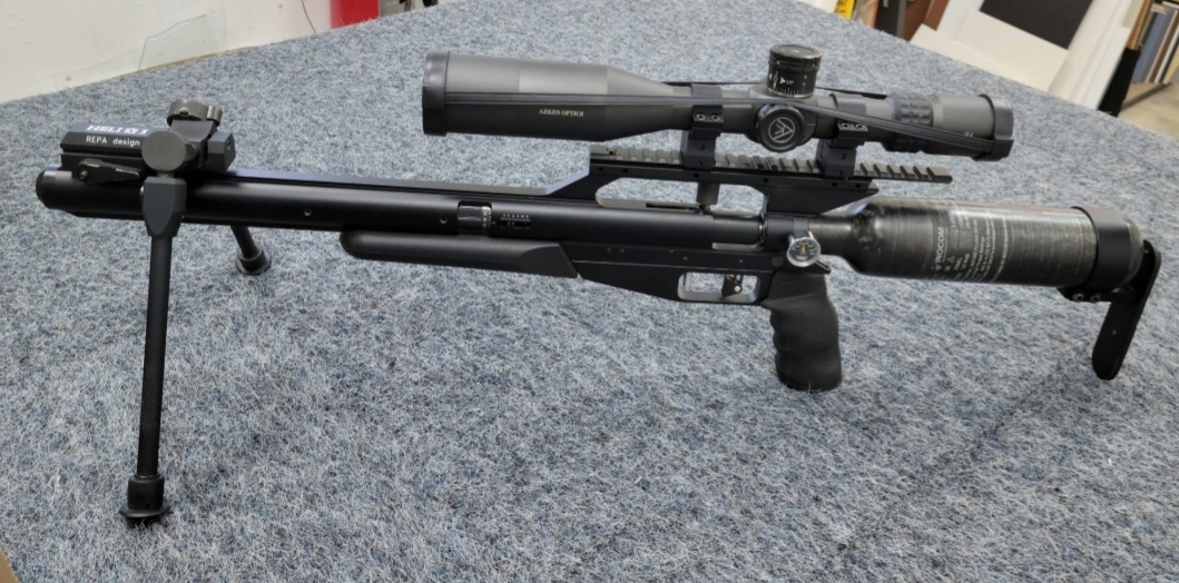

My spare frame assembled..short gun old talon ss using 18" condor barrels n valve in .22 - .25 ... the other is my long frame condor ss awaiting the new 33" barrels . Both of the big tank guns have Doug valves without them there is simply no point..is the only way to make big n reliable power..View attachment 274080View attachment 274119

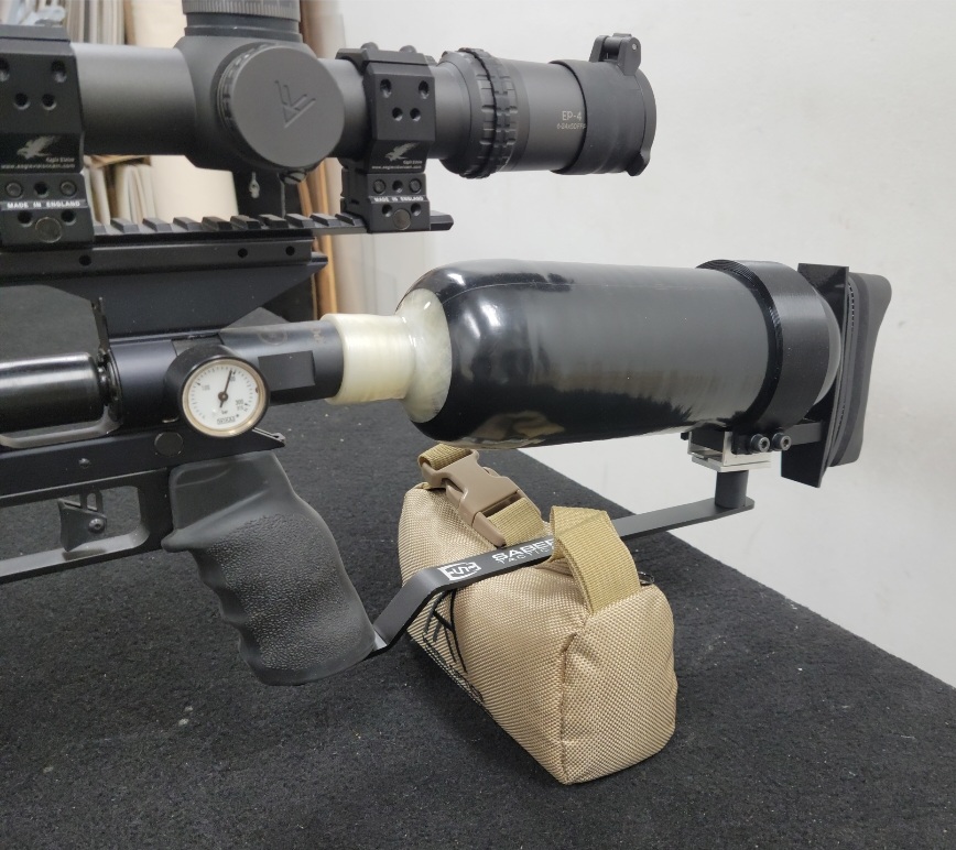

Nice - can you tell me a little about what you have going on with the larger CF bottle - looks like you added a part to push it back clear of the frame - any info on parts to do this? you could put a 1L paintball tank on there with that neck. Or is that already a full liter?
That is a bottle drop from pcp tunes..they have a condor bottle drop and a texan bottle drop..texan version to low. Condor adapter is the way to go perfect eye placement with medium adjustable rings...the bottle is a 1000cc from them to .with their shoulder rest..
I see you have a carbon fiber tank on that short gun and are using it with condor valves. Are you filling beyond 3000 psi? I have a similar set up in a talon P frame with 18” barrel and condor valve and hp tank, and heavy spring and hammer, but I’m worried about bending or deforming the valve stem so I don’t fill over 3000 and keep the pw dialed down. Eventually this will have a noble valve which I know can handle the higher pressure… just waiting on that part to be complete
That 480cc bottle has the standard condor ss valve . That set up will be a 3000psi only fill .. will a 95gr hammer maybe 3100 but not more than that..

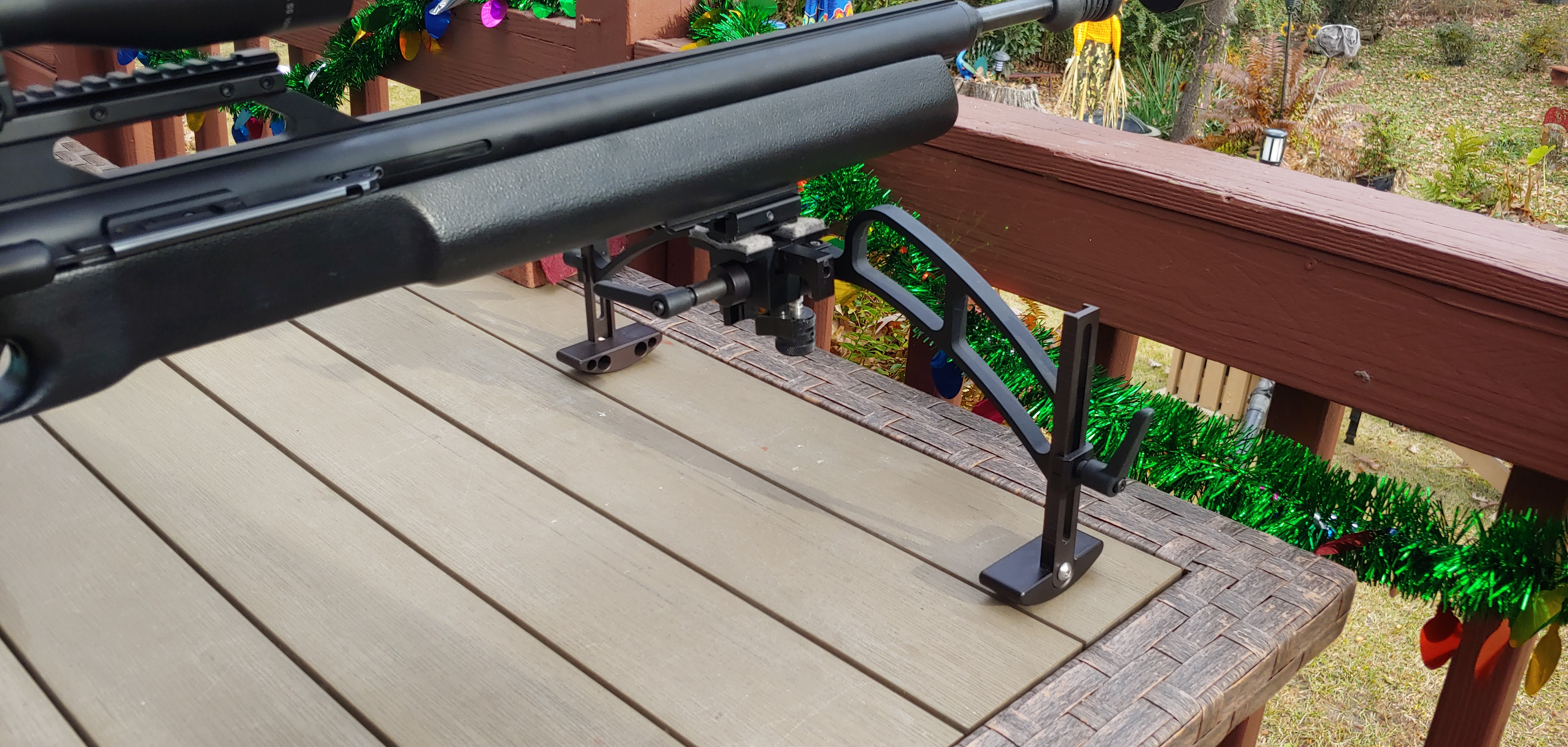

@mercado Where did you find that bipod? If you have a link to a site where they’re sold, do you mind sharing it?
That is a German all metal bipod made for a heavy airsoft gun that looks like a bulldog.. brand is Begadi otto reppa .. as far I know discontinued..when I place that order I asked for 3 they send me 1 ..I have not seen it on stock since.. that was 3 years ago..
