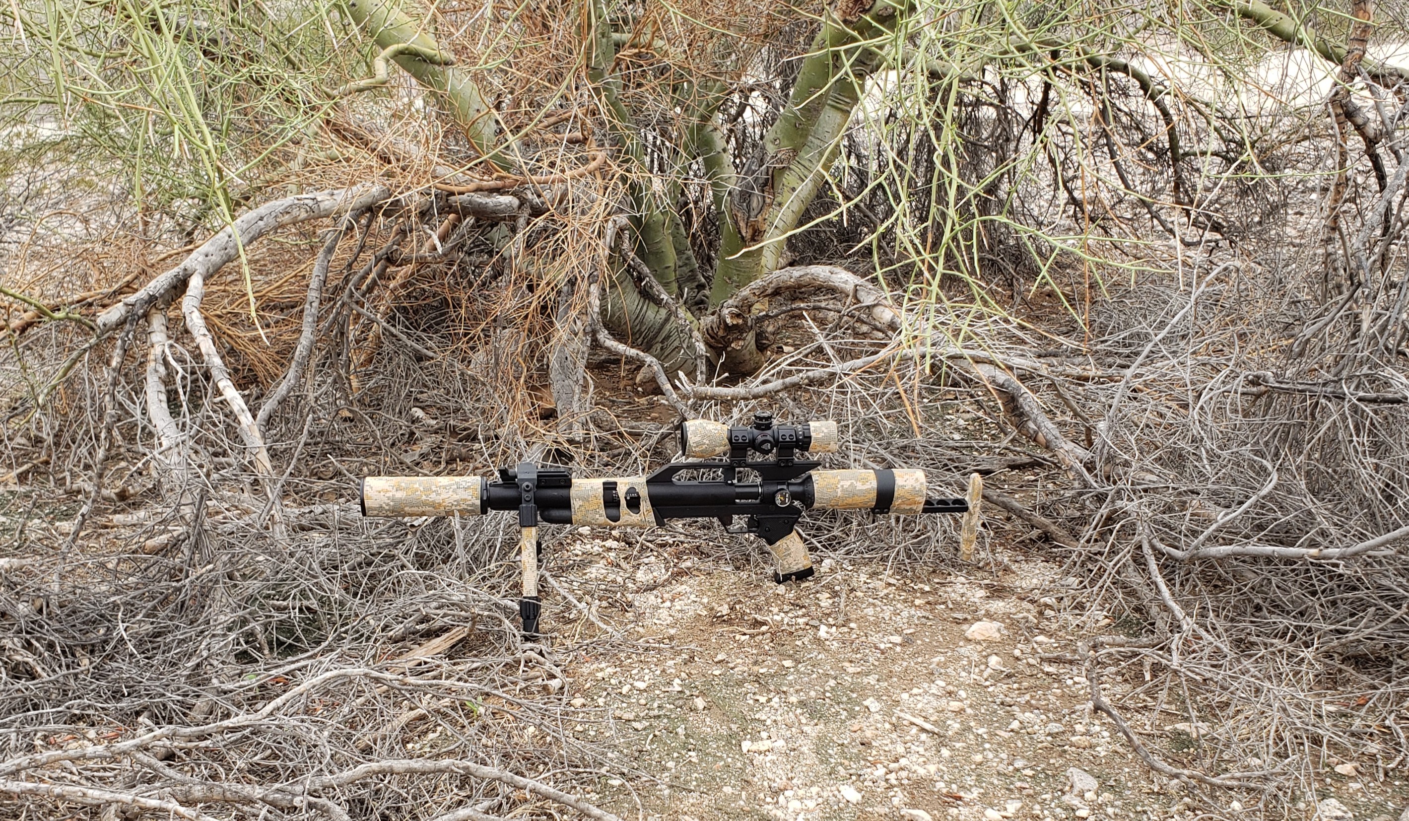

I've owned a lot of air rifles over the years but recently became a big fan of Airforce air rifles. It would be hard to say what I like most about them: well built, excellent accuracy, great warranty and after sales support, lightweight, and outstanding third party parts and modifications. My first Airforce air rifle was an Escape .22 and I liked it so much I bought a used Condor not long afterwards. Here's my latest build: an old Condor .22 completely turned into something that's a joy to shoot.

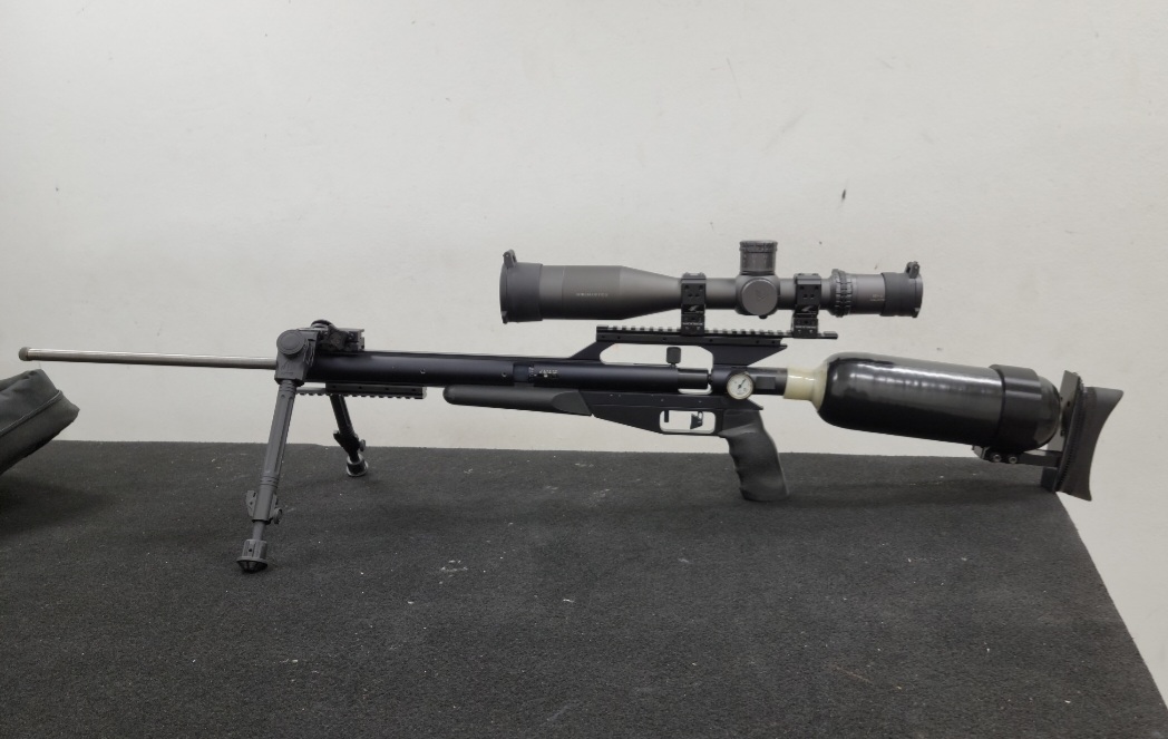

I have 3 .. 2 of them easy are 2k buids only for heavy bullet shooting .. I was going to sell the third..but keep it for 2 reasons one a spare frame just in case something in the other 2 frames fail .. or I'm hit with a other 5 category hurricane like Maria n we were almost 6 months without power..there a low fill gun 3000psi comes very handy... other than that .. I really don't know why someone would choose to buy a small caliber airforce..over a regulated gun .. Gaunlets are putting great smack down regulated power n still cheaper than a single shot airforce..that fastly becomes a money pit that almost no body wants unless you sell it will all the gismos you purchase for $400 or less.. don't get me wrong i just paid for another 2 mandrels to make 2 new barrels for my airforce i have 4 barrels on the works that is $1000 only in tooling..+ whatever the barrels costs + the machining costs..is that the truth is they are better guns for your money. View attachment 274018

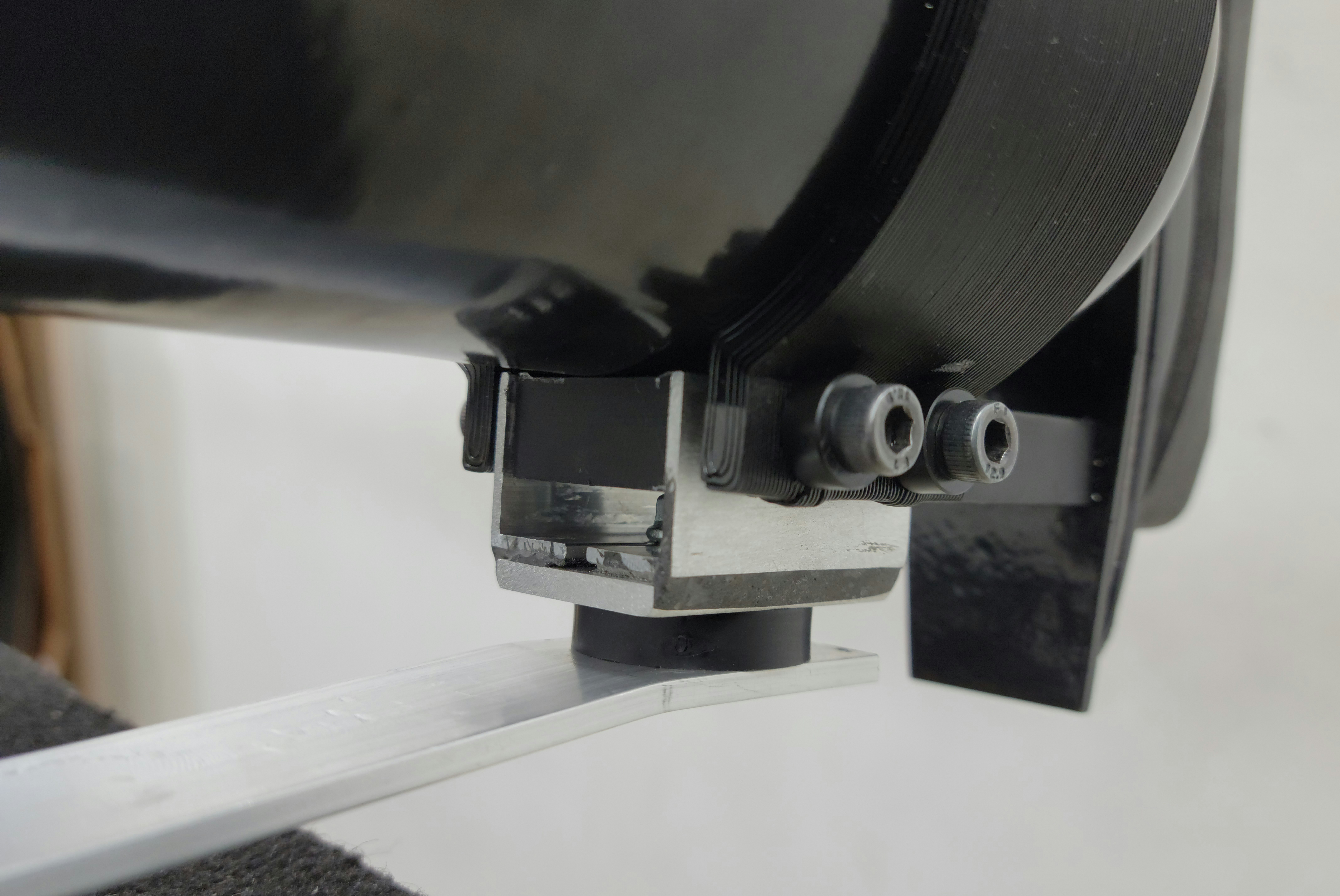

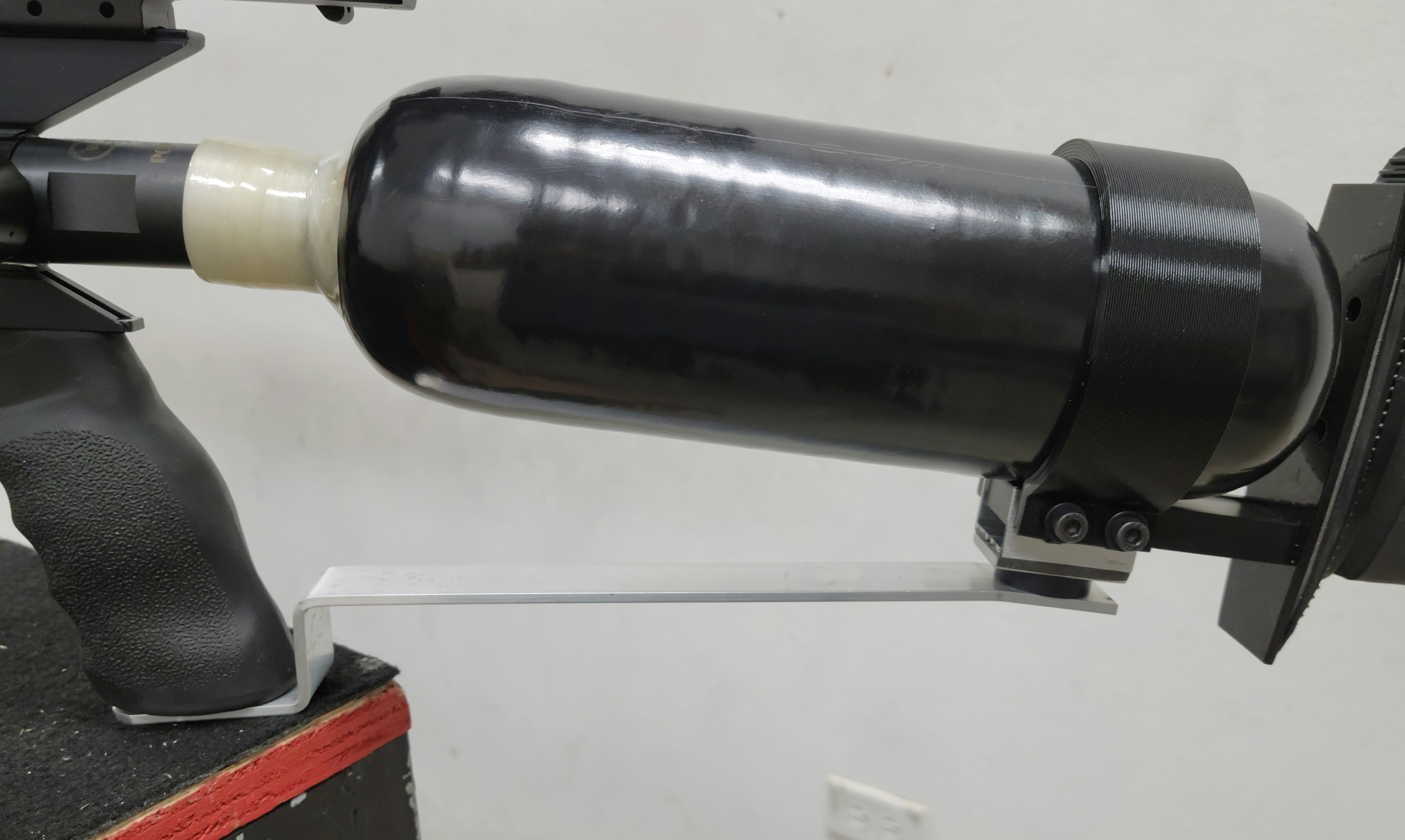

The grip was swapped out the first day for a MDT PISTOL GRIP ELITE , direct swap with a good palm swell and a little more body to fit my hand.
