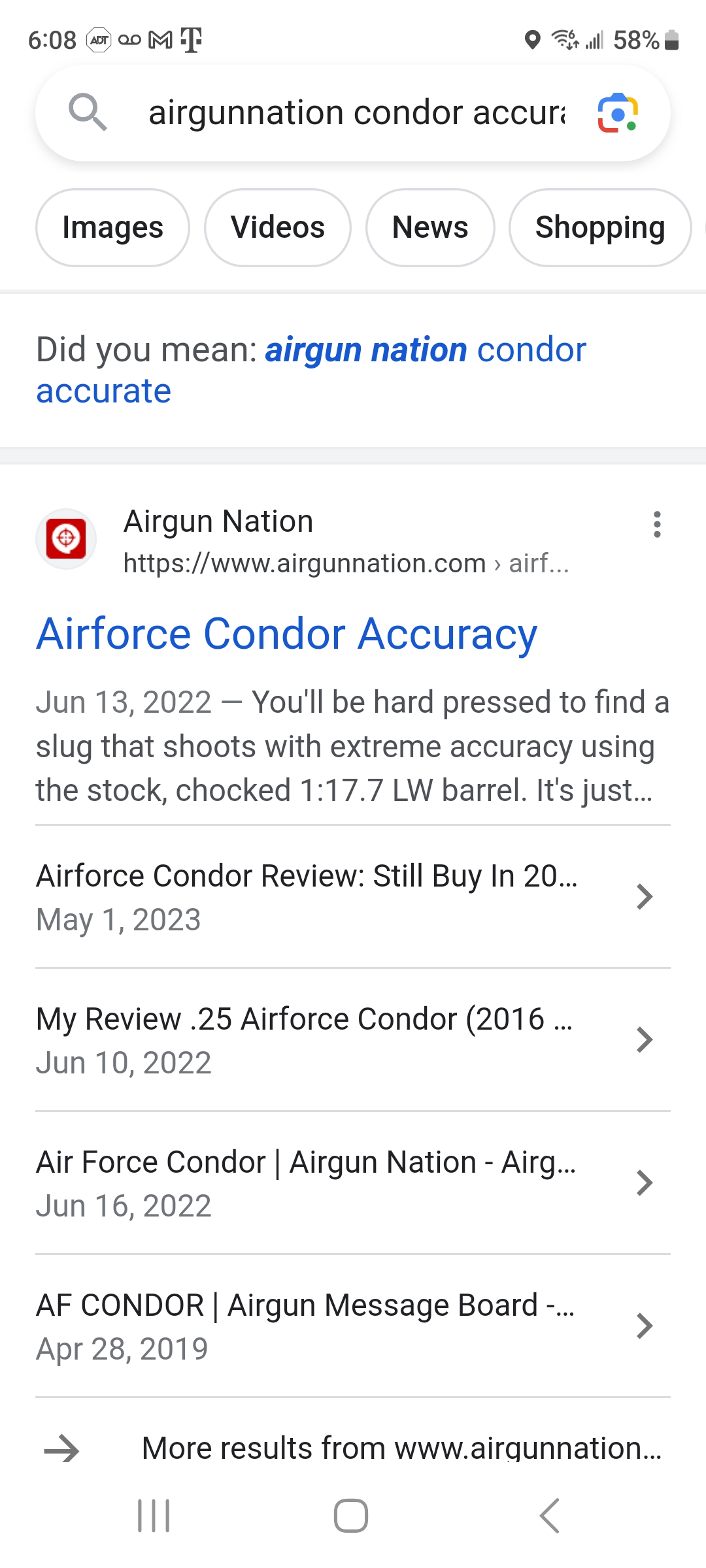

Gos, try this: Google airgunnation condor accuracy and this popped up. Try same for both guns. Tons of info

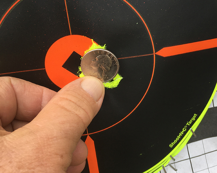

I was a bit surprised at how accurate it was at 35 yards so I pushed it out to 50 and then 85 yards.View attachment 370519
Three shots at 85 yards.
Can you do a 10 shot group with it?
