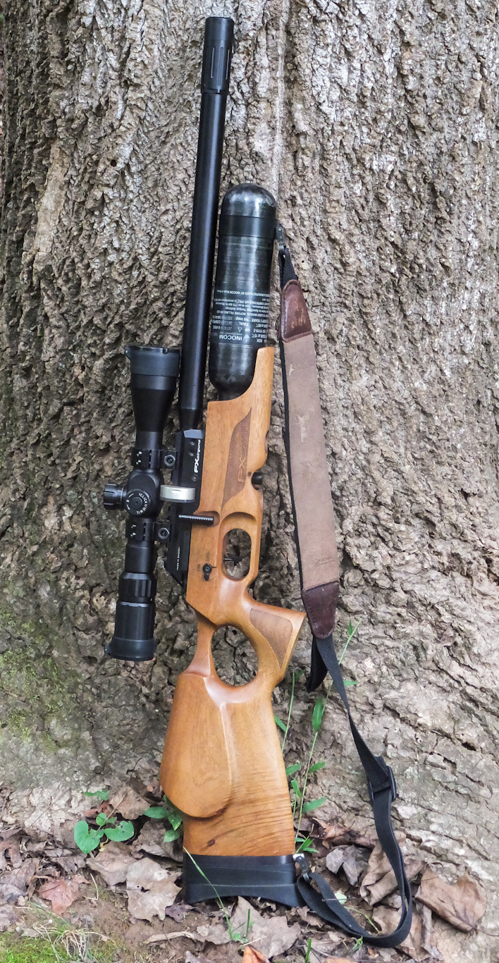

The hype is real. As long as you get a good one, anyhow. Mine was made before they started getting massive amounts of orders. Overall fit and finish of it is supurb. Handling, performance, balance, accuracy.... supurb. This one is a short barreled MK1 continuum, .22. Usually hunt with it shooting 16gr AA domes, or 16gr hades @960fps. Only ever taken headshots on greys, all DRT. One shot, one and done. Out to 70 yards. I've had it shooting 1/2 moa or better @100 yards with 36gr .218 BT slugs out of the 700mm barrel @65fpe. But the extra power, and length are just a bit over the top for me. Much prefer the shorter barrel. And the lighter pellets do the job just the same. Usually I'm taking shots around 25-45 yards. So, high power, and slugs are actually overkill in my case. In fact, %95 of the time, I have this gun turned all the way down to 16fpe. Only when I go hunting does it really get turned all the way up.
