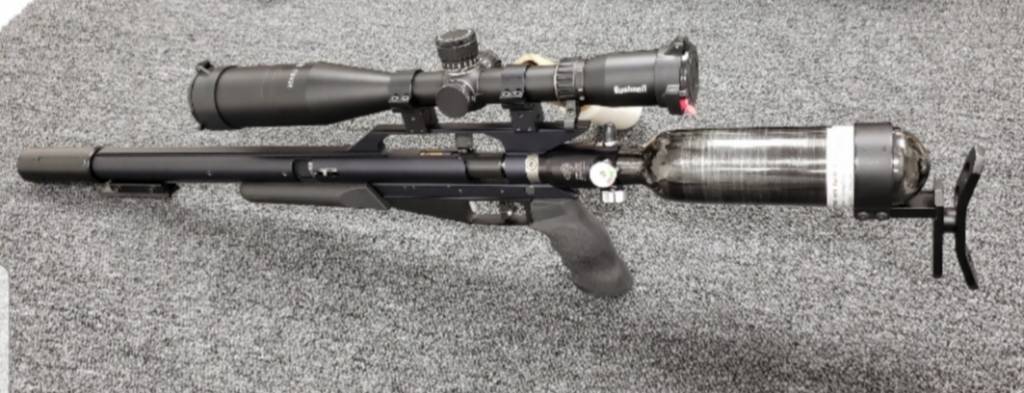

This was my .22 short before I converted to .224 long v3 pretty consistent reg you will need 350cc bottle to have the same lop.. as the factory bottle.
