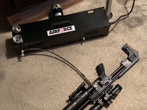

I also received an E-pump from Pyramid Air. Fit and finish is excellent. I just filled my Talon ss factory tank 490 cc, it took 1 hour give or take a few minutes from 0 to 3000psi. Very quiet and when it finished there was no noticeable heat any where on the case of the pump, the motor was a little warm. When i opened the bleed valve no noticeable moisture. So far VERY happy.

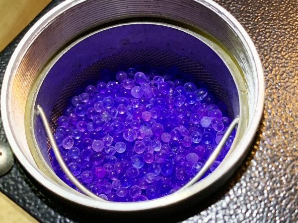

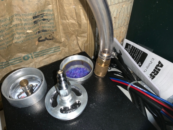

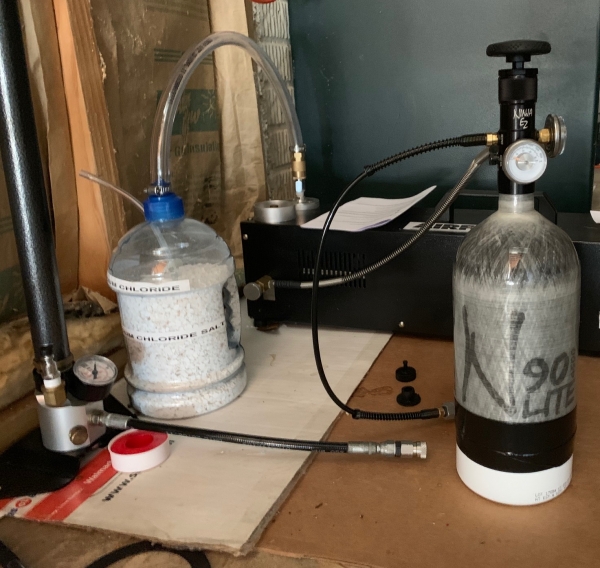

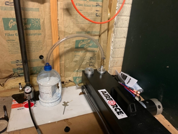

There is a large moisture ball in the bottom of the calcium chloride pre-filter desiccant slightly larger than the size of a golf ball. The size is slighter larger than what has been observed with 15 or so hand pumping sessions using the same filter attached to the Hill MK3.

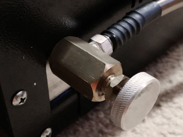

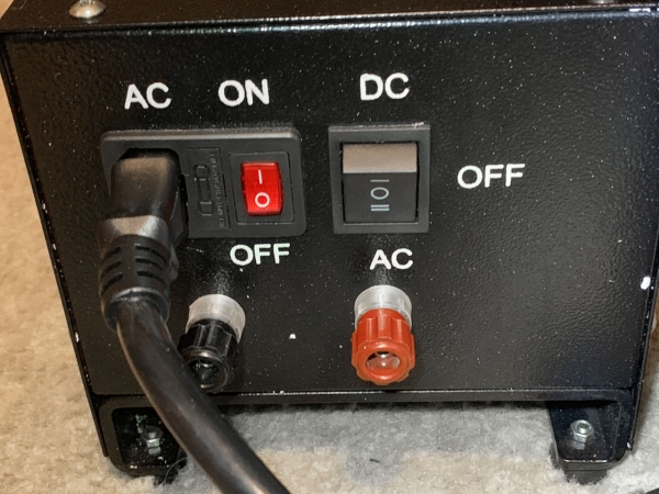

I think I've found a good setup combination -- 7 fills from the Ninja 90cu-in with EZ valve into the Gamo Urban. The ePump is now connected to a 12VDC deep cycle that is charged via a solar panel. Fill time for the bottle from 3100 PSI to 4500 PSI was exactly 1 hour and 15 minutes. Keeping the shaft lubricated seems to be the most important thing with the ePump and my tub of silicone grease showed up. The DC side is operated via the singular DC/OFF/AC selector switch. The AC side has a dedicated On/Off in addition to the DC/OFF/AC selector switch. Pump seemed to operate better on 12VDC than through the AC/DC conversion through the PSU.

Bleed the system at 30 minutes, again at 60 minutes, and a final bleed once done pumping. Nothing but moisture vapor out the bleed screw and no standing water. Pumping a bottle from 0 to 4500 PSI is a large task but forward-going this should be easy.

I did learn from the solar battery setup that around 12-11.8V on the battery at 4300 PSI the pump action can stall. Make sure you have plenty of amperage/voltage if pumping from battery. Indicators will be arrhythmic pumping at increased pressure and stall on completion on the pump down-stroke. I flipped over to AC and finished the bottle fill. I'm not sure if this would cause relay burn-out or motor burn-out due to lack of cycling action.

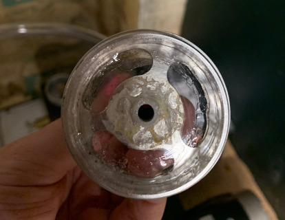

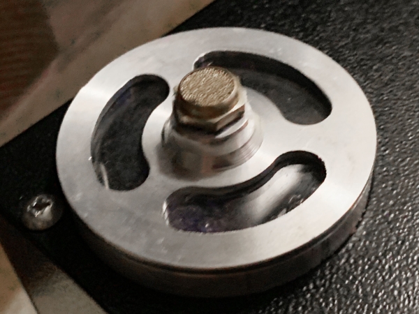

@ LMNOP. Thank you for your comments. I thought I’d like to share all the thoughts that led to the modifications I made to the pump. Maybe it helps some folks keep their pumps running. I was close to wrecking the pump before really using it. The first time I switched it on it failed. I removed the case to see that almost all! the screws weren’t tightened properly. This led to the sensors reversing the direction of the motor being loose. After fixing that and having the pump operating I noticed - as many others - that the motor was overheating. I already got a bag for the pump so the bag got an integrated fan which really works well. I use the motor’s 24V current to run the fan. Then I noticed the same frame twist you mentioned, especially when coming close to 4500 psi. Anybody can imagine that sooner or later this results in device failure - I just wonder how this slipped out of the attention of airforce. So the next thing I did was to screw a 12 mm aluminum plate to the base. Twisting is reduced to a minimum now. One last thing I changed was to remove the cage with the desiccant and fit in a cartridge with o-rings that prevents the air from just passing beside the side of the cage. This makes a big difference when opening the bleed screw. I think the idea behind the e-pump is great, but airforce could have done better. A lot better. It looks more like a prototype that went straight into production without testing. I just don’t understand why a company with quality products pushes a product into sales that has so many flaws. One last thing: I also use divers silicone grease.
Bendminx, I'm honestly at a loss for words at how impressive the changes you've made are. Exceptional engineering and fixing of flaws. I bet your E-Pump will last as I cannot think of anything from my negative experiences that you've not addressed and solved.

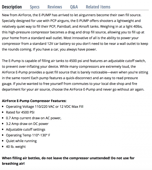

Anyone tried the cigarette lighter outlet yet?
I think there is a typo on the pump, it's 32amps max. not 3.2.
Look at the size of the mains to 12DV converter that's not a 3.2amp one like a wall wart, thats a 35Amp one.
I suspect the motor to be in the 350-400Watt range and that reflects on the fill times.
12V x 3.2A = 38.4Watt thats akin to a ceiling fan not a powerfull 4500psi compressor.
In all expect the compressor to be connected directly to the battery to avoid frying car electrics!
Keep up the good work.

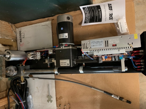

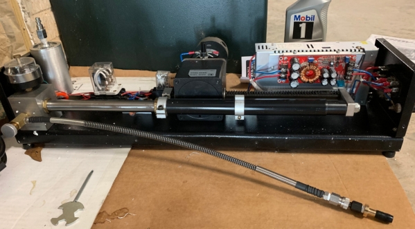

Here's an image of the "guts" from some photos I had when I owned it:
As you can see above at increased pressure, which translates to increased resistence, which translates to increased force because the pump is offset to the gearbox (IE: not a wormdrive) it results in excessive lateral force expressed across the frame. Because there is no crossbar/crossmember the frame twist offsets the position of the pump and gear rod. Eventually it tears the guide collar off and then all hell breaks (and brakes, lol) loose.
