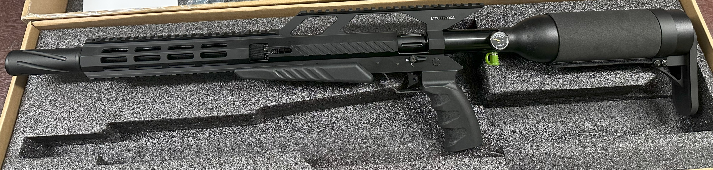

Upon opening, this is what I was met with...everything seemed secure and well packed.
Removed the gun from it's wrapper
First thoughts. It feels nice. I cant help but get the feeling of 'cheap', but that may be bias. I had a 'Pinty' scope and it was useless. Still for $250 shipped (thereabouts), it looks good and uses a Huben regulator. Upon filling the gun for a leak check, I saw the reg was set at 14MPA according to the gauge. The pressure gauge was as close as any compared to the large gauge on my fill tank. There was a copious amount of silicon grease on internals so will need to clean some of that off. I heard no obvious leaking when filling the gun, but the test will be overnight. I like the frame design better than the AF guns. The skeletonized look and the pic rails are a welcome addition. The buttpad is actually padded and feels nice.

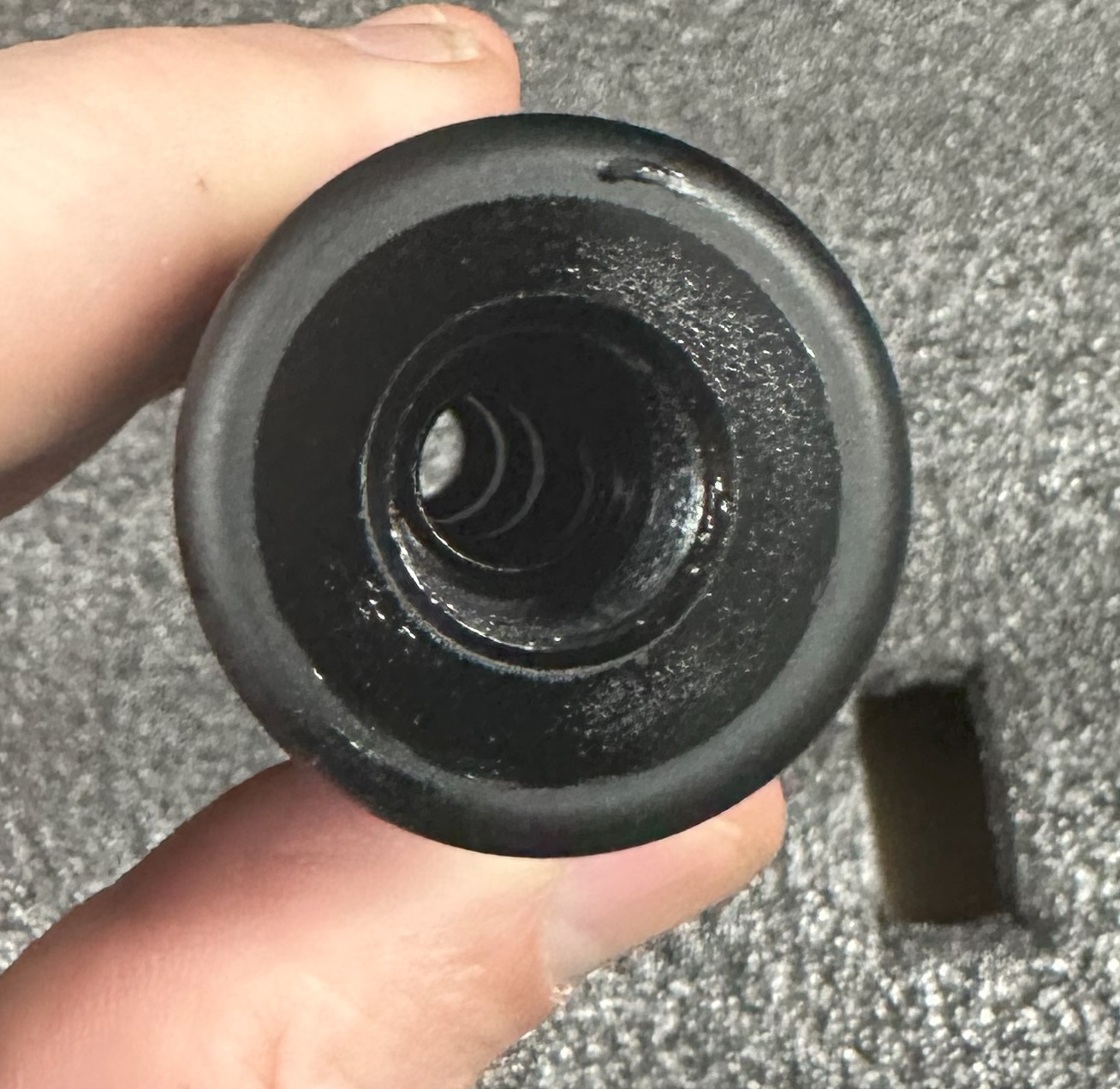

The moderator is proprietary. I don't know what threads it uses, but a DonnyFL wont fit it. The moderator is removable and is baffled, but quite small.

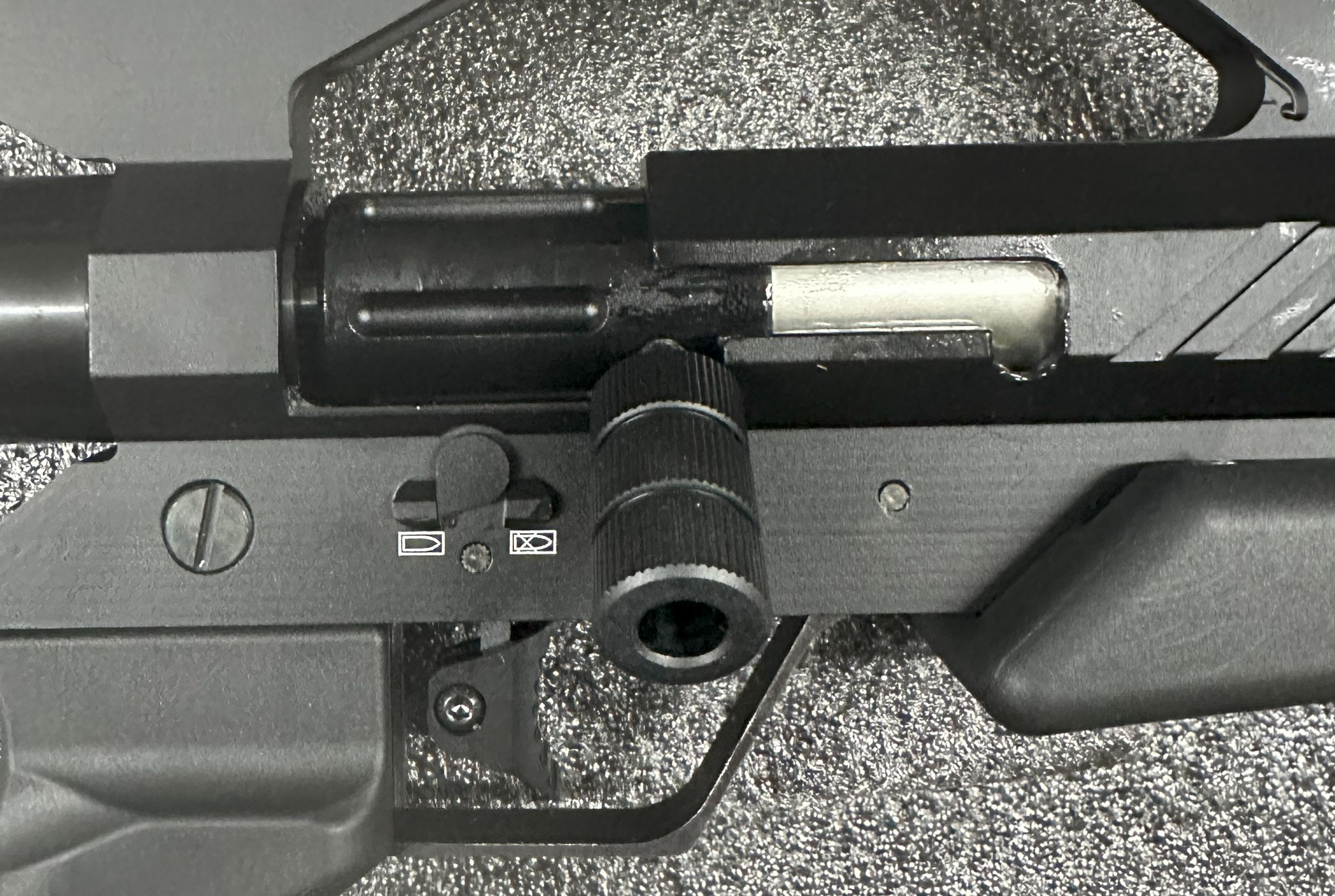

I really like the bolt on this opposed to the arrangement used by AirForce. At the time of pics, I'd not cleaned grease.

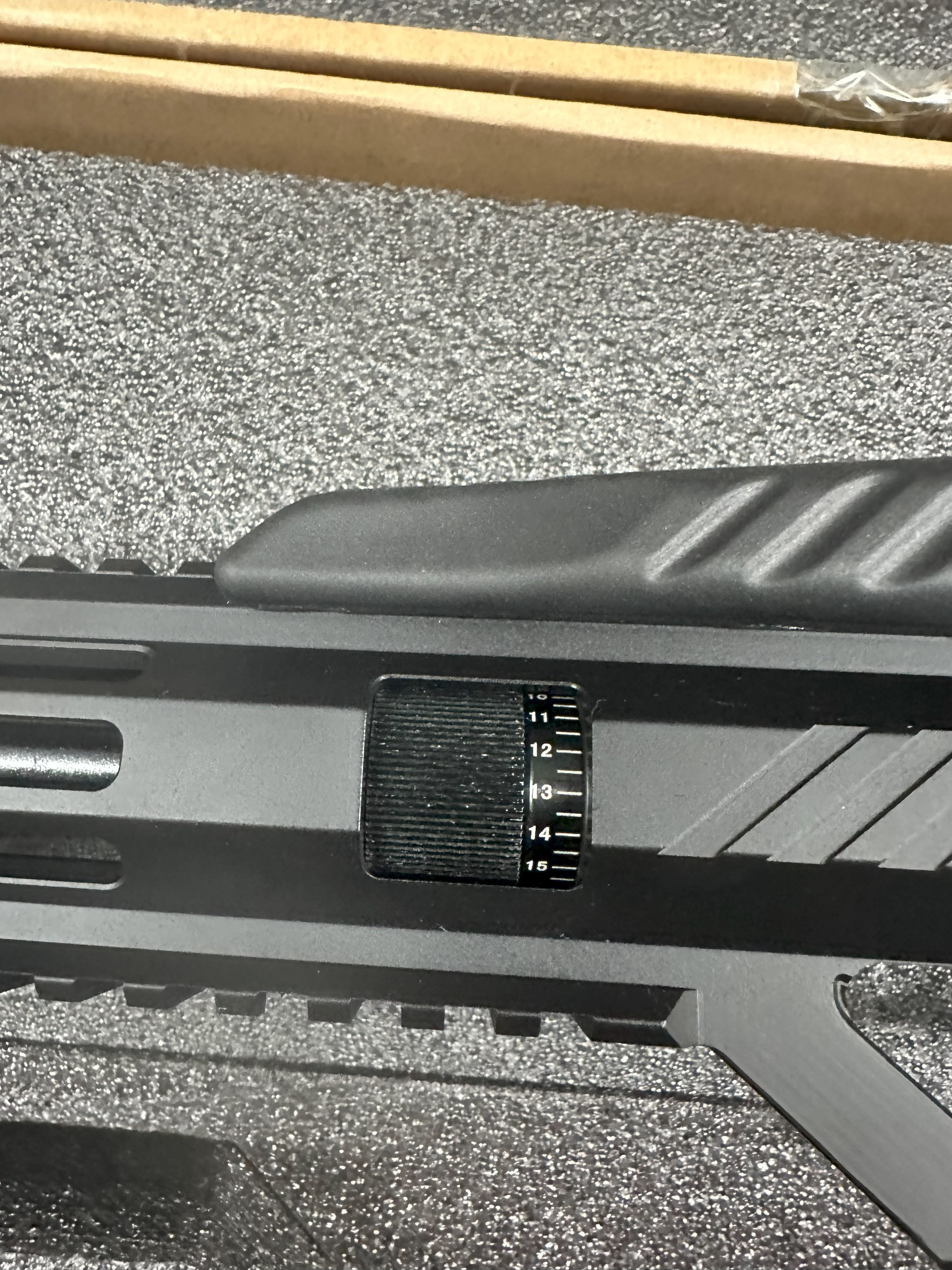

The power wheel has no numbers or indicators other than the screw and hashes
But it is cut out on the other side of the frame so you can more easily turn it and see from the other side, a welcome departure from the AF frame.

The short moderator didn't do a lot, at least on power level 3, according to the hash marks. It wasn't overly loud, but I imagine a lot of folks will want to put a real moderator on it. It doesn't bother me and I like the look of it so may keep it as is.

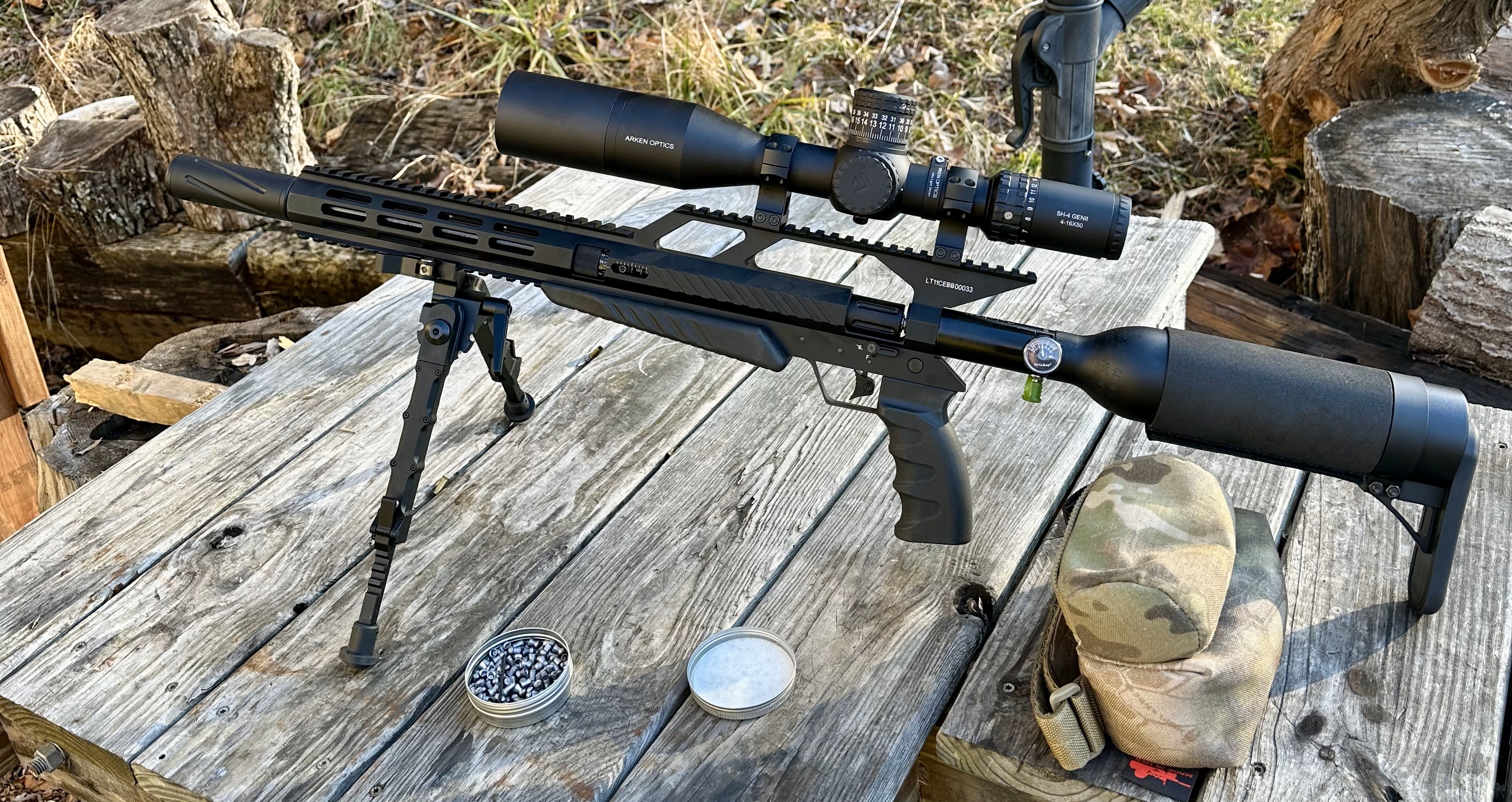

It sounded like it was putting out decent power, but will verify later. I'll mount a scope on it and do some chrony testing and shoot some groups and see how goes when it warms up just a little more outside!
I'd sold off all my cheaper scopes at the Hickory show a couple years ago and so I'll be putting an Arken on this gun for testing. Either the Arken will make this gun better, or the gun will end up making the Arken worse... I'm not sure yet.

Now that I was out in the open and shooting (and realizing the velocity it was putting out), I have a bit different opinion on the moderator. Considering its size, I think it did ok. I had assumed when shooting before that the gun was maybe shooting in the 750fps range and judged the moderator accordingly. It's still not quiet as a DonnyFL, but it's adequate, I think.
