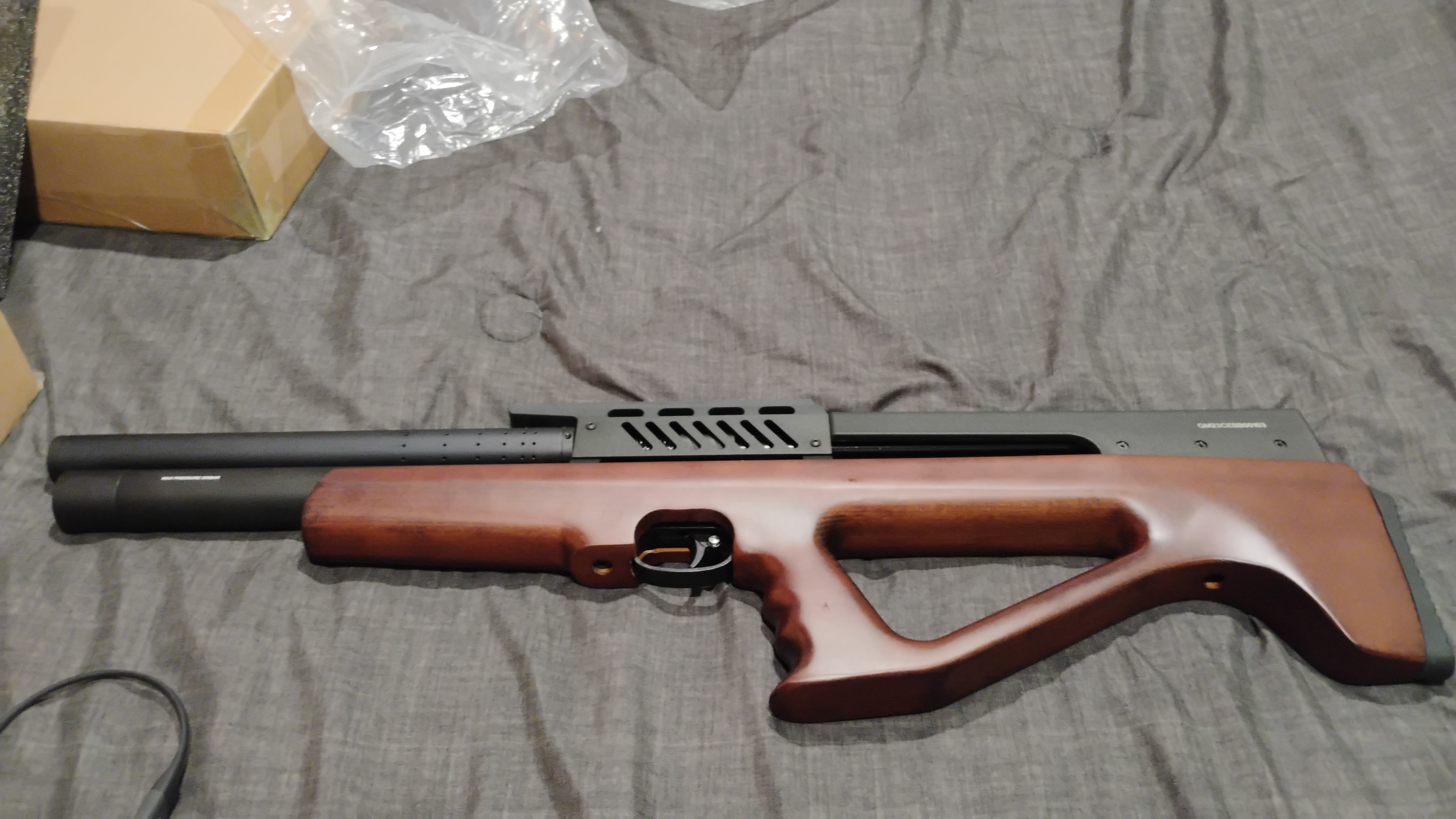

I got my bullpup yesterday.
Unfortunately it is leaking about 50 bars in 10-12 hours.
I only shot to test velocity and got 3 shots at the same 899FPS with CPHP.
The bullpup feels nice, very light and metal and wood all around.
Feels great in hand.
I will get a replacement, since I would rather not spend many hours chasing leaks on a new air gun.

Just scoped the bullpup and enjoyed shooting 4 mags. The gun seems accurate enough with such a short test, and the trigger is good as well, guessing under 2 pounds. I'm so far very happy with it, especially for the low cost. Charles
