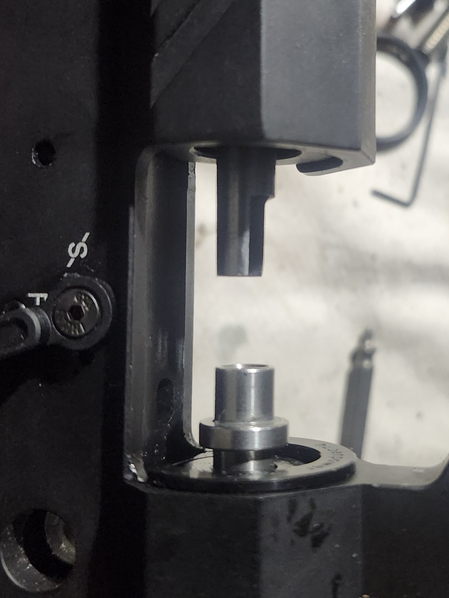

Update... Had a forum member send me a 70g hammer from Trajectron to try out in this and meanwhile @thammer reworked my sear. We all know that the magic he does with the stock bits allows for around a 2lb trigger pull, but how about a .68lb trigger pull?
Yep... paired that sear with the Trajectron hammer and tested and felt really light. Used my trigger pull scale and gave it a few tries and three pulls averaged to .68, just over half a pound. Very crisp.
I beat and banged the sides, back and all over trying to get a misfire and couldnt get it to misfire at all. The Trajectron hammer is slightly longer than stock so does add a little preload to the spring so may need to back off the hammer spring a bit, but a quick check on the chrony only showed a marginal increase in power, still under 900fps with JSB 18gr and so all good.

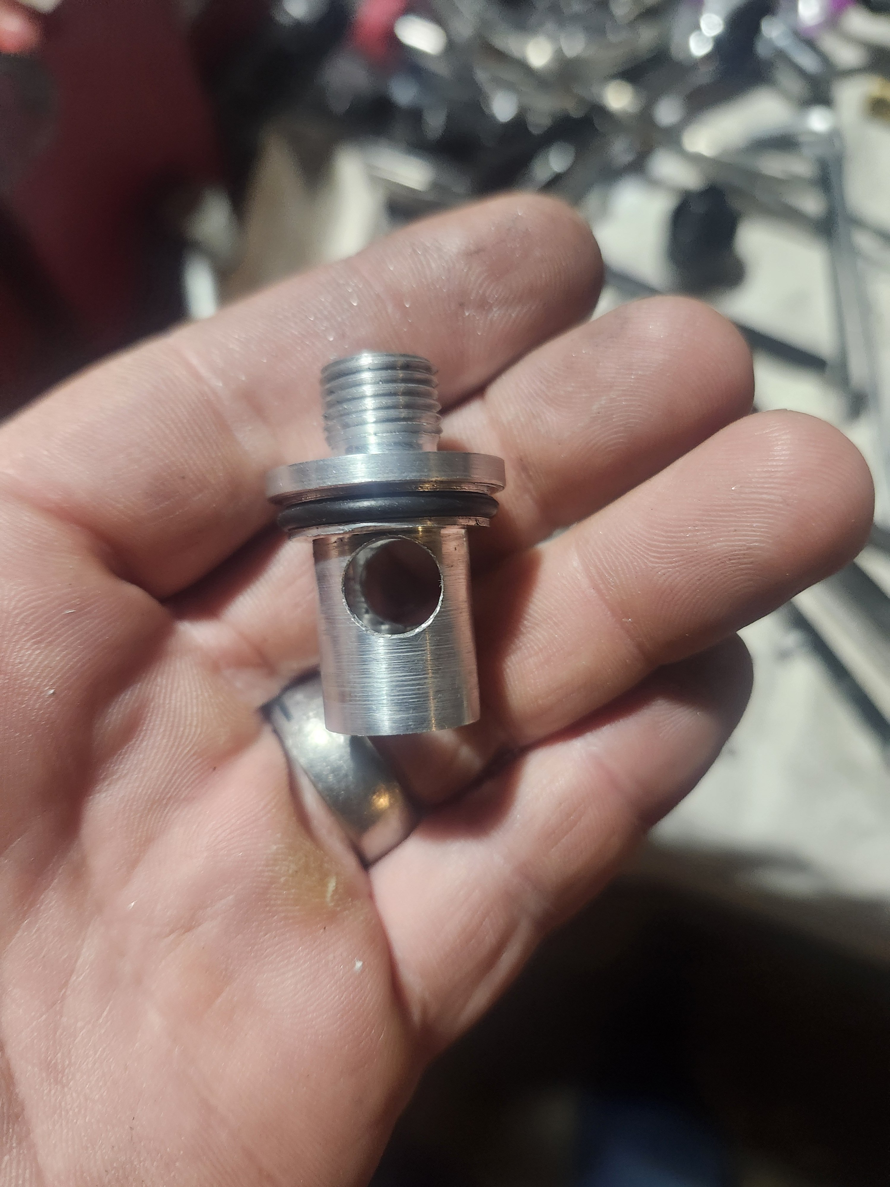

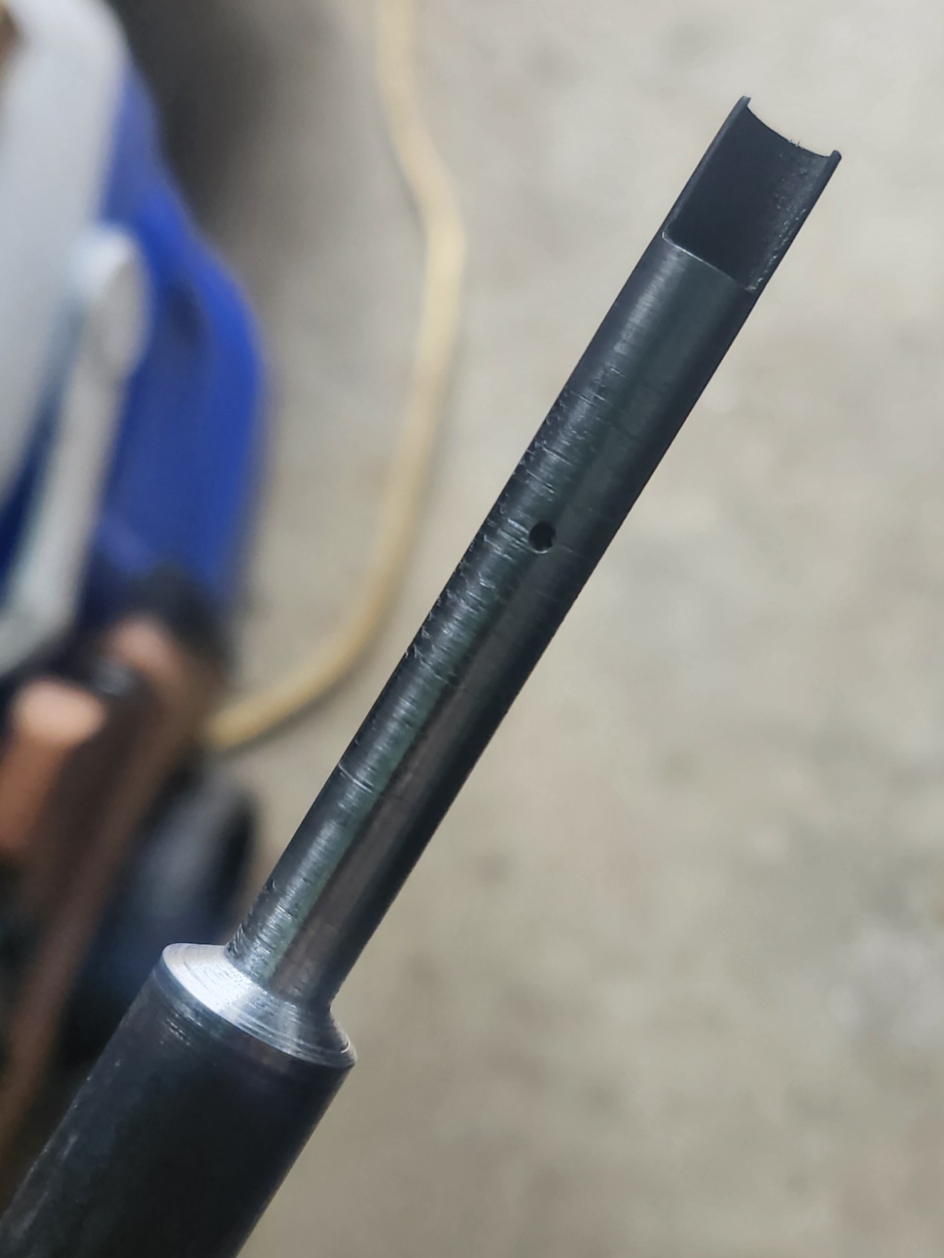

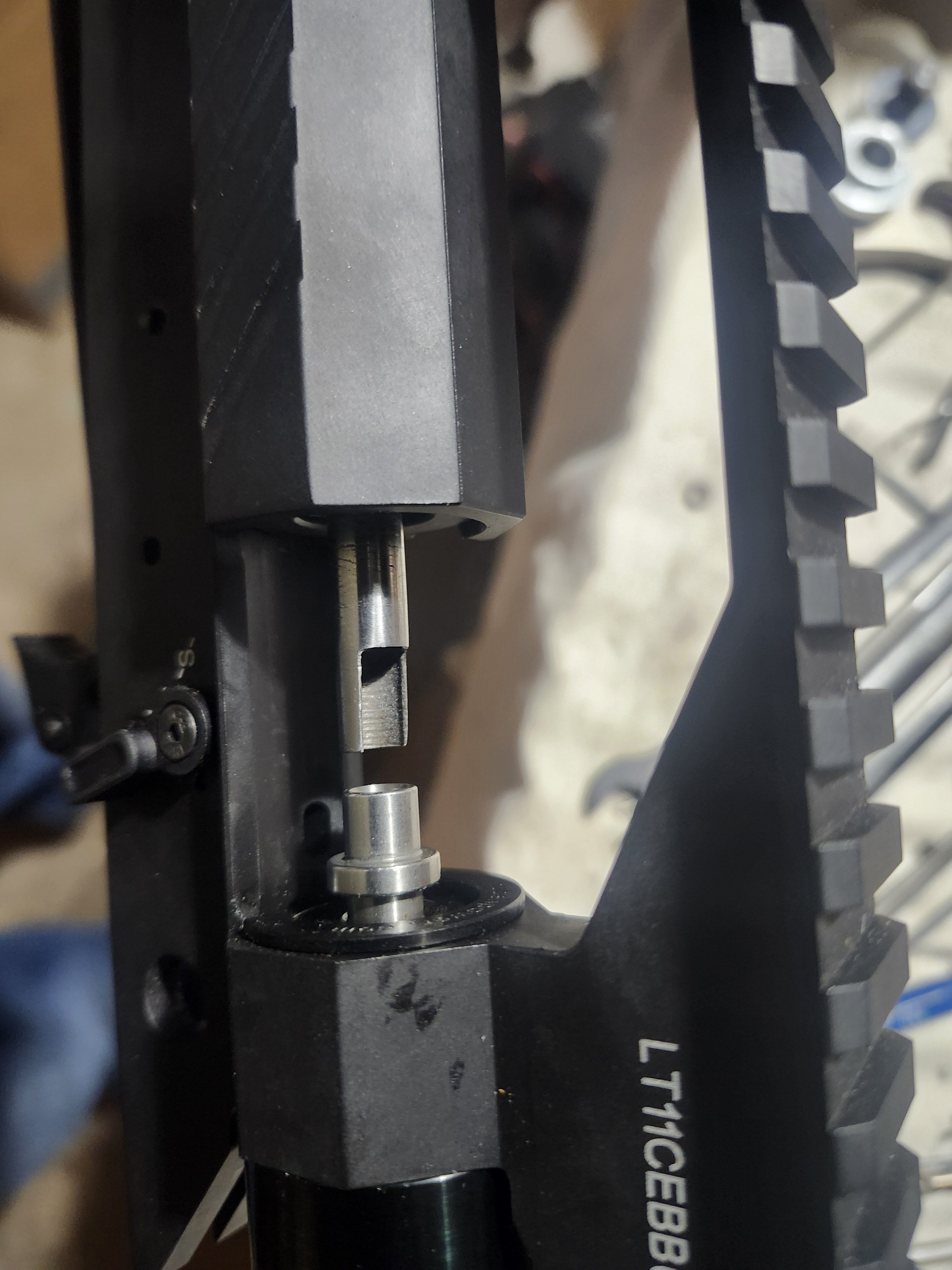

Had a QB style barrel lying around that was really accurate. Also has a loading tray precut. A B¡tch to turn with no rear support but works. No slop in the cocking. Lots of sandpaper used in this and still ugly but I can put the barrel closer to the tophat for more power. Also ported the valve slightly larger for a faster blast of air.

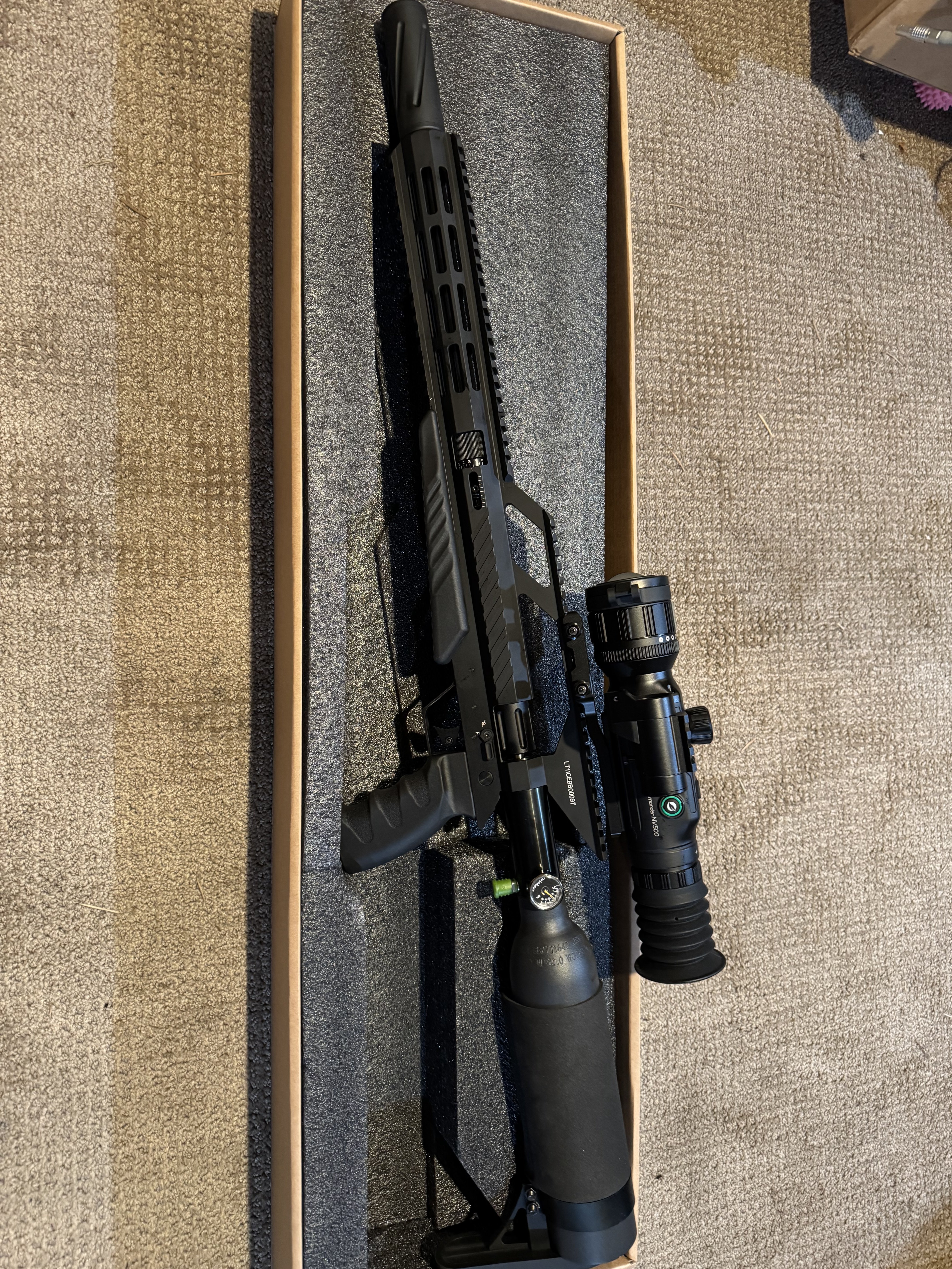

Hooray! Sooner rather than later! Of course still shipped with bolt handle in place. This one is in fine shape. The bolt handle had chewed up the box, but did not chew through all the way. I got my Oneleaf mounted up and fired a round or two for function. So far so good. I'll go back down and zero it and shoot a bit and take a couple pics, it's a 250 dollar rifle with a 750 dollar optic. It does seem to make a GREAT combo, the weight is quite reasonable and the optic height is just right on it's Std. mount. Plenty of choice for the UV flashlight too. Should be good for head shots on the water rats, if not I'll put it back on the Blitz. Pics soon.

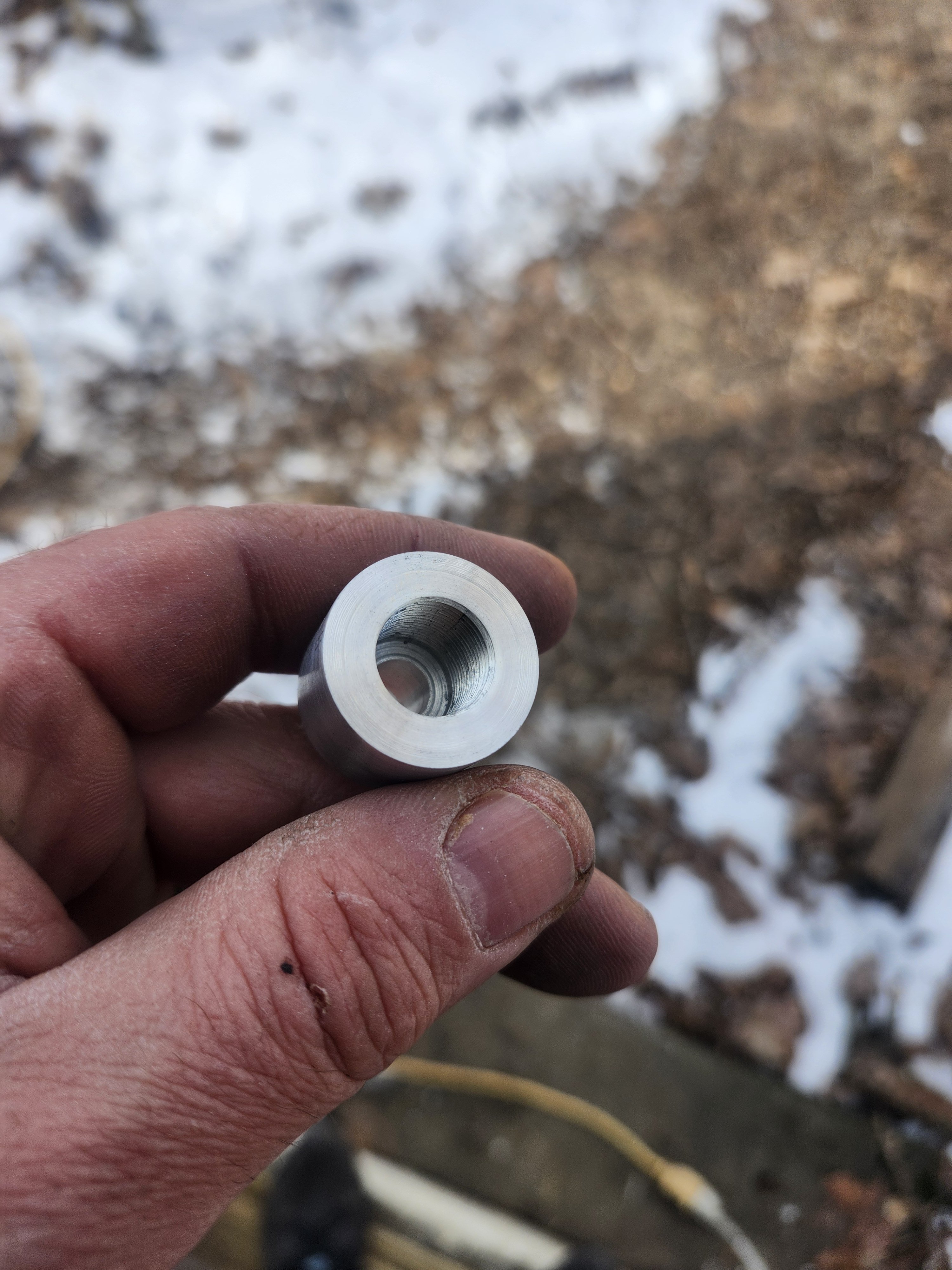

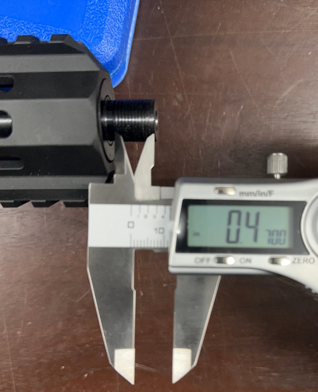

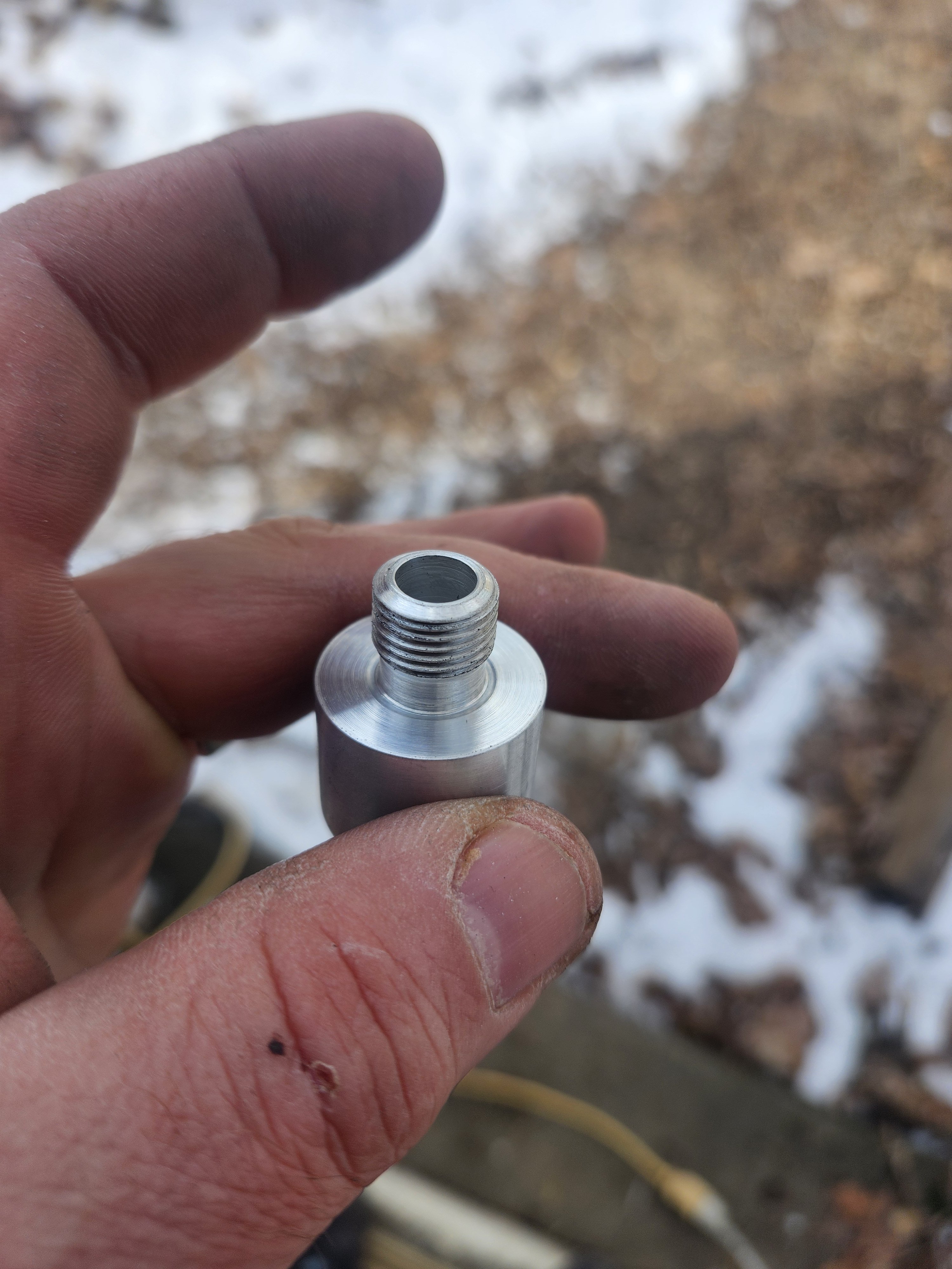

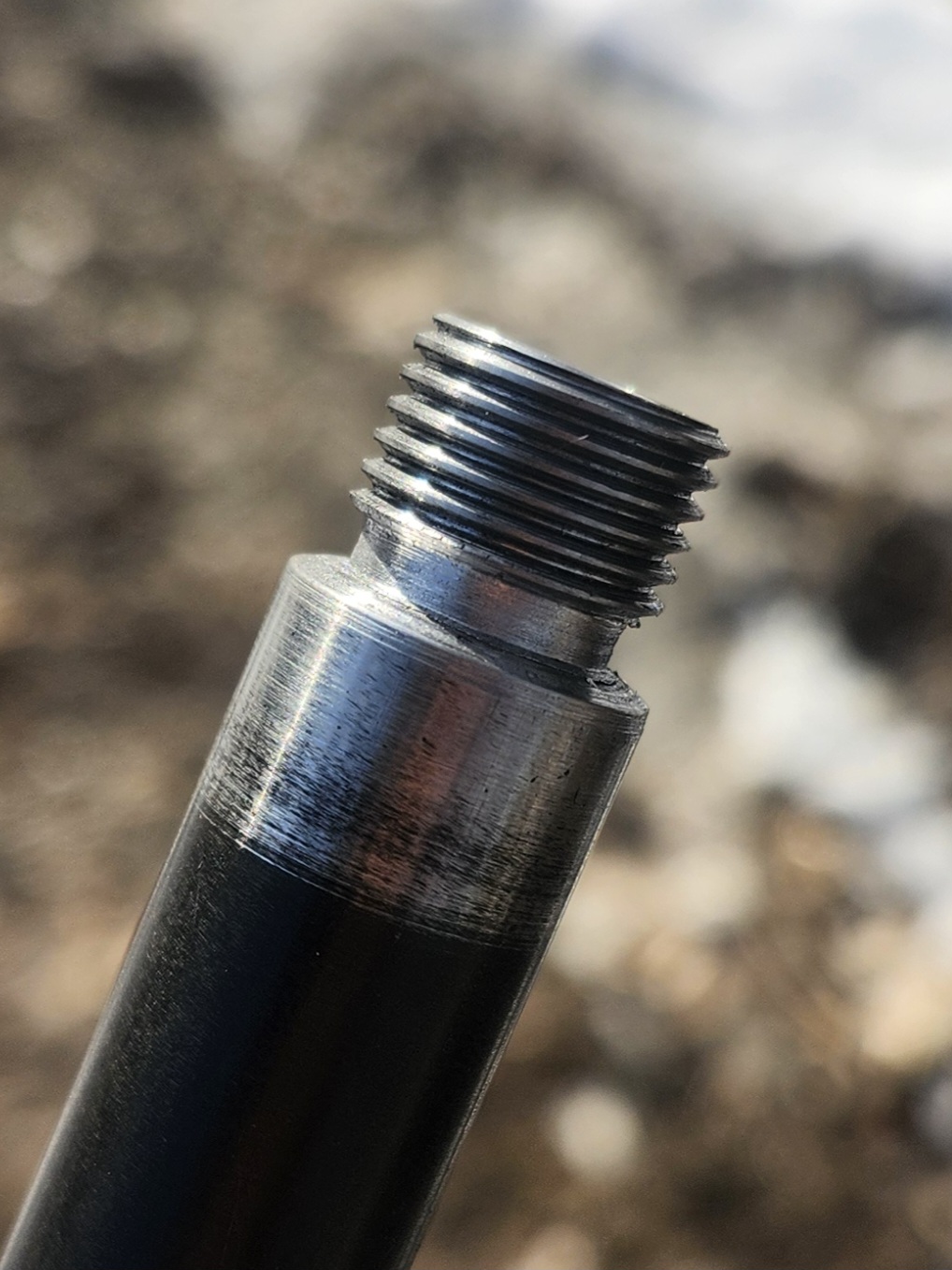

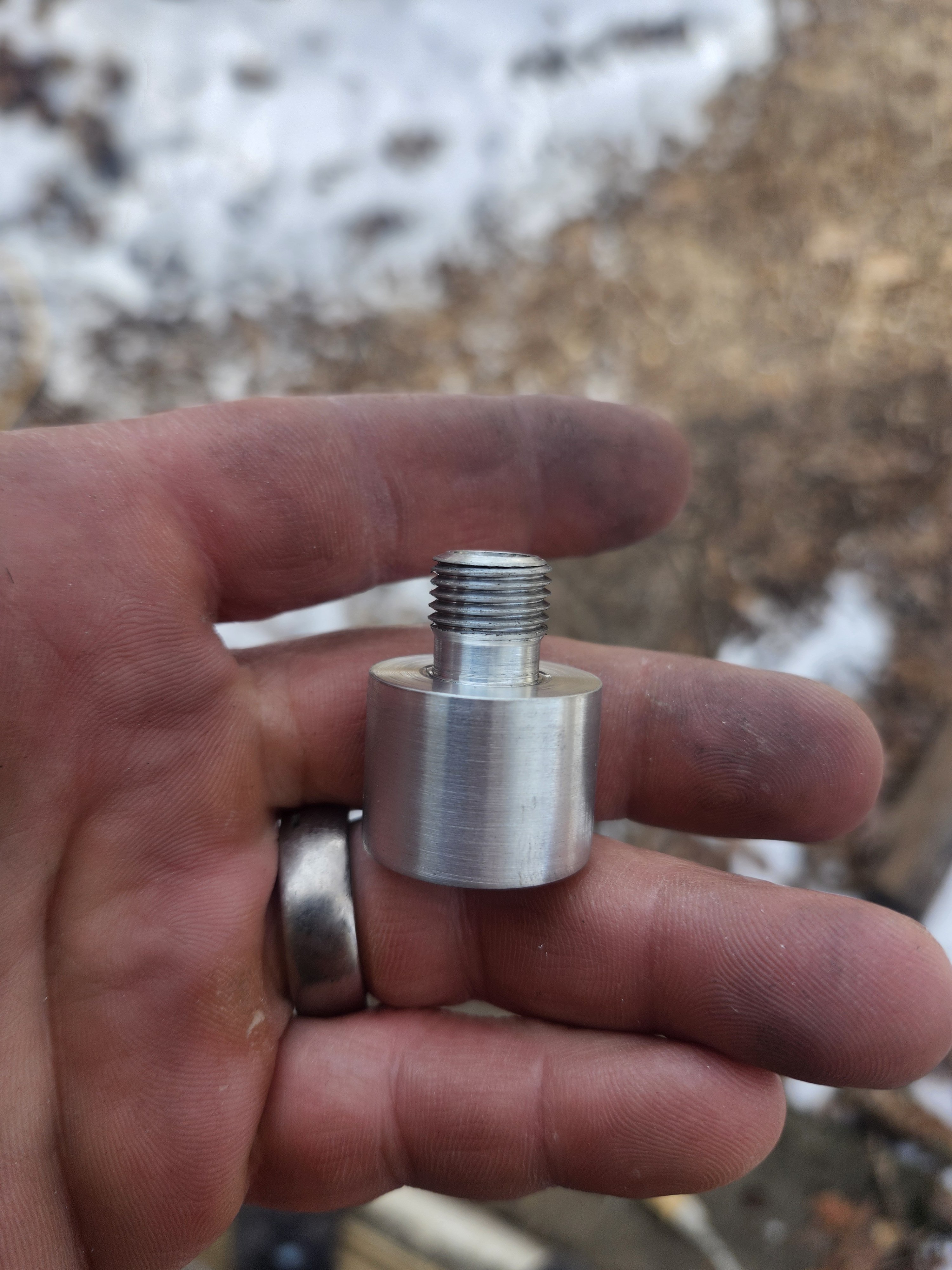

I've already turned the 14mm Threaded section on my factory barrel to 1/2x20. If someone can get me an accurate measurement of the thread length on the factory barrel I'll make up a batch of adaptors to allow 1/2x20 mods to attach to the factory barrels for anyone interested. Probably $25 each and will be blued.
