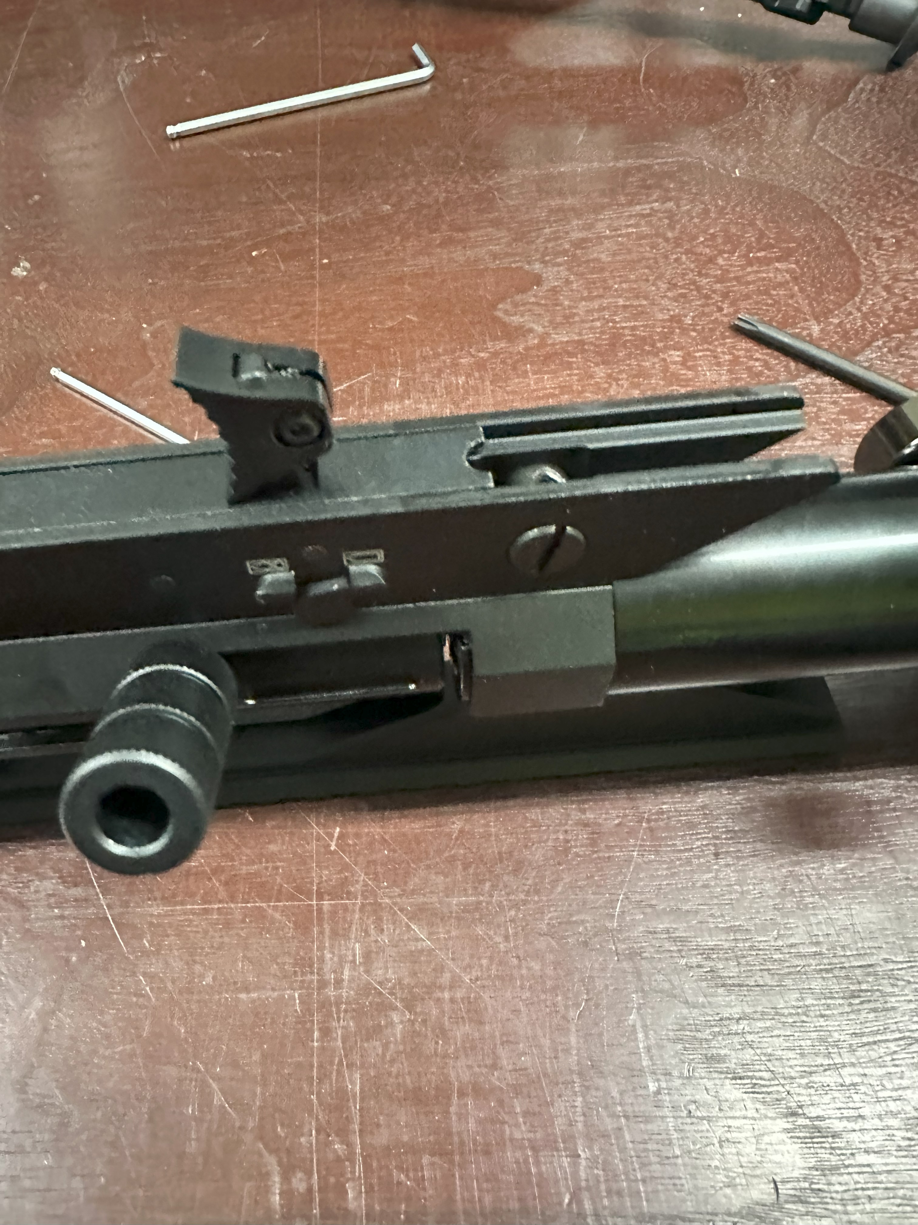

1000Pcs Mixed Multi-size Mini Spring Parts AccessoriesA little look under the hood, but not diving in deep.

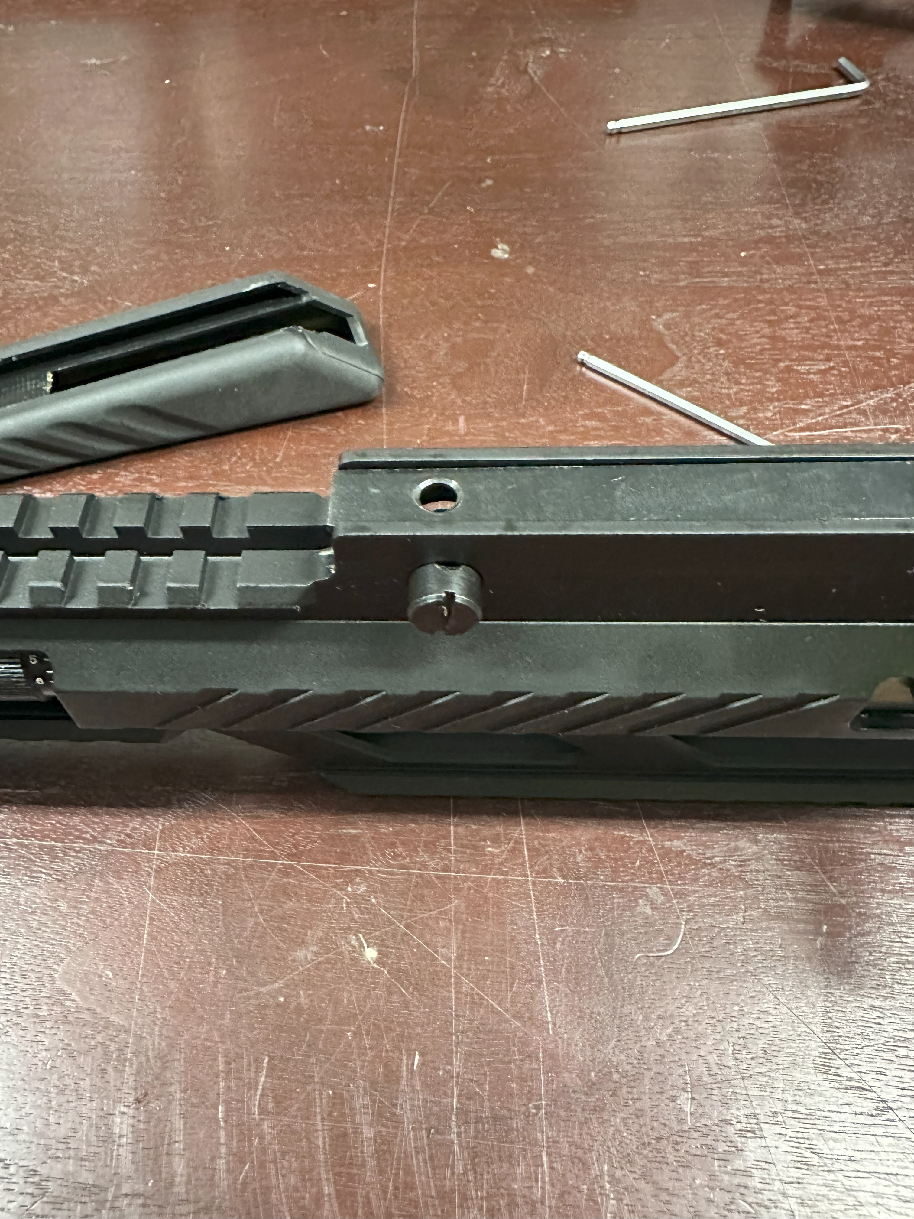

The grip is attached via the same annoying method with the pin that is a pain to line up as the AF guns..
as is the forearm, which really is a pain because it doesnt slip off, you must slip it down the length of the pic rail to remove it

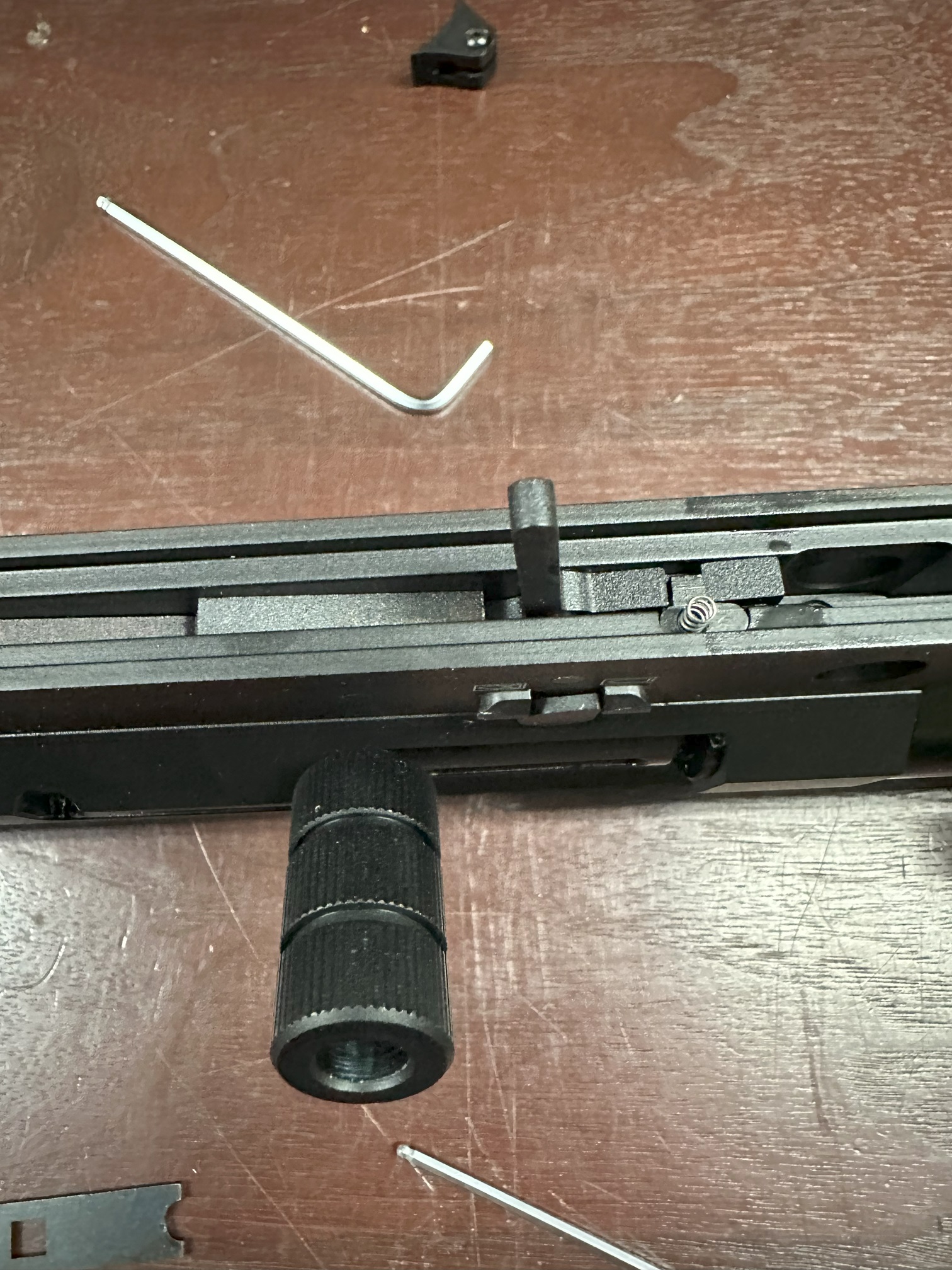

I didnt disassemble the trigger group just yet. I was able to access one of the trigger group springs and could see part of another. They looked the same. I tried to find one around here similar but lighter, and tore apart several pens to no avail. Until I can find appropriate springs, I dont see a need to tear down further. Note, the visible spring in this pic is not one I'll replace. The one I mentioned is under the back part of the sear.
I'm not certain how springs are measured, but these are the measurements I came up with and will look around. Assume McMaster Carr will have them.
Width... .1580
Length... .5385
Wire... .0170
Also of note, the rifle held air overnight. Neither the pressure gauge, nor the regulator pressure moved an ounce.

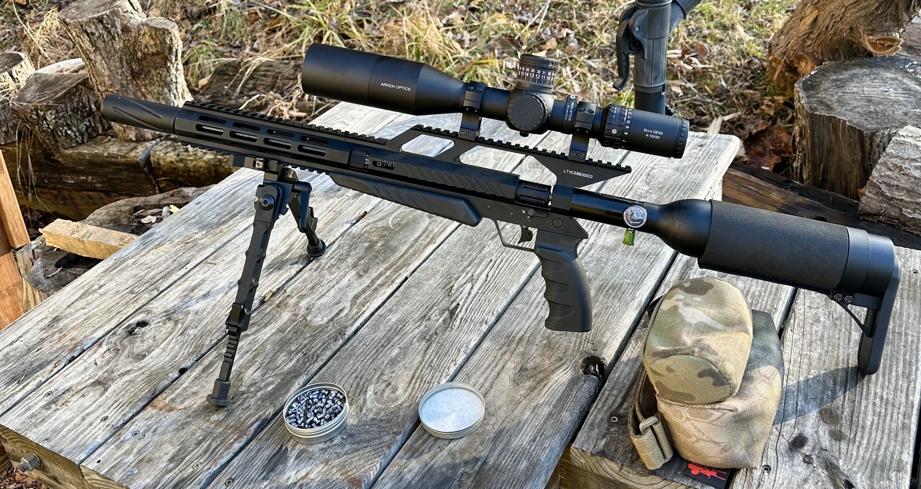

So I finished up my other project, at least as much as I'm going to today, and decided to throw a little more lead downrange.
Did a few other groups, but just mainly plinked at steel from 20-65 yards out. I didnt walk up to measure, but it looked like I was around 2 inch groups at 65 yards. That trigger makes accurate shooting difficult.

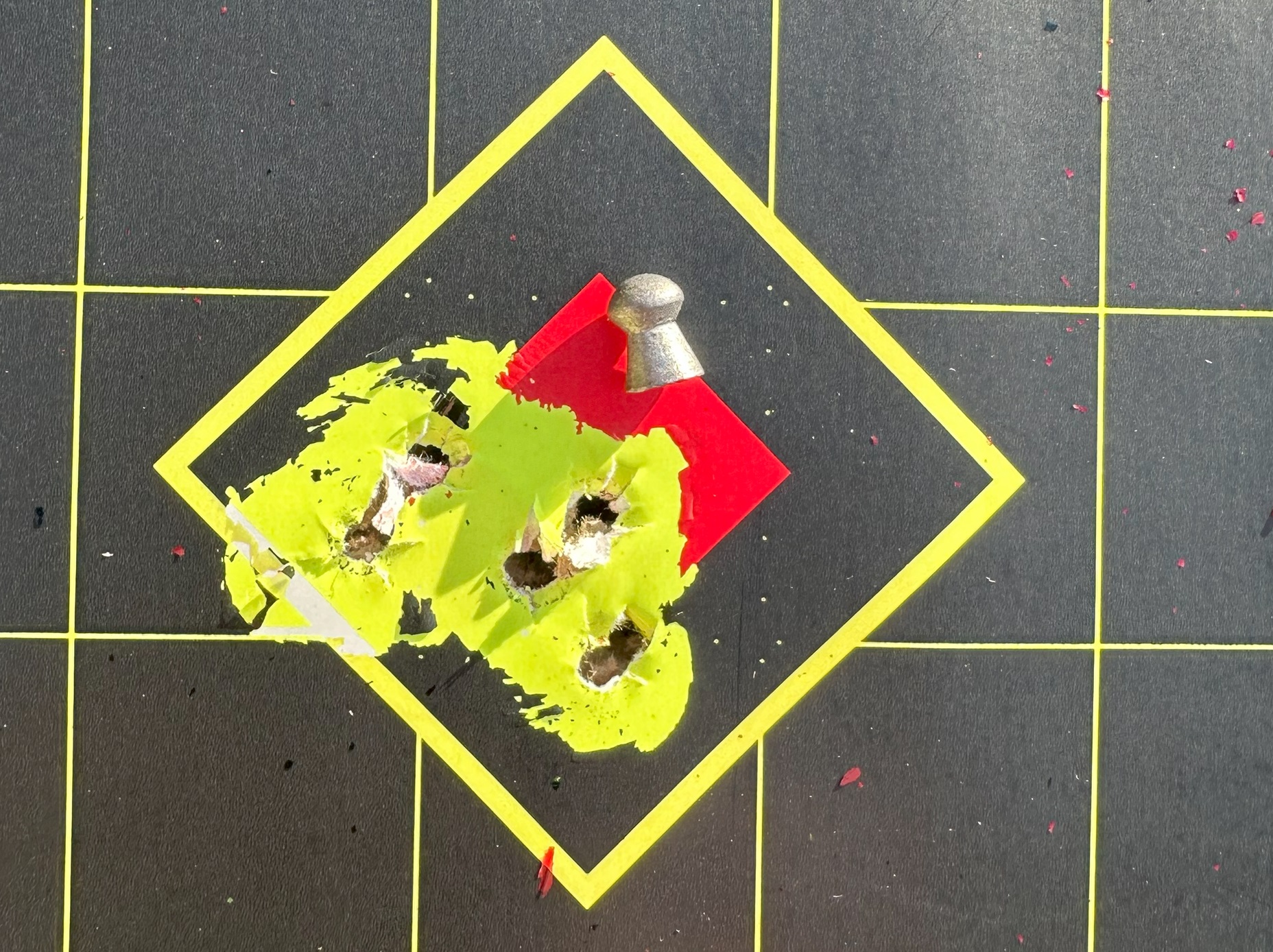

Did a few more groups at 48 yards. Had thought I was set up at 45, but rangefinder told me differently. Next time I'm motivated to do so, I'll move it to an even 50.
This is representative of what this gun will do with the trigger as is. I did a couple better and a few worse so selected what looked to be an 'average'. You really have to concentrate on that trigger pull. I guess next rainy or cold day, I need to look under the hood and see if I can easily lighten this trigger. I'm sure others will beat me to it if their triggers are the same.
